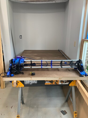

simple platform table top frame made out of 1x3" , faced with hardboard front and back. Then additional 3/4" MDF rails to screw the clamps and tensioners into, and 3/4" spoilboards. designed it to rest on top of a coouple sawhorses and 2x4, will be light enough to break down and store. I need it off my outfeed table, lol
V2 will be a fold up table, once plywood costs come down a bit (or i may use laminated sheathing ply for the table fold up frame

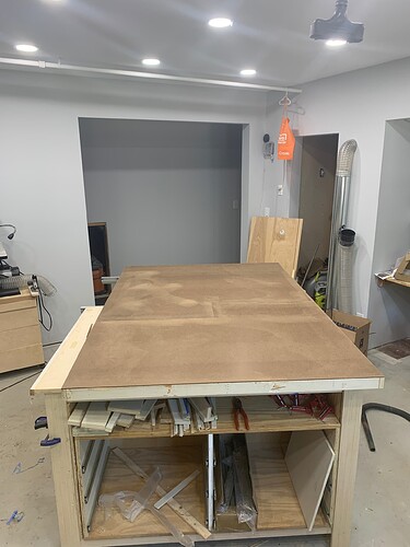

My wife did put me to work drawing out some 3’x2’ posters on foamboard for a project-my outfeed is not flat, lol. some dips made the pen lose contact. im fixing that with a new outfeed top- double laminated 3/4’ mdf finished with formica

Just spent a good portion of the past two days building a frame out of 3” rips of 3/4” plywood, with the intention of adding 1/8” hardboard skins, 3/4” mdf spoilboard on top
Had to do some extra supports, and use odd shaped cuts in the skins because it’s 51” wide, 75” long. I didn’t like the thought of a single seam across the entire width, so I staggered it a bit hoping to offset any inconsistencies
I should have just cut my lr3 tune down 3” to make it for the 48” sheets goods. I probably won’t ever miss the extra 3”
Target fixation on the table top, and should have looked for a different solution
Too late now. I’ve cut and glued the frame and one of the 4 boards.

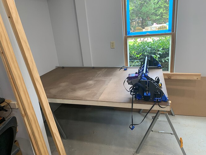

Got some time to finish the table top- almost- its a frame of 2" wide 3/4" plywood i repurposed from an old french cleat wall i pulled down when we moved. skinned on one side with hardboard, and dumped on top of a base consisting of a couple sawhorses and 2x4s.
Plan was originally have it easily broken down so i can pack it into the corner, but it doesnt feel as intrusive as i anticipated, so its possible itll stay out most of the time. Its also a bit more awkward to move than I hoped, with the width, so i think ill get to V2, fold up table quicker than i thought
Next- 6" wide, 75" long strips of 3/4" MDF will make up a couple pads ill run up the sides in the direction of the Y axis, to raise the height of the pipe rail and the belts to the same height as a couple 42" x 36" 3/4" mdf spoil boards. this way, i dont lose cutting height due to the thick spoilboard. im considering adding some hardboard under the spoilboard to raise it 1/8th" to give me some surfacing depth, and still end up flush with the pads
i haven’t sheathed the underside, as i still have to glue in some blocks ill use to attach the spoilboards with threaded inserts and bolts. then i have to cut some holes that will take 1" long 3/4" PVC pieces ill use in conjunction with wedges for work holding

That’ll be a project for next week. This weekend, I’m building drawers into my outfeed table to hide the junk that used to be in that corner
