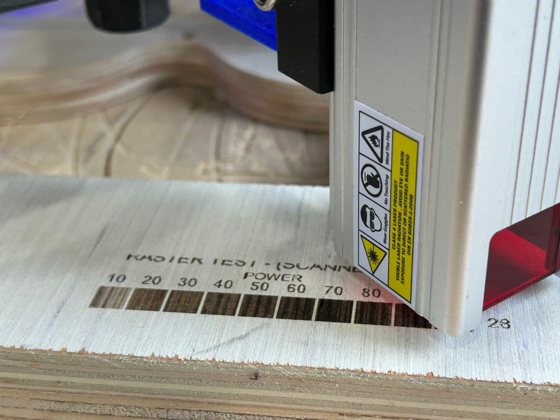

Laser testing today
Small power ramp test set at 28mm/s for Easter scanning
My 10w neje is a bit too powerful to get good greys, as expected, and my mount is too flexible to allow higher speeds.
Even at 28mm there was too much oscillation for it to be useable.
Printing a shorter mount as we speak, am I’m going to rigidificate it a bit after printing with some bracing. Outside of my skill zone for remixing so I’ll go old school
Uuggh. A little dissapointed. About to try an actual vector image at a couple speeds. We’ll see
