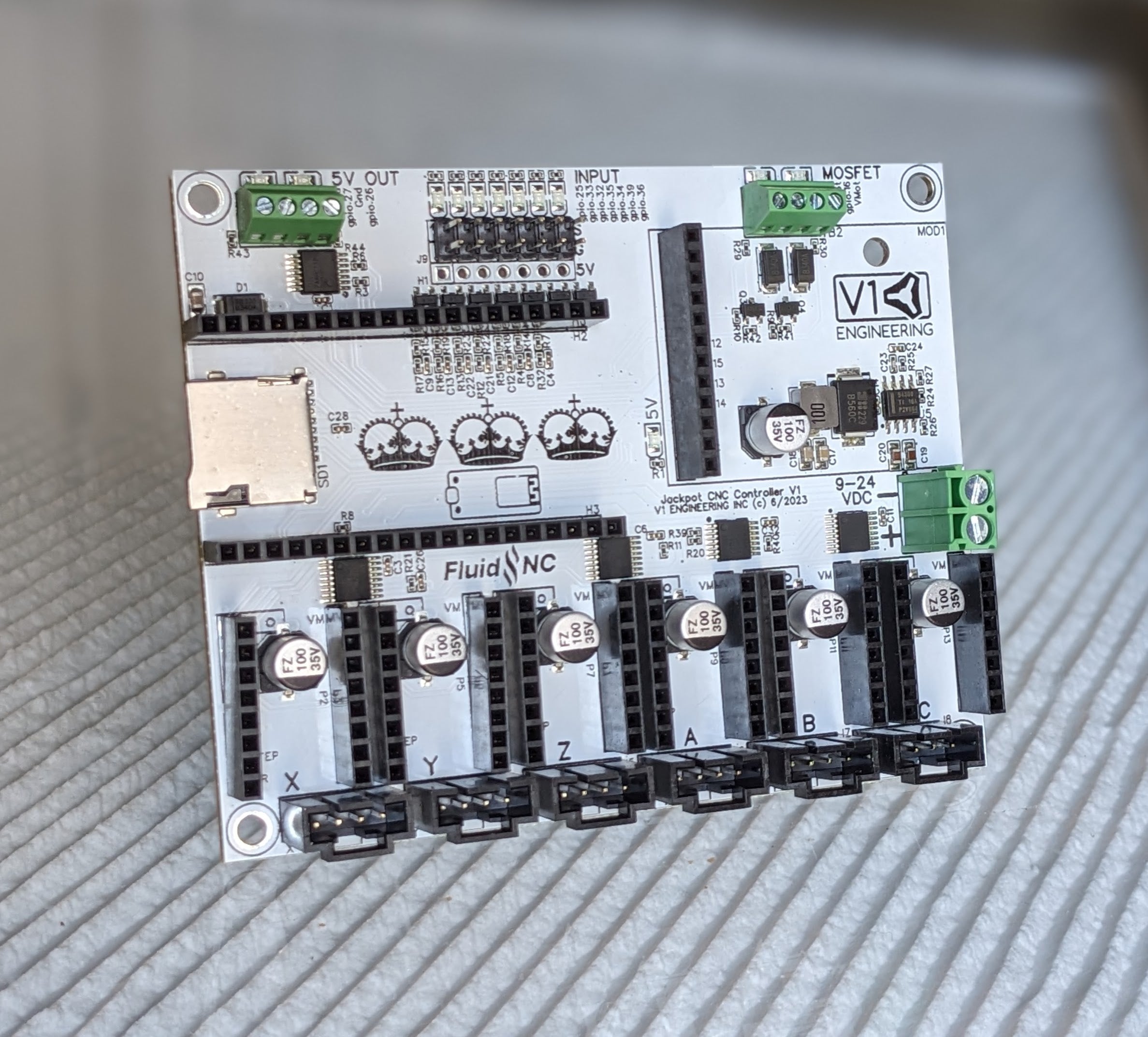

Becuase I did not like that sort of thing we made our own.
