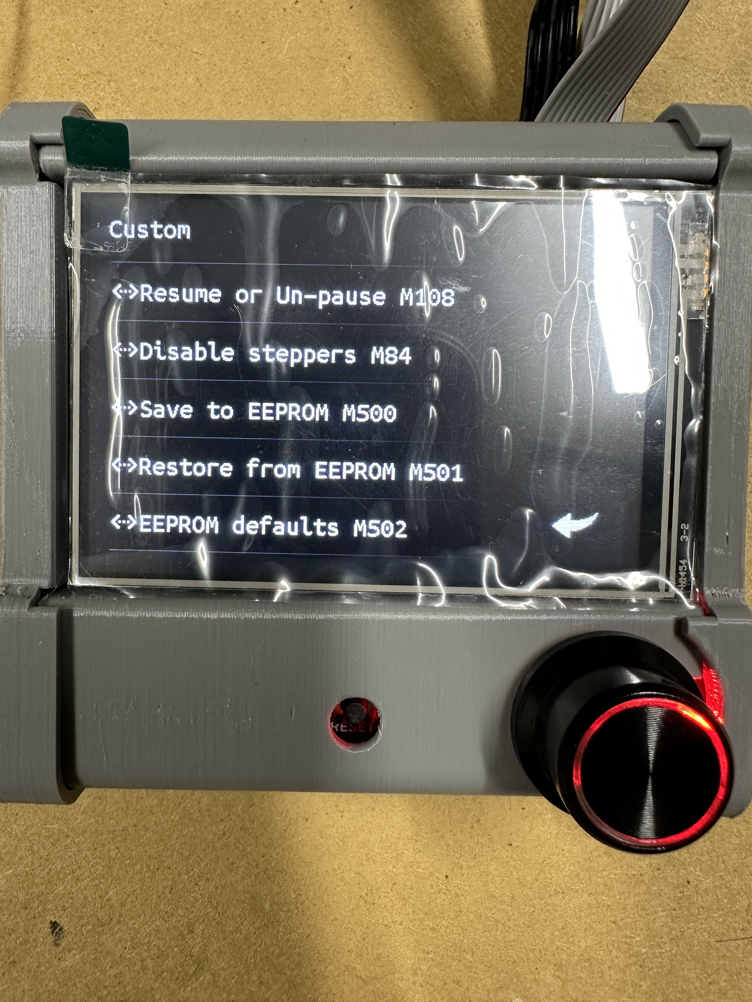

ok so i have updated, however my custom g-code entries in config.ini aren’t showing.
This is what i got:
custom_label_8:Start Router
custom_gcode_8:M106 P0\n
custom_label_9:Stop Router
custom_gcode_9:M107 P0\n
custom_label_10:Start Vacuum
custom_gcode_10:M106 P2\n
custom_label_11:Stop Vacuum
custom_gcode_11:M107 P2\n
But when i go into ā€œCustomā€ they arent listed? Is there a way to re-upload the config.ini file only?
Havenā€˜t you kept your own config.ini?
My understanding is that you simply copy your own config.ini to the sd card.
yeah i did this, but doesnt show the custom entires.
So thought maybe of re-uploading it to try again
