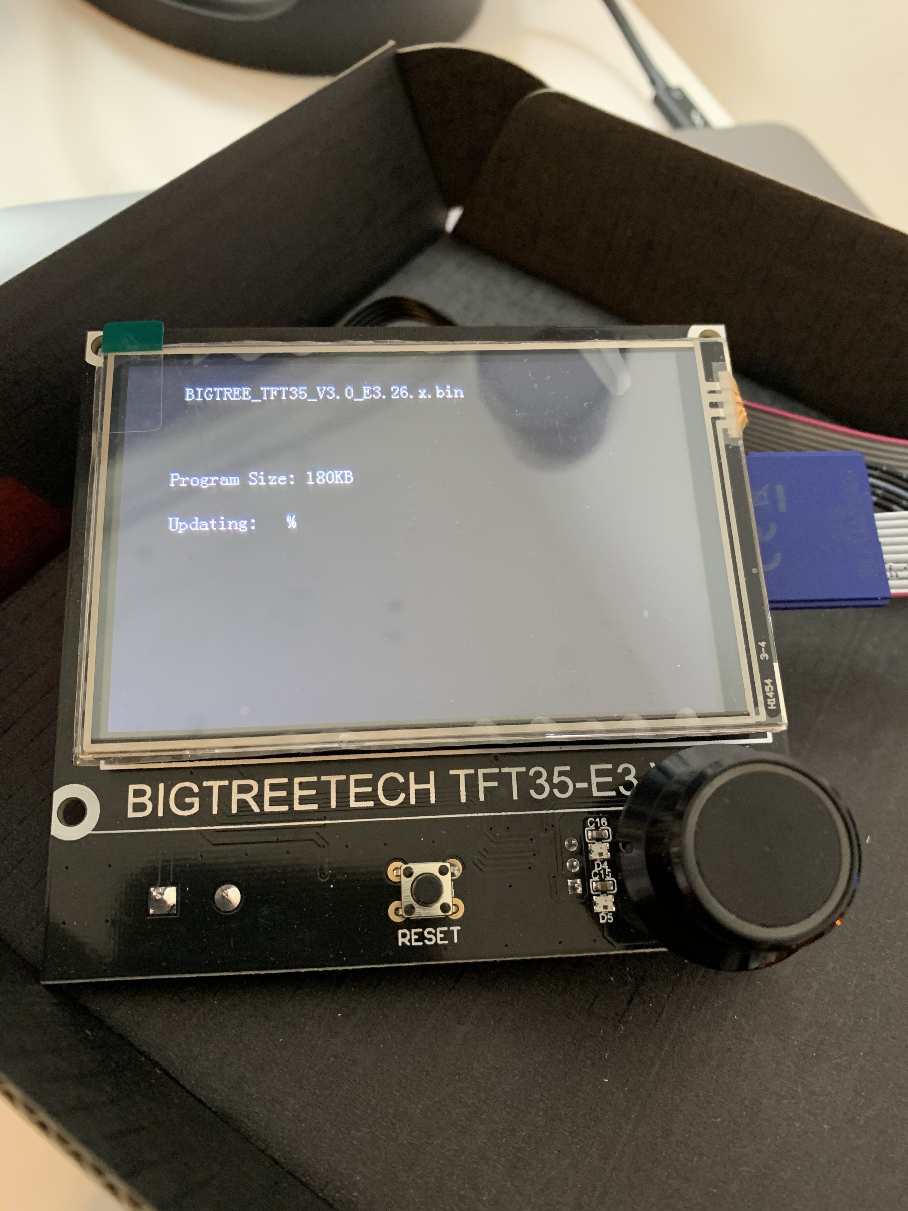

Anyone had an issue with their TFT35-E3 V3 not loading the firmware? I’ve loaded the files on the SD card and rebooted the board and it reads the correct file size for the new .bin file, but it doesn’t load and just freezes.
Did you put the fonts and bmp folders on also?
What files do you have on there, more than just the bin correct? You should at least have the bin and config, and if this is the first time you need the folder as well with all the graphics.
The card has the .bin file along with the config.ini and the TFT35 folder with the font and bmp folders.
Have any of them been renamed? Each boot should renamed them.
I suggest a fresh download and try again. It seems to see the files, not sure why it is not loading them. How big is your card, how is it formatted?
Yeah the two .cur files are in there as well. I’m trying to reflash new firmware because the screen is just blank without it.

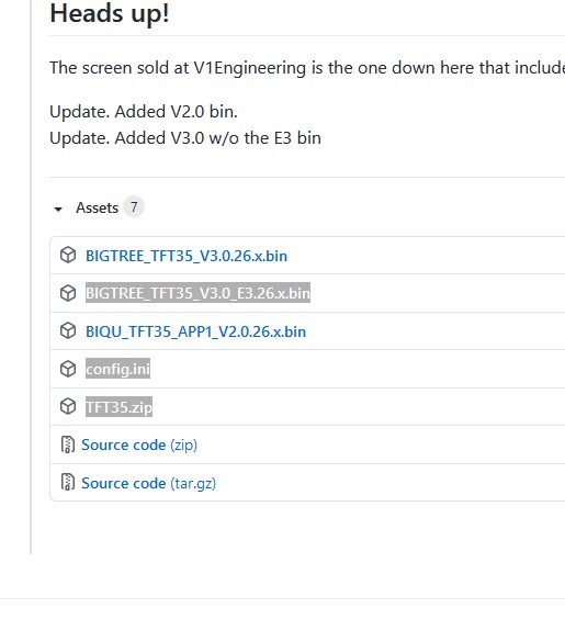

For a fresh download are you suggesting downloading the files fresh from github here?
The card is 16 GB and it is formatted FAT32.
Disconnect the EXP1 and 2 cables, then try.
These three, make sure to unzip the folder. Delete the all other files off of the card.
Restarting with the EXP1 and 2 cables did the trick!
Thanks so much for the help.
