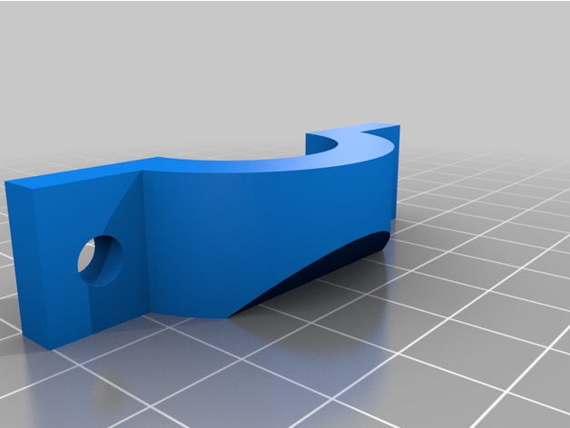

@vicious1 This is my humble opinion:
My recommendation would be to make the tensioning bolt slotted so it could be used to push the pipe up against the other two bearings. You could have the clamps installed, put the pipe in, and then use a screwdriver to wedge between the bearing and the plastic to push it up against the pipe before tightening down the nut. Maybe rely on washers for those bearings to ride on instead of the 3d printed lip. There’s a reason most other CNC machines rely on at least one eccentric bolt on each axis.
That does add parts, and the real trick is you are depending on the tension of the bolt to hold the bolt in place, laterally. As the plastic gives over time, it will slip. Compare that to a bolt that is pulling the bearing in tighter, and as you tighten it, it will suck into the tube. The second case could still loosen over time, but the loose is proportional to the screw and plastic give. If you’re depending on the tension to hold it in place, once you reach enough give to slide the bolt to the side, it will go all the way to the side.

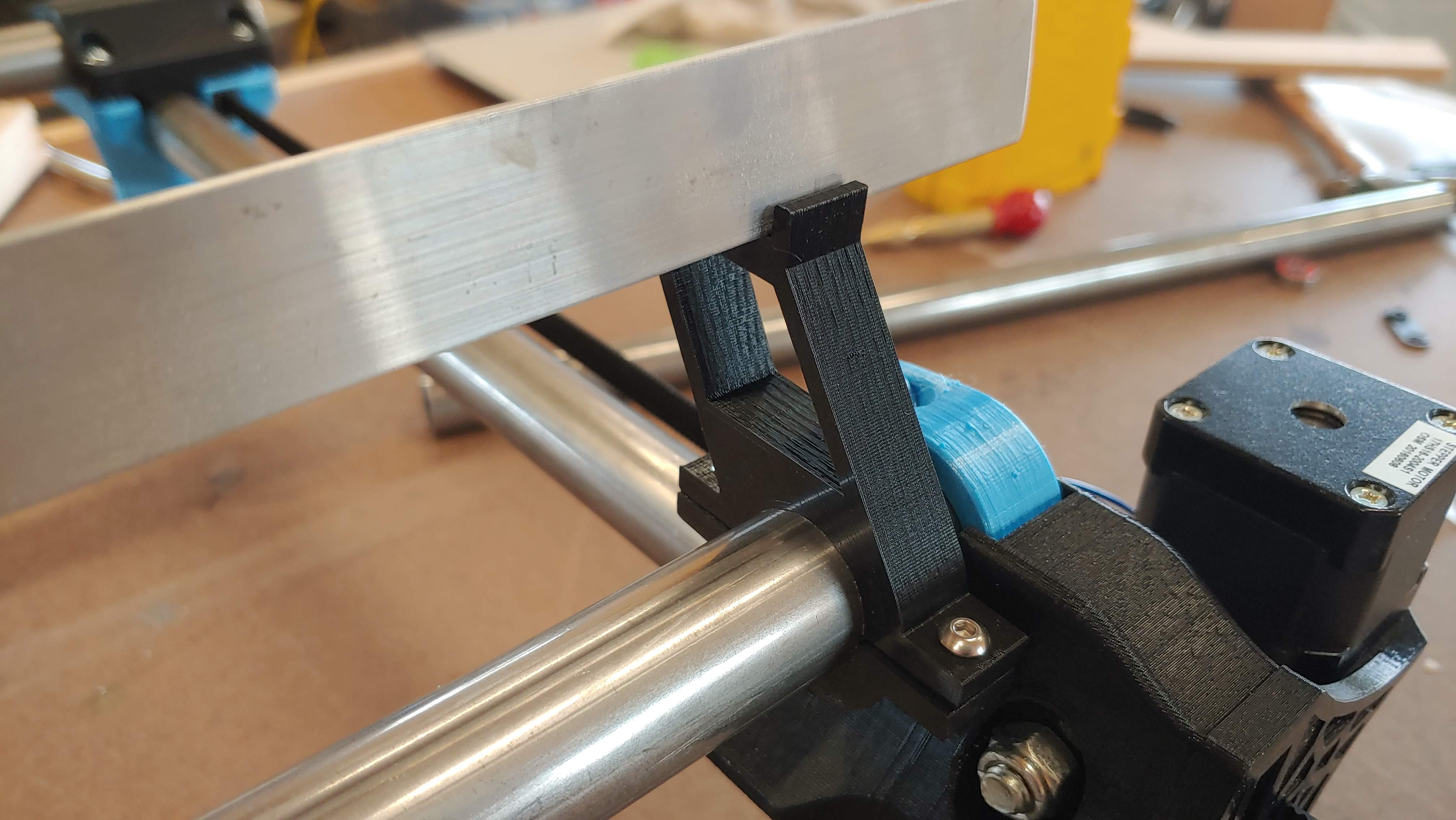

The hardware is now finished. The last thing I wanted to get done was to design a cable run mount. I got that finished earlier today and mounted up.

Here’s the cable run mount I came up with:
@niget2002 Looking good! What was your thinking on how you positioned the angle (the vertical leg of the angle is adjacent to the Core in your photos)? I’ve seen another design that had it reversed so the vertical leg was flipped (away from the Core). It looks like you could easily flip it on your design without any part changes. I just wanted to get input on if one orientation was better than the other.
As with most things I design: TLAR
I mean… I really don’t think it matters. It just happens to be the way I had it on my other machine, so that’s the way I put it on this one. The cables are going to be held onto the plate using zip ties.
I guess on this machine it might matter some. I tried my hardest to keep the Flat part of the angle aluminum as close to the core as possible. Depending on how you install the zip ties, they could interfere with the core if it was flipped the other way. My plan is to drill small holes in the bottom of the angle aluminum and use the zip tie out over the outer edge and loop back to the hole to hold the cables on.
And then from the aesthetics side, I think it just looks better to hide the cable chain.

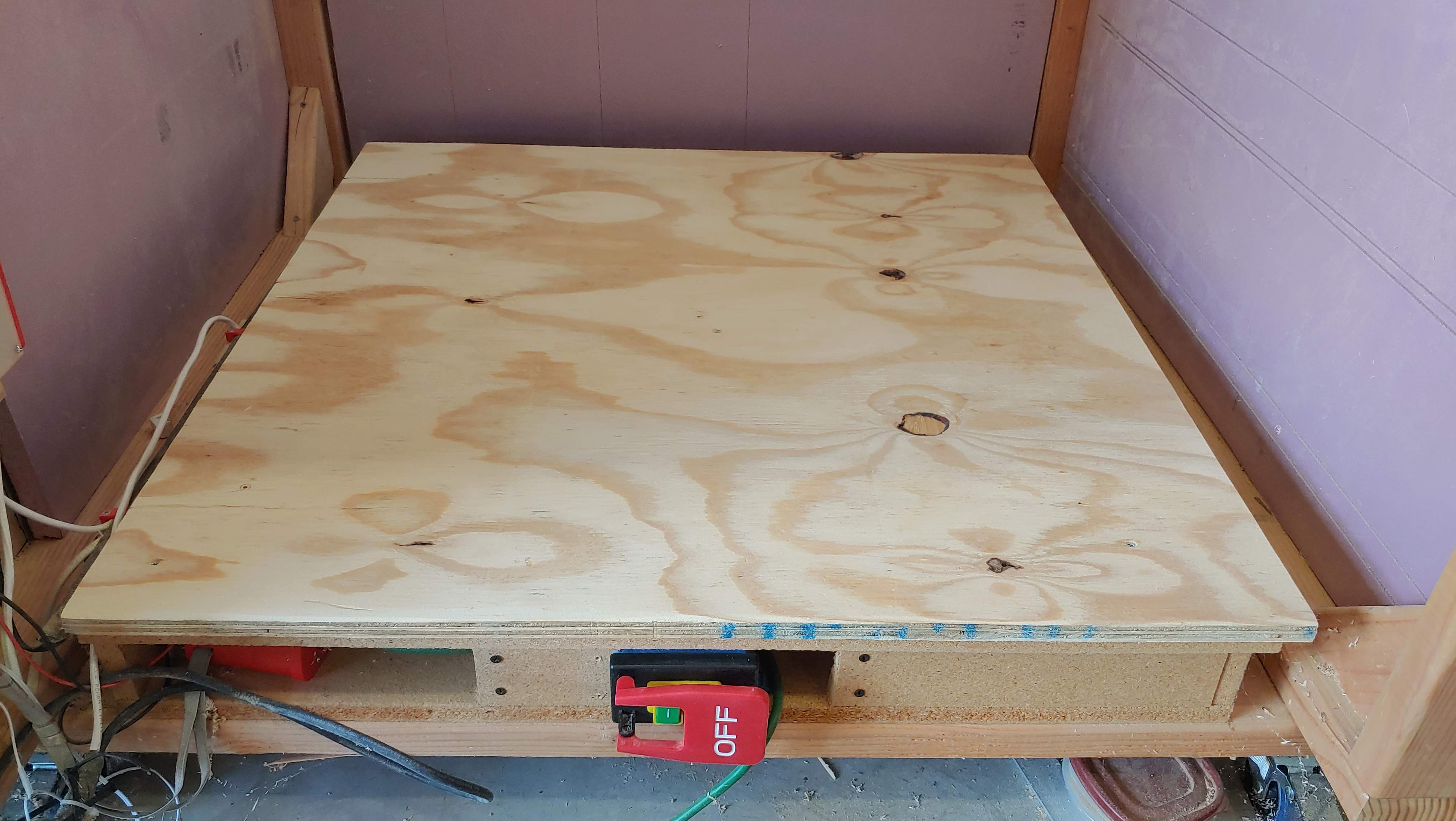

I did sneak out to the shop on my lunch break and get a new build platform installed in the old enclosure. Had to bump up in length and width to fit the new feet. Luckily the enclosure is plenty wide for the steppers to still fit and run back and forth correctly (I think). I’m just hoping our test fitting last night was true.
I used 3/4" exterior grade plywood that I then sanded down so that I don’t get splinters. The spoilboard will be surfaced by the router, so this surface being perfectly flat is a little less of an issue.
I may end up needing to cut longer legs, though. I need to redo the math and make sure I have the clearance I want with the current legs.

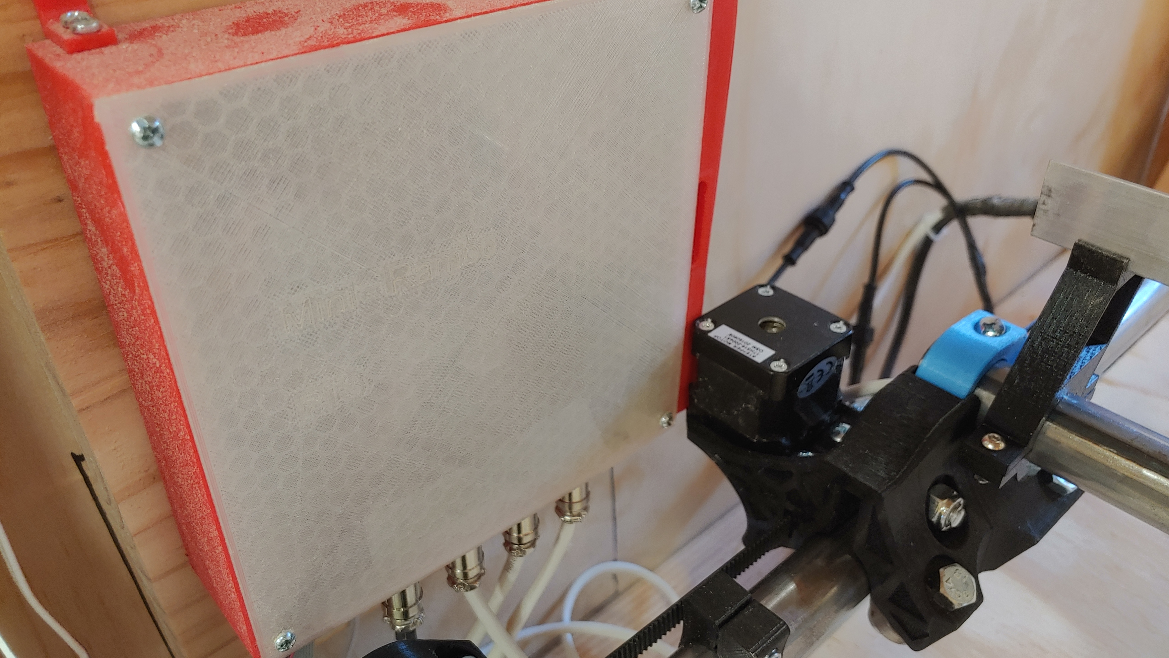

First Moves! Still need to wire the Y axis, but the X and Z move. This machine seems to be quite a bit quieter than the last one.

I finished wiring up the Y axis. I need to do some wire management.
I also discovered that my controller is too low. Good thing I planned on moving it.
