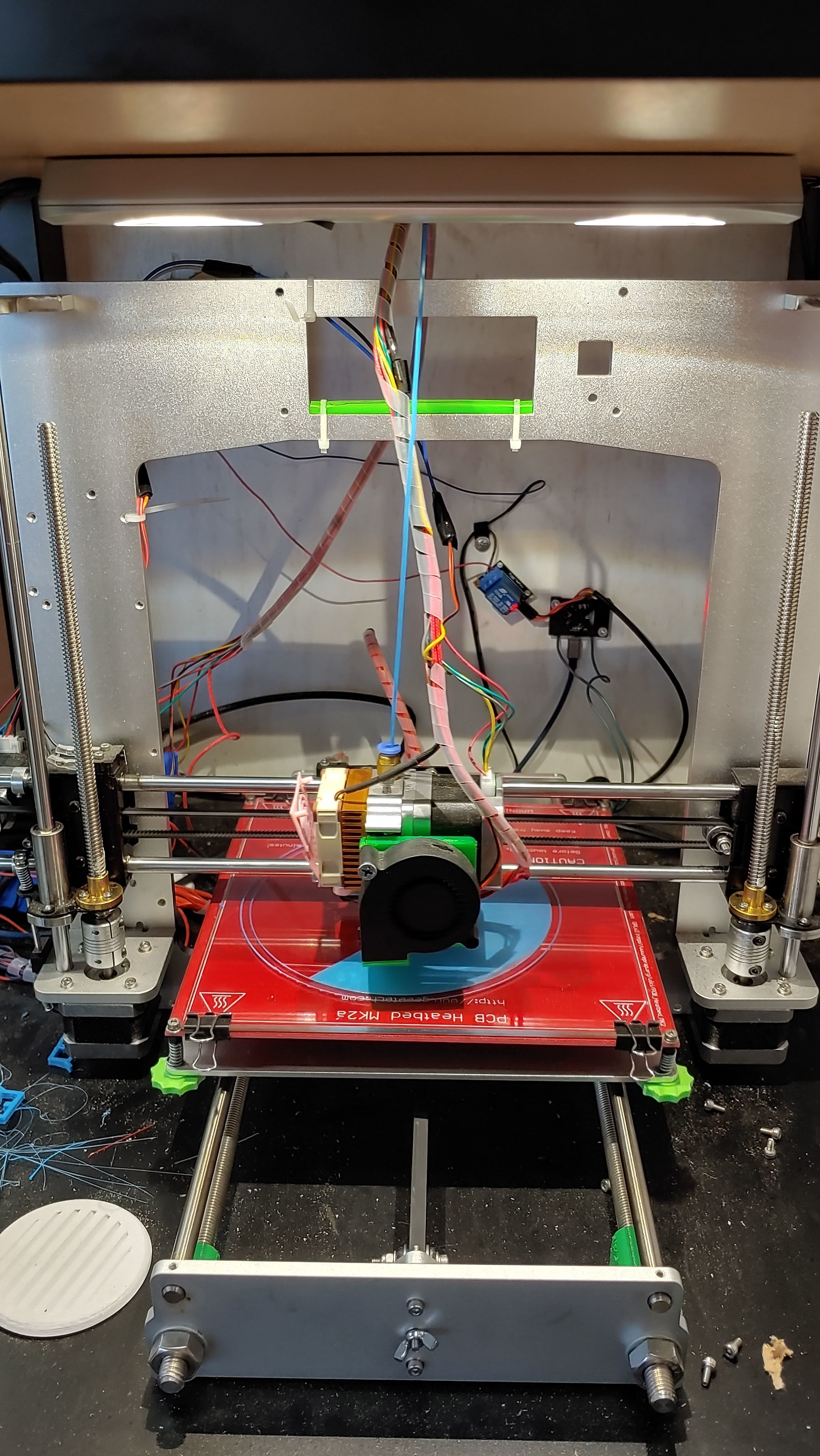

I’d rather try replacing the bent parts with straight ones first. When I first built it, I had no money so I was trying to fix everything myself. I’m doing a little better now and can order some new leadscrews.
Mine is the older geeetech aluminum i3
The parts were so bad, I had to replace all the rods with new ones because the machine wouldn’t even move when first built.
Ordered new leadscrews this morning. Should be in Monday.

New lead screws came in. I guess the old ones were T8x4. The new ones are T8x2. Some quick math and adjustments of some settings in the firmware and I’m back on track.

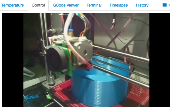

Currently printing a 150mmx150mm cylinder in vase mode to make sure it prints all the way up.
I also noticed the old screws were 300mm and I bought 250mm. It’s OK, though. The old ones were designed to go all the way to the top of the machine even though the printer can’t print that high. I should have more than enough length on the lead screws to match the opening on the frame.
Picture cause they’re fun:
Looks to be about half-way through the print of the cylinder. Got a little bit of a band near the bottom, but the rest is looking pretty promising. Here’s hoping the second half of the print goes smoothly.

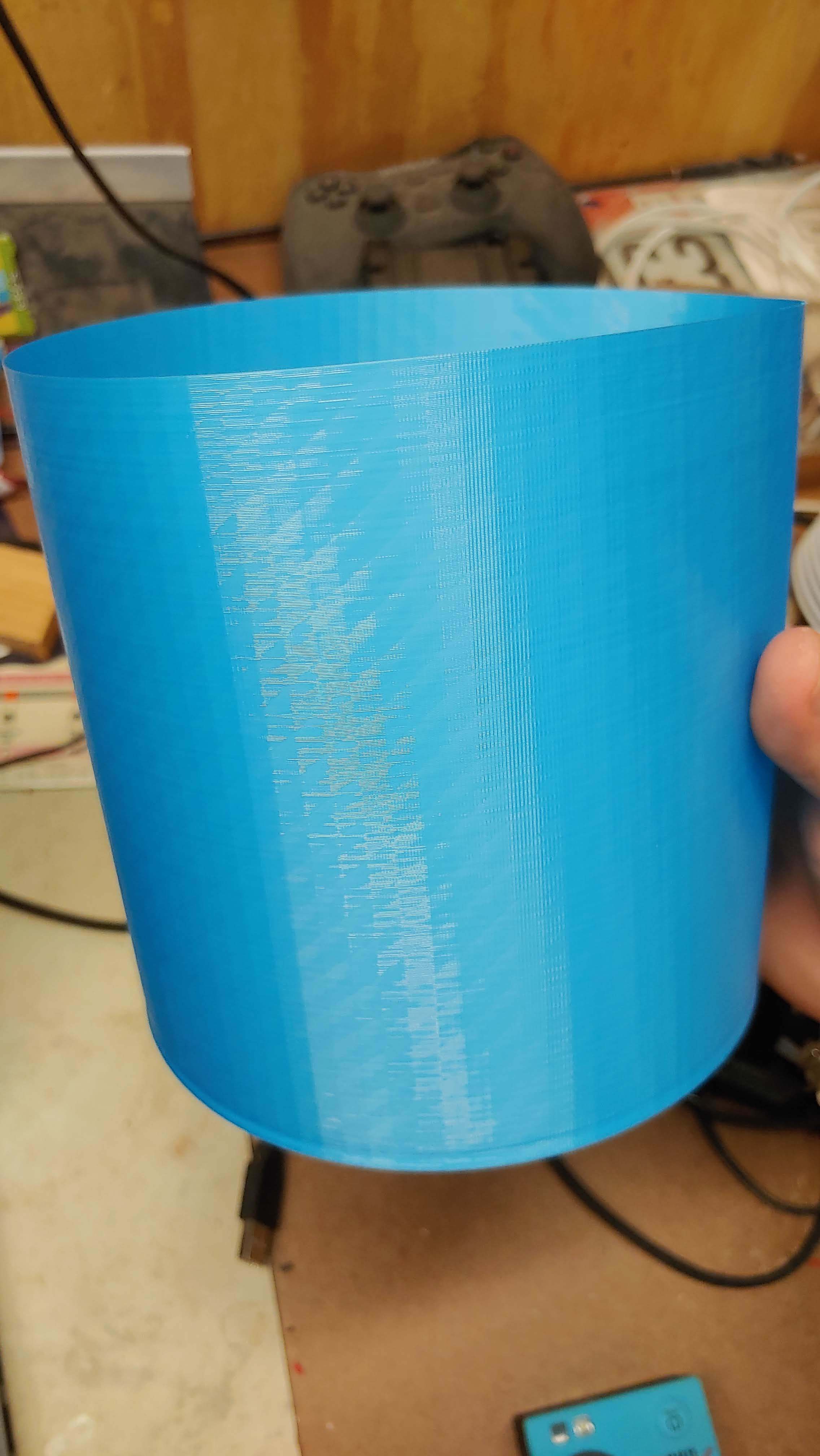

Well. It made it to 150. I’ll get a better look in the morning and if it looks good, I’ll retry the core.
Took a close up look at the print this morning. It looks pretty good. It was vase mode, so not a lot of random movements.
