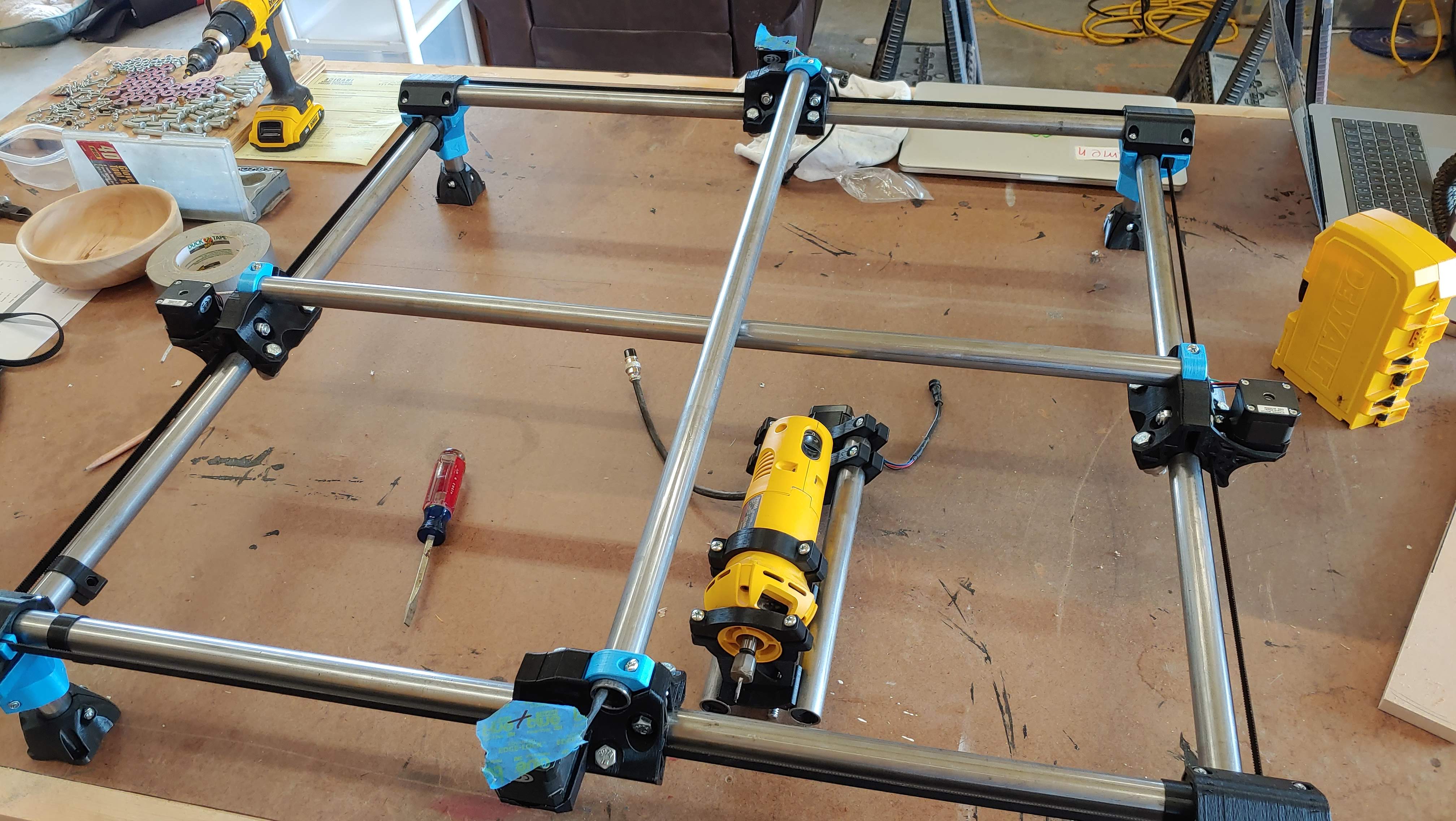

Put together everything I have parts for for a sanity check on belt/tube lengths. The calculator looks like it produced some accurate values. I was also happy to see that my X axis steppers that I just rewired a few months ago had enough extra to fit the new tubes. I think I’ll finally take this opportunity to re-wire the Y axis now too. It’ll be nice to be able to work on the machine without a soldering iron.

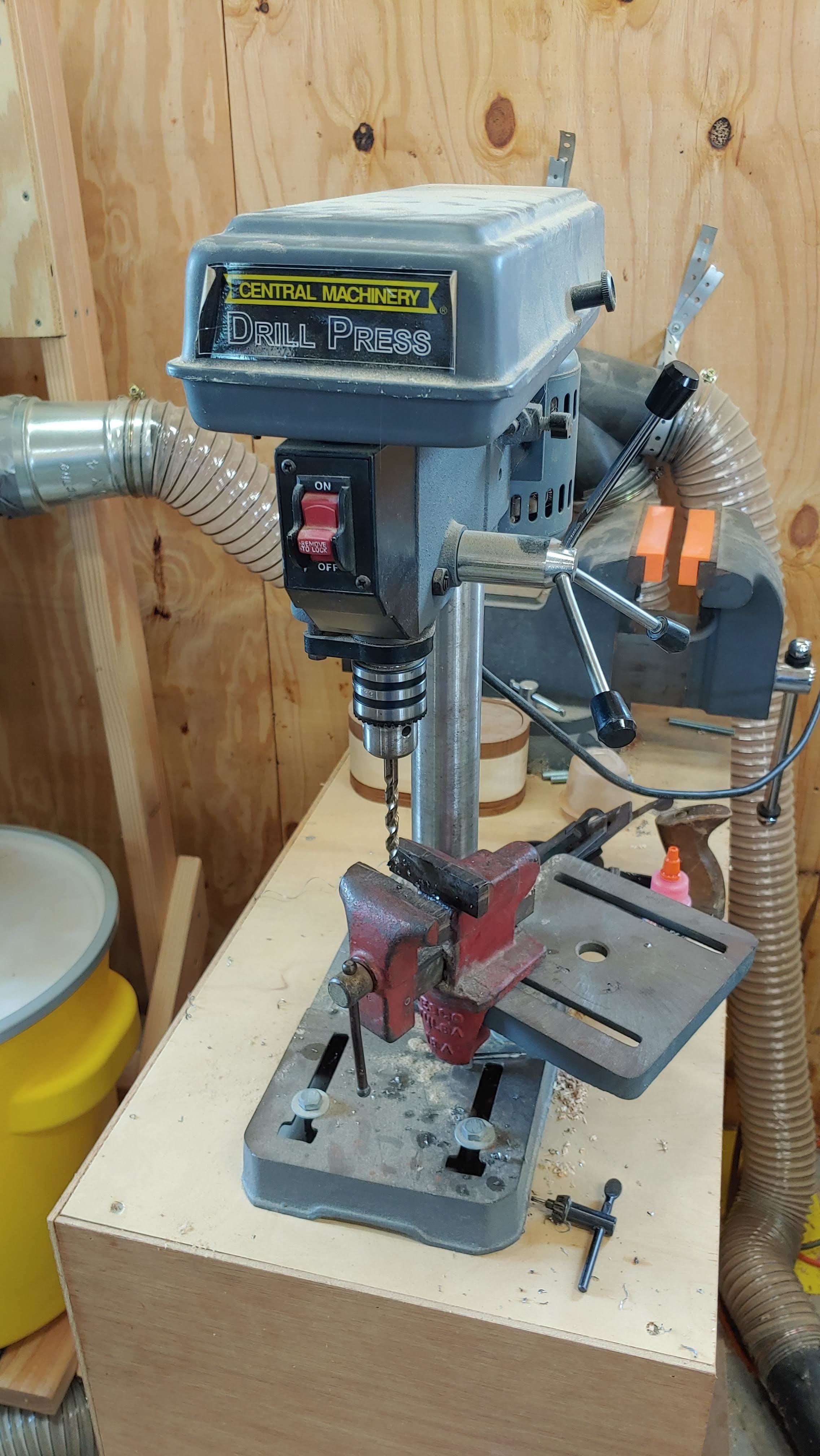

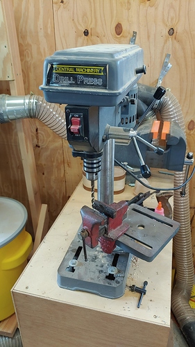

I’m really liking the new Z axis. It’s not much different than the old, but it looks cleaner for some reason. Probably the new parts. I did have to rig up a makeshift setup to drill the holes on the pipes. One day I’ll invest in a real drill press vise.

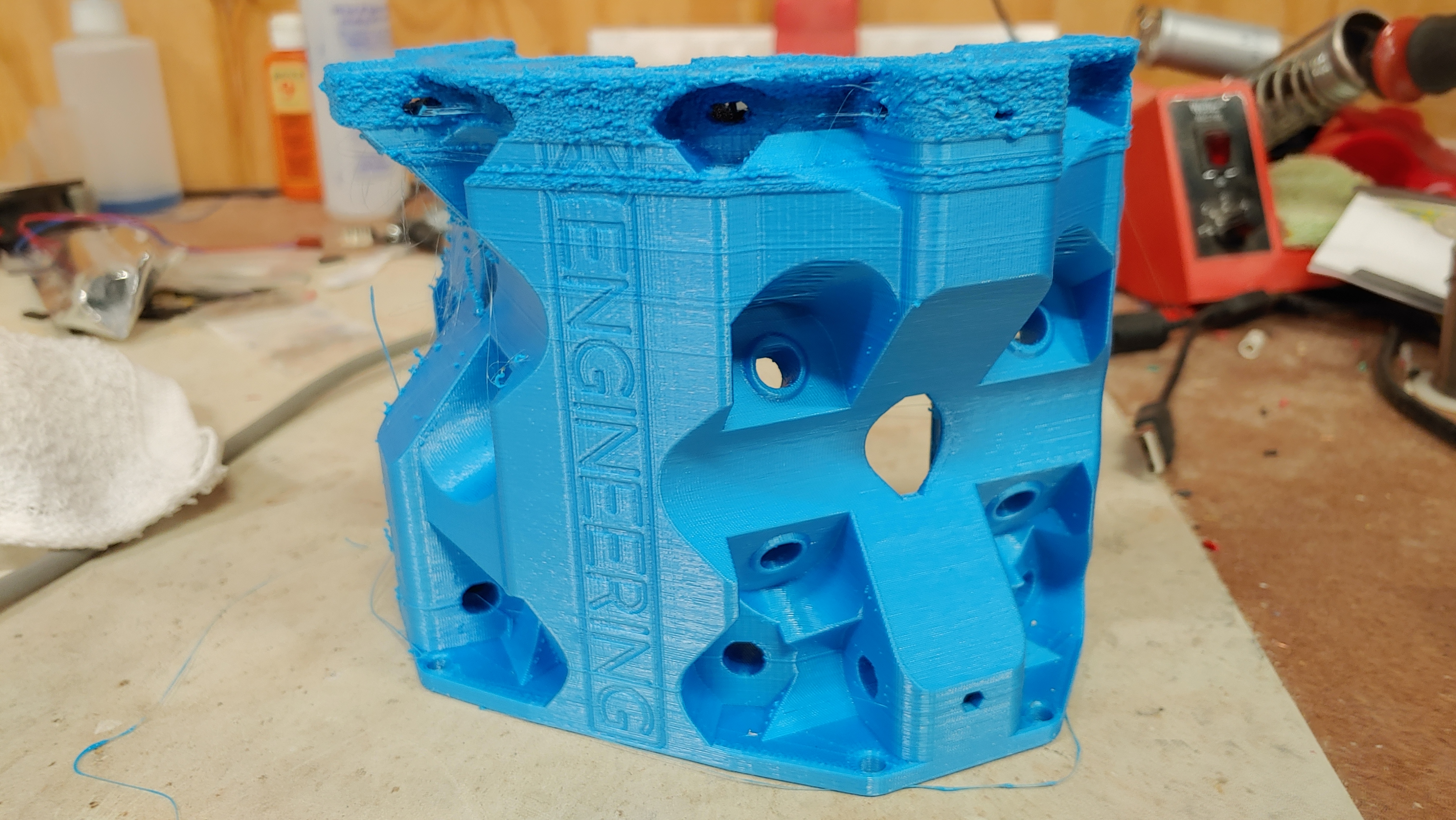

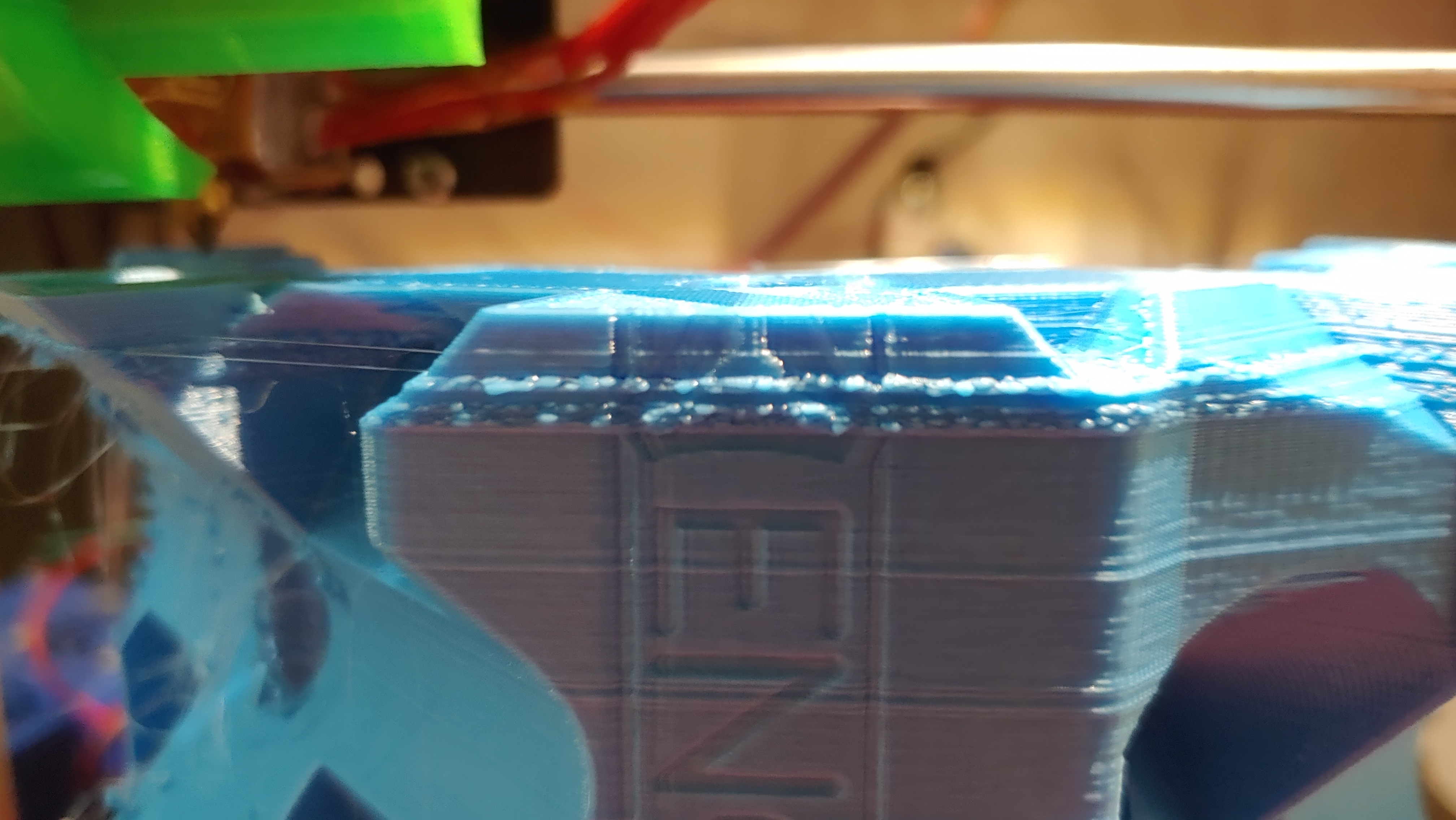

Well… The core hasn’t completely failed yet, but something weird happened here…
Hopefully it will still be useable and I can reprint it later.
I’m really not liking this filament.

Good news… I didn’t run out of filament. Bad news. My printer decided it didn’t want to use its full z height. I guess my core will be a different color. :frowning:
Is that skipped steps in Z? Brutal.
That is a bummer.

@niget2002 That print looks like either shitty filament, or you have a clogged nozzle.
IDK. It looks like the Z stopped going up, and the top layers are smashed.
What Jeff said.

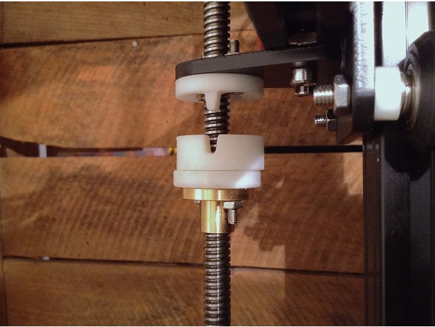

Before turning the machine off, I tried moving the Z up and it was stuck. I hit ‘home’ on the Z and it clicked a bunch before going down.
Do you know why? Out of lubrication? Cords taught?
I think there are a few of us around :rofl::rofl::upside_down_face:
From a previous comment:
From what I can see, when the machine gets higher up, the bent leadscrews bend farther then the couplers can compensate and locked up the machine.
If I jog in 10mm increments, it works fine, but when it tries to move a smaller amount during a print, it catches.
It’s a known bug on the machine, I just don’t print that high very often and forgot about it.
What printer do you have? Might see if anyone has made some oldham couplers for it. Like these.
We played around with them on my printer trying to get some z banding to go away.
