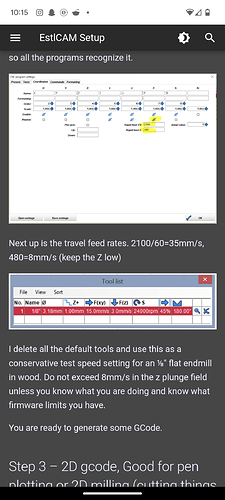

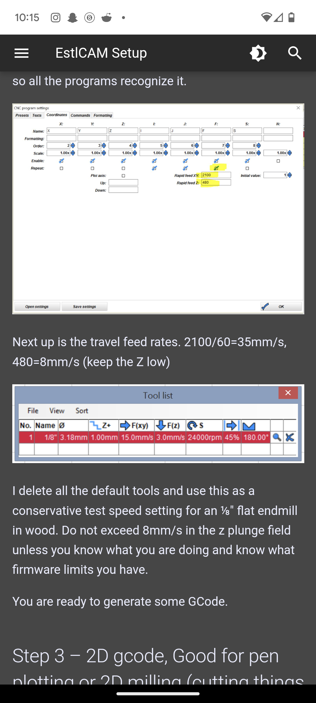

What speed should I keep my axis for another pen job that I’m trying to complete, and also height will remain at .
Here’s what I gathered I’m wondering the setup for the crown??
alright thanks will troubleshoot
The 12mm/s that the test crown runs seems reasonable, but you can probably go faster with a pen. 12mm/s is 720mm/minute, i think my last pen run was at 1000mm/minute and it worked great with a fine point sharpie.
I copied the parameter for the crown and did all the drawing at 1mm “deep”.

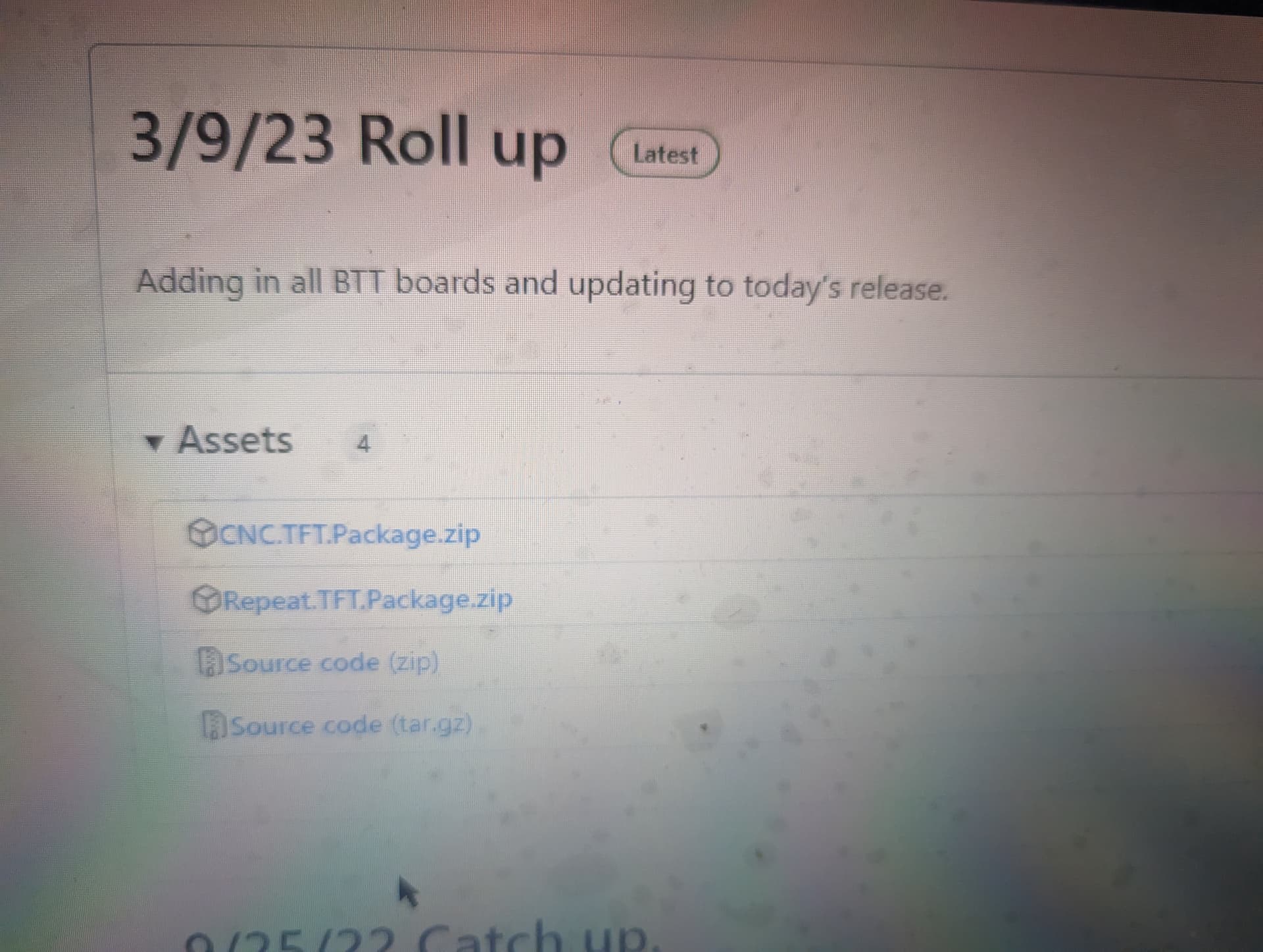

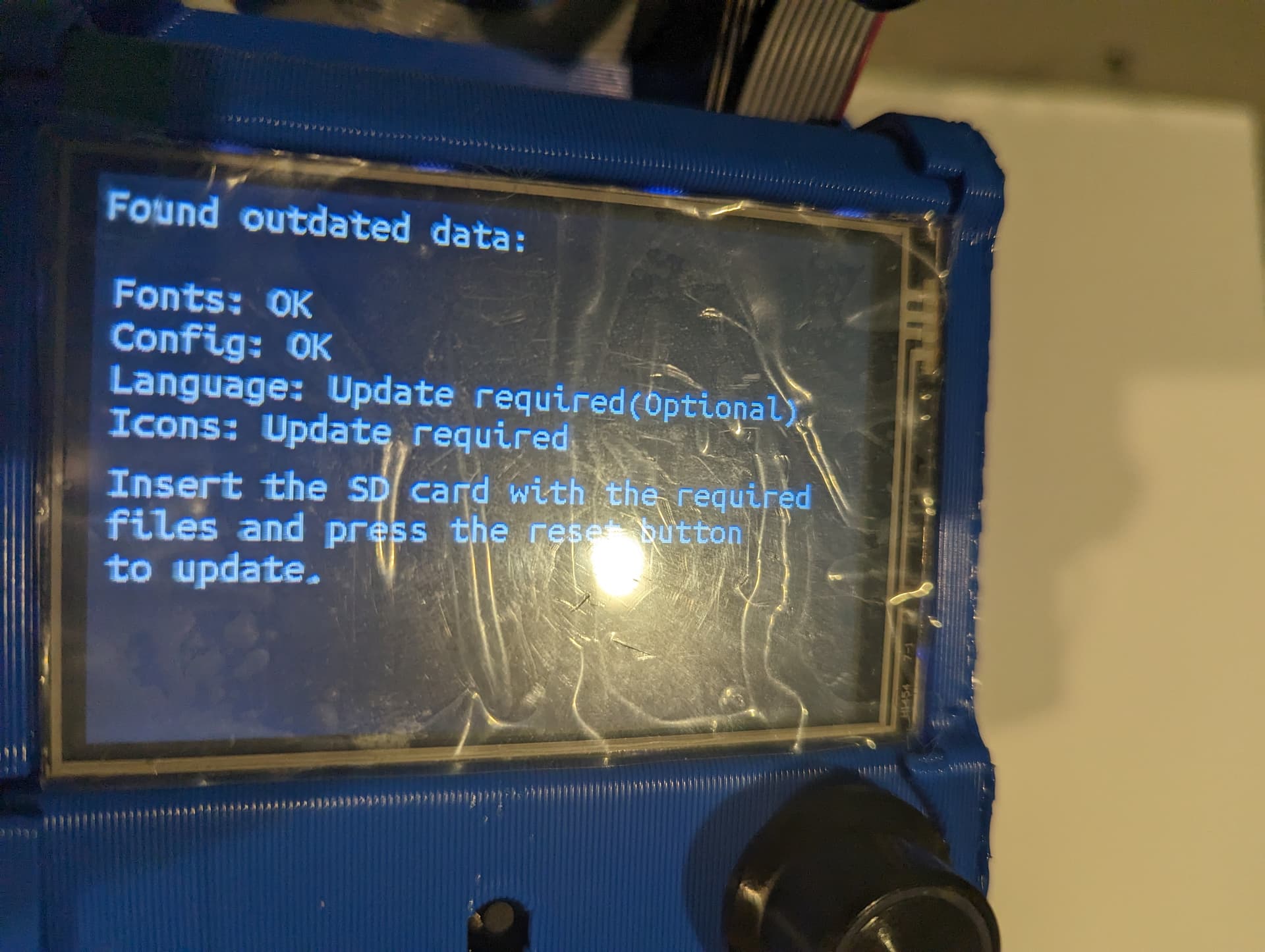

Hey fellas ,just after my first sketch I got a notice about the screen being outdated , I’m here trying to figure out what is the first step after this link I found ?

Yes, I just installed that on my spare TFT35.

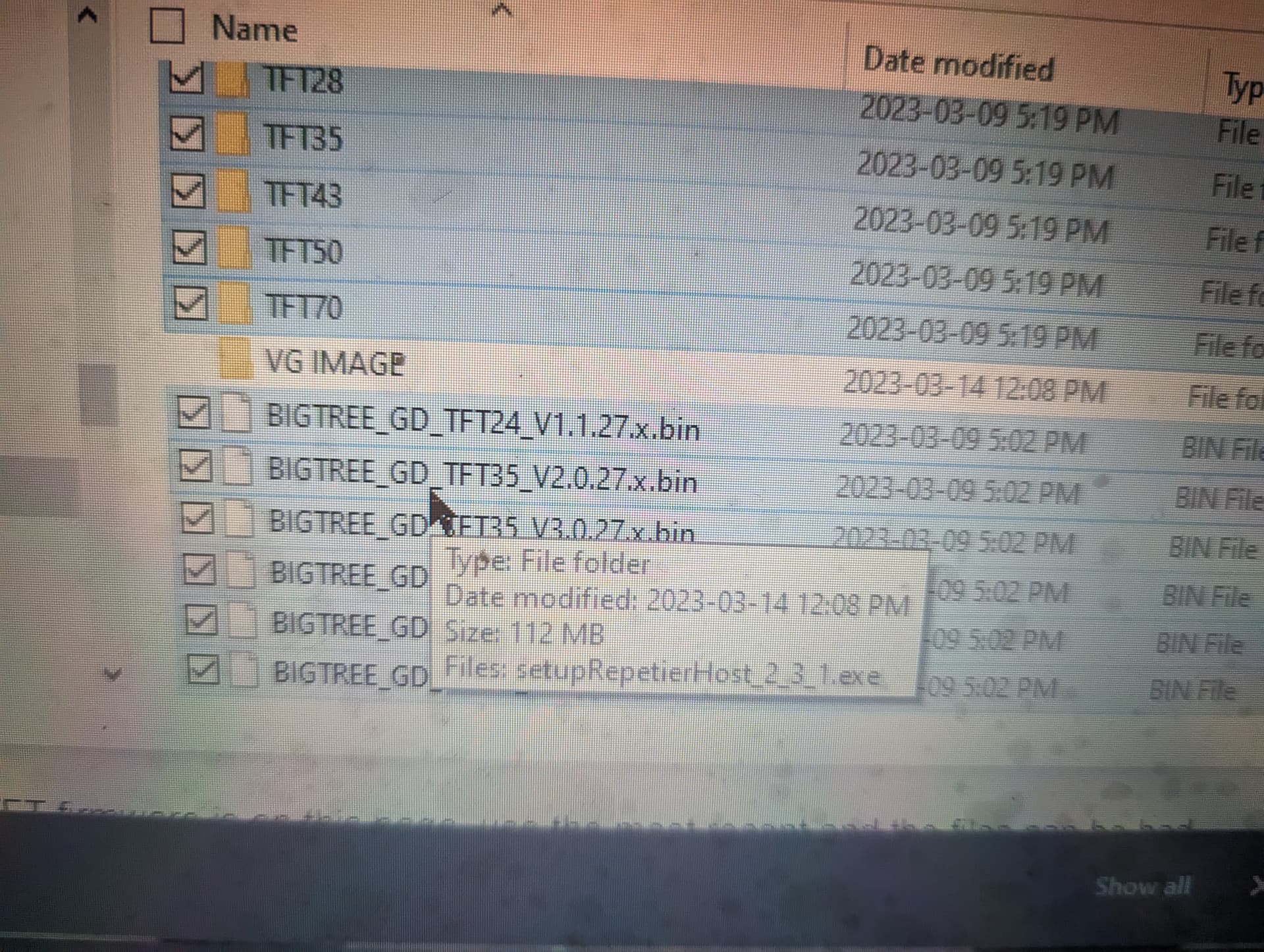

Unzip the CNC.TFT.Package.zip file, there is one folder in it.
Put all of those files on the root of an SD card (Not in the rollout directory) and insert it into the TFT. When you power on, it will start updating. It takes a few minutes.

Okay just to confirm does this have to be inserted in the motherboard.
What I understood was that it should be implemented into the screen !? #unsure
No. Put those files on an SD card in the TFT35 LCD.
Yes, those files should be in the root of the SD card.
I believe that you only need the TFT35 folder, and not all of the other ones. You also only need ONE of the .bin files but the rest of them won’t hurt.
Hey fellas ,
My newest discovery after trying for a round 2 is that my machine keeps bottoming out and I’m not certain to why is that here’s all the details I have plugged in . In order to complete what must be done before because no matter what I do with the start height in the machine it still bottoms out
