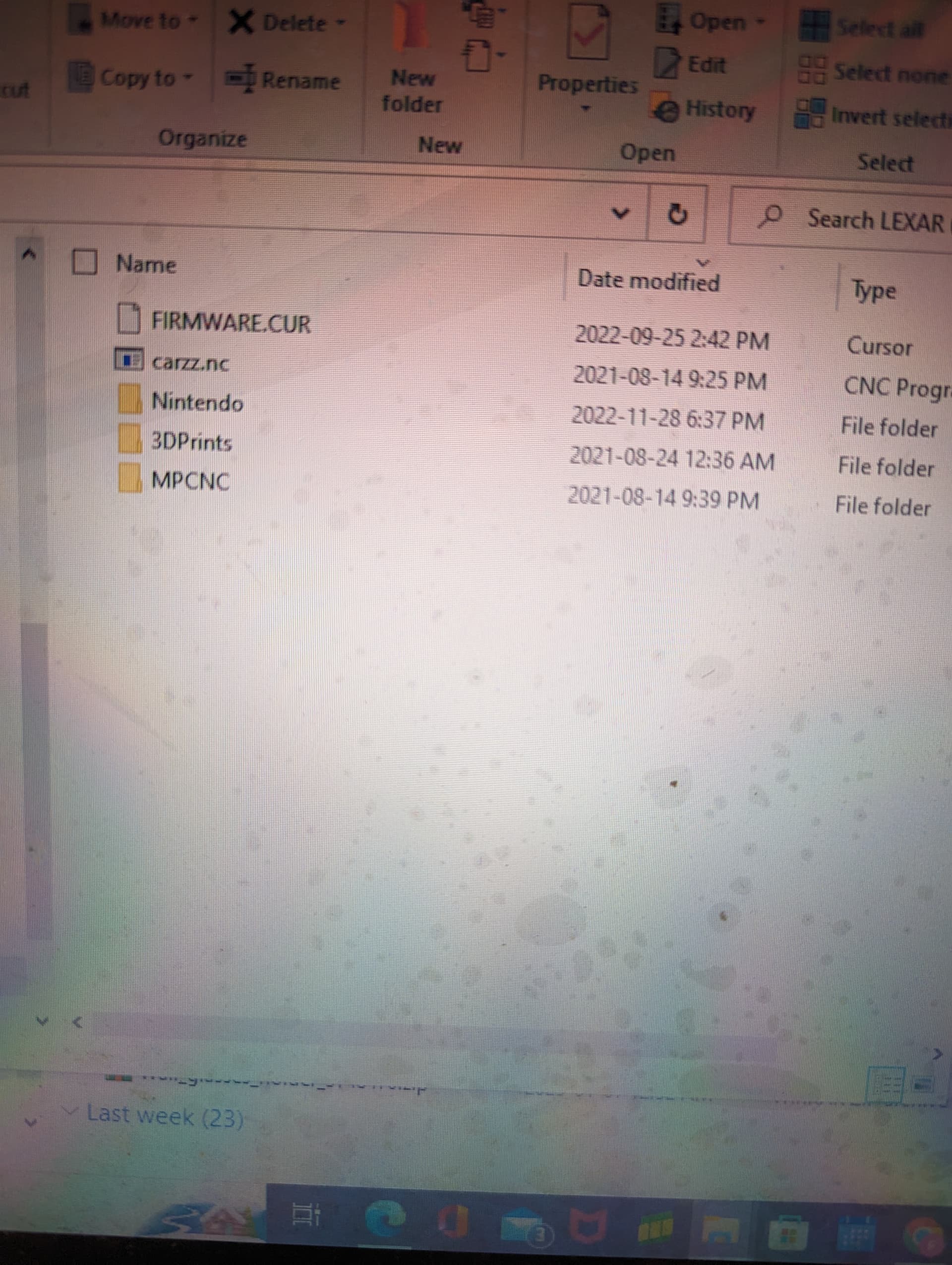

Goodday I’m having issues on starting up my lr3 I’m not completely sure how to access my uploaded files.
I have flashed the motherboard but I keep getting no further than whats on the screen
Just to be clear, you are not using my firmware on the screen.
From either mode hit print.
