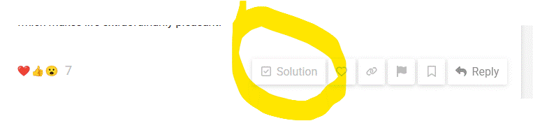

Sorry, but I don’t understand your answer.
You marked @wcherry’s post as a solution to your question.
This was done by checking the Solution box in his post (sample from one of my threads…)
@wcherry didn’t really answer your question, or solve your problem, he only asked if you had made any progress.
It doesn’t really matter, but it seems that you were unaware of what the Solution button meant, or how it works, so I thought I would point that out to you.
