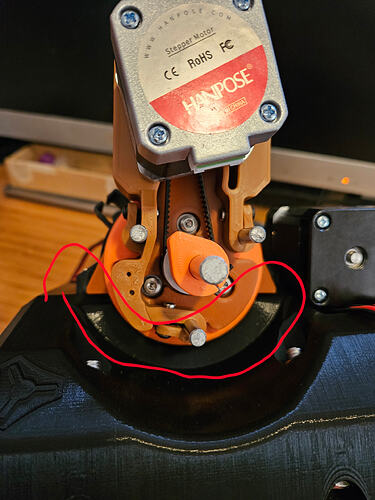

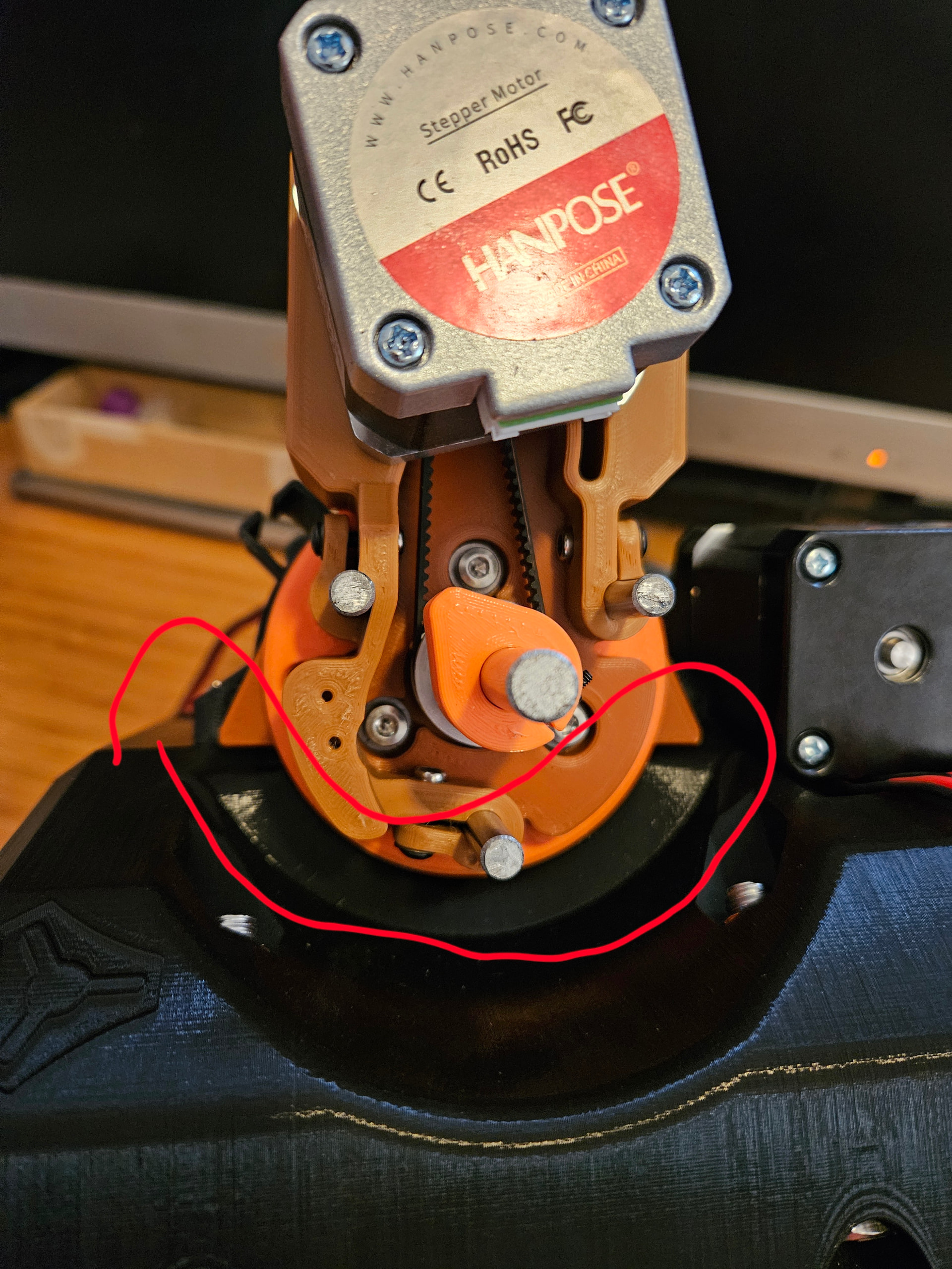

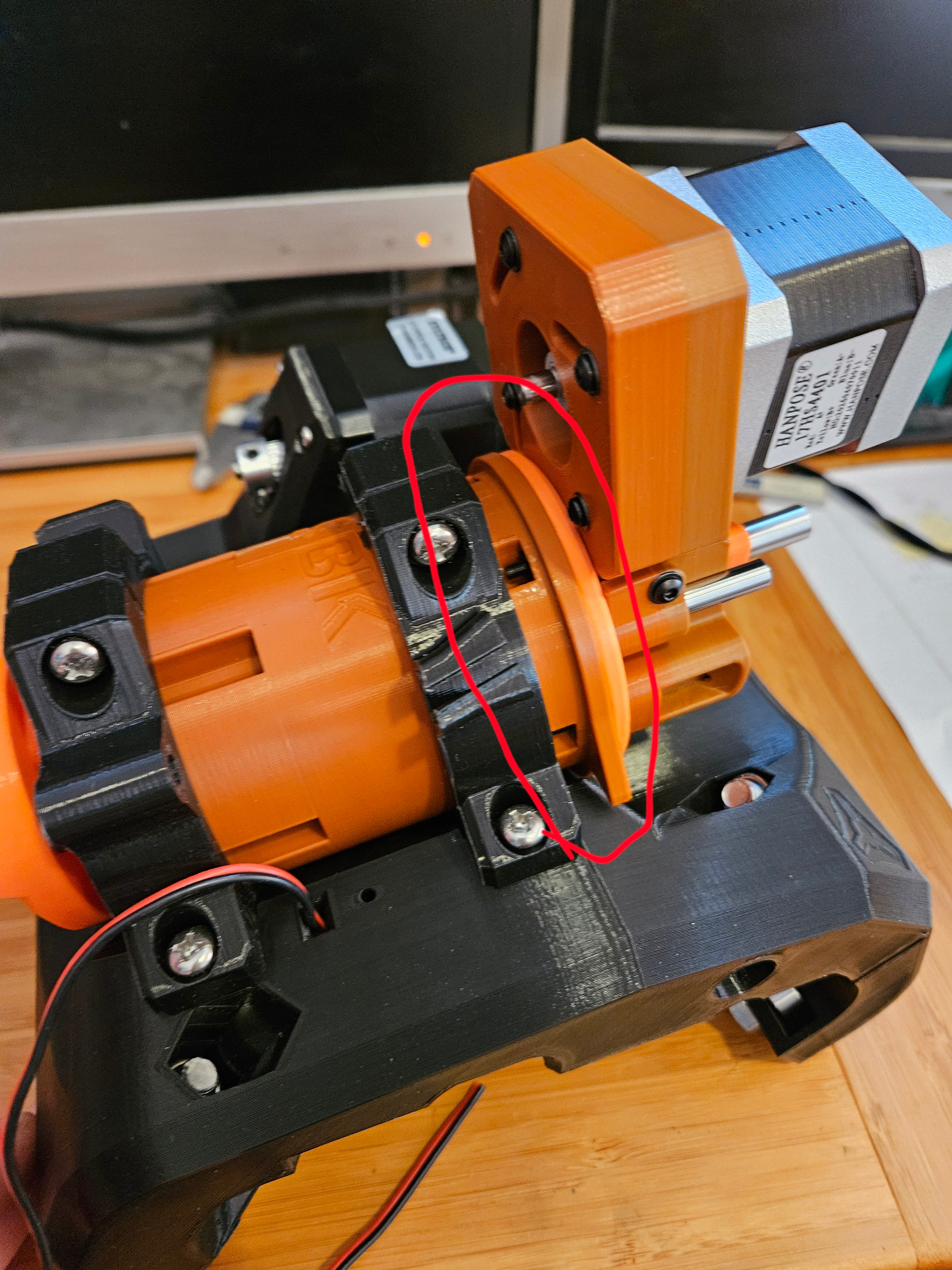

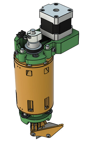

Already found some interferences while trying the knife on the LR4 core tool mounts.
Upper circonference is too big, and I can’t lower the knife ledge on the upper tool mount.
Well this will need a few parts mod/reprint.:sweat_smile:
I think I will just remove the ledge and make the shank a bit longer. So I think that way it will be compatible with MPCNC Primo too ? Shank is 65mm diameter…
I think that would solve the problem and make it both compatible with LR4 and MPCNC…

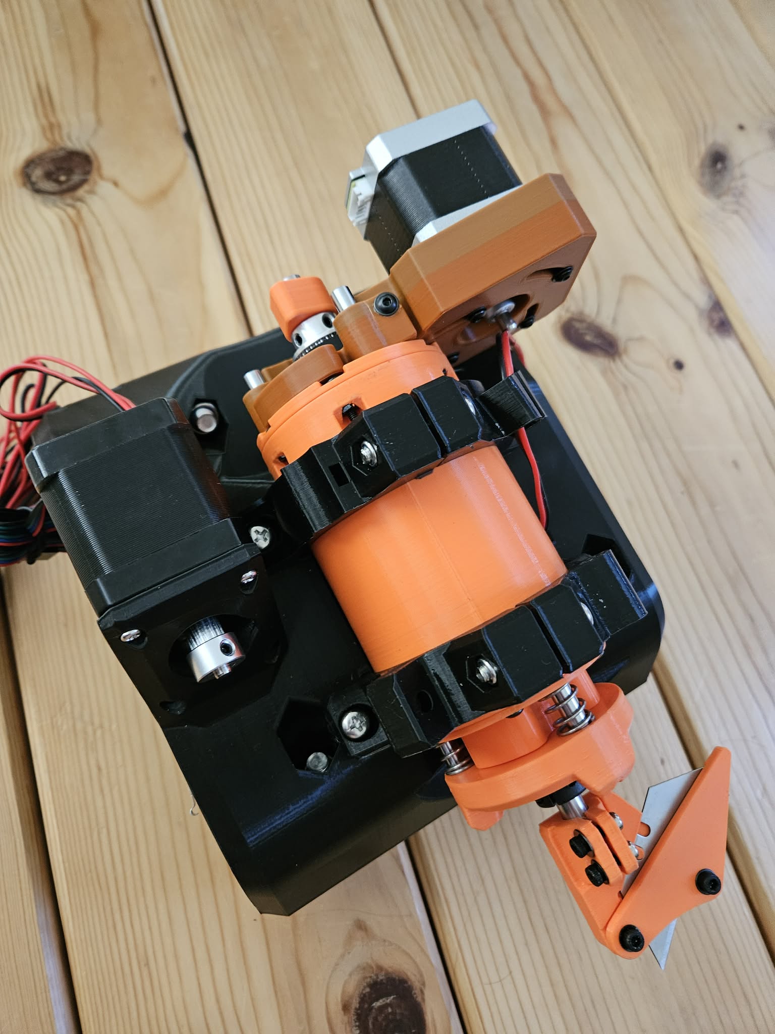

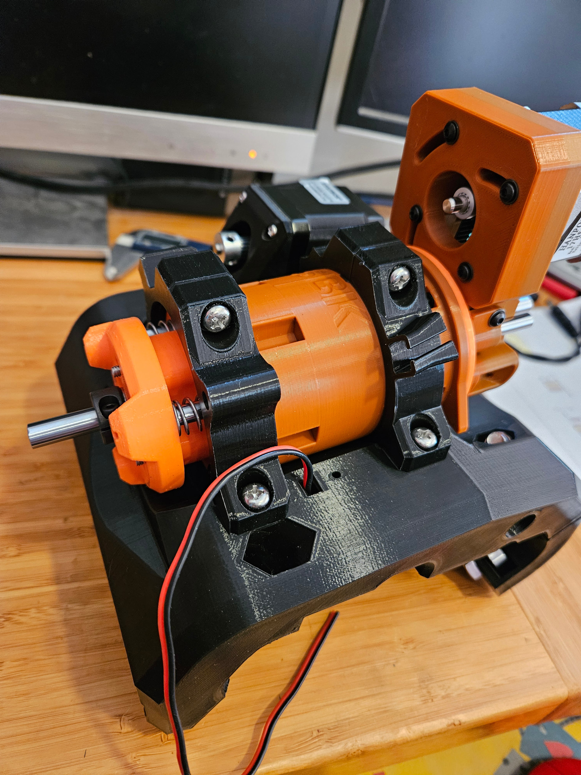

Reprint and remount done, I think it’ll work pretty well!
Shank is 65mm diameter and about 95mm long.
The only minor draw back is that I need to remove the bottom holder clip screw to pass the blade trough the open clip…
I don’t have a MPCNC, any of think it would fit on a it too ?
Spring loaded tool might not be necessary in the end, but I got it now, so… Maybe I’ll make a spring less version later if I don’t see the point while using it.

Looking good. How are you zeroing the blade angle with the machine? Do you have a repeatable hard stop you are using? The MPCNC’s Z has the dual tubes, so just wondering what would be the best way to repeatably zero it between router/knife swaps.

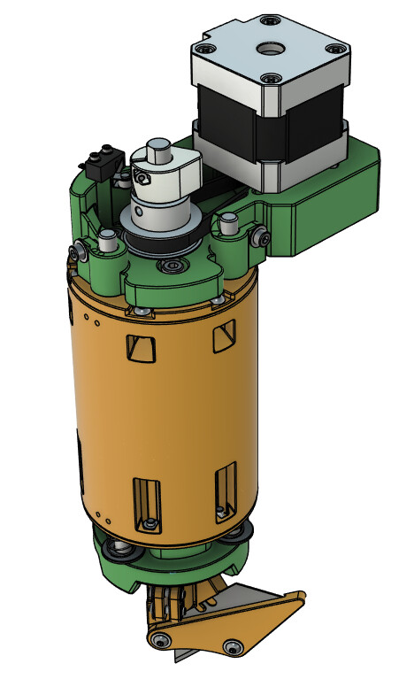

There is an homing switch and a cam on the rotation axis shaft, I plan to zero the axis with the homing switch, then add a correction angle to the homing position to set the blade in FluidNC firmware.
Or another way would be to home the axis, then with the blade holder loose, drag the blade on the table in x or y axis to align it, and tighten the blade holder set/holding screws… That way there is no angle correction for this axis in the FluidNC firmware.
