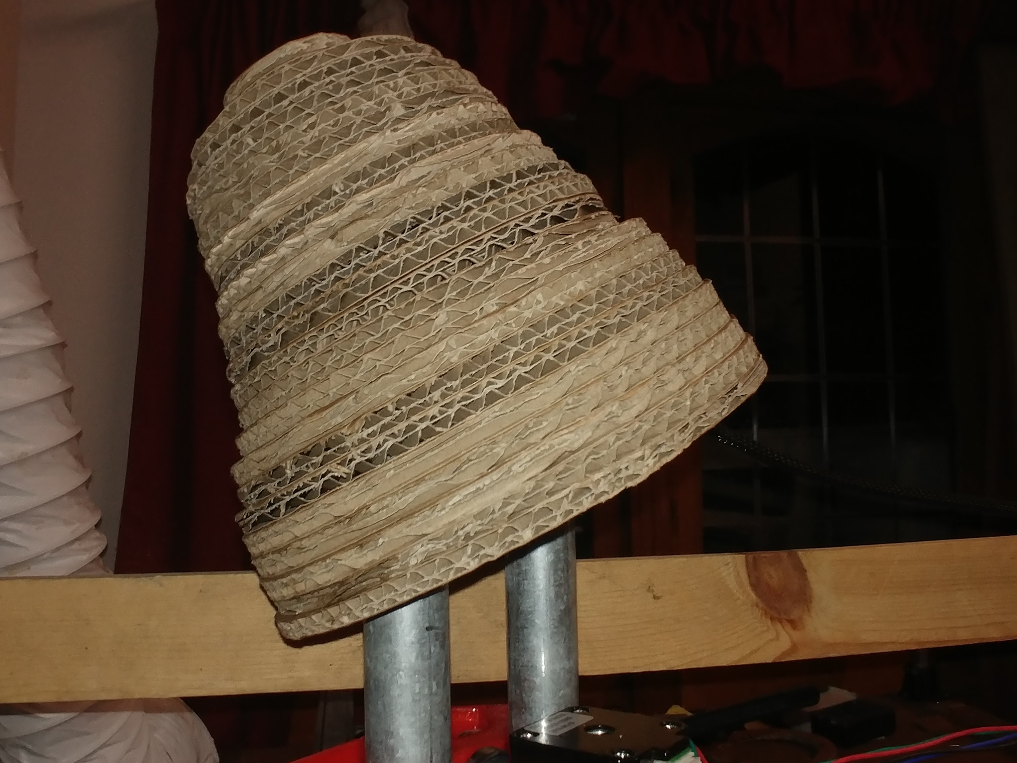

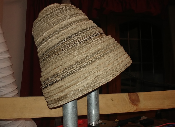

Here’s a quick little scraplight style lampshade.
[attachment file=48230]

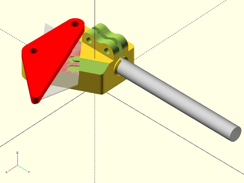

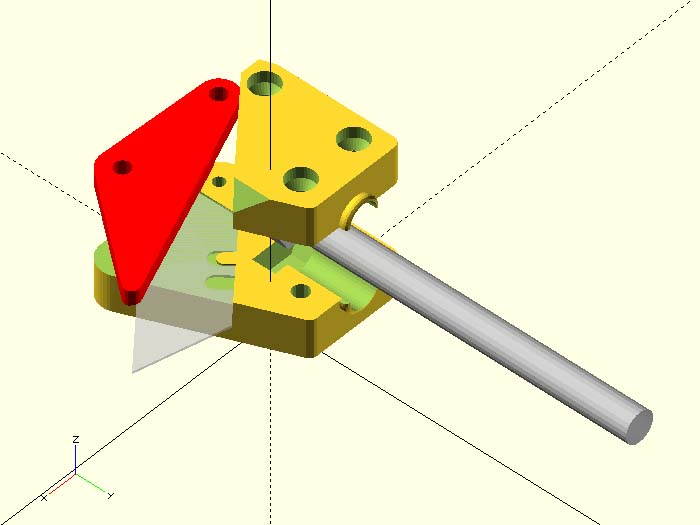

I am not sure if this is what you had in mind, but after thinking about your comment about shortening the top of the blade assembly, I came up with a simple solution. Since I moved the bolt head down 20mm, I did not see any reason the whole blade holder mount could not be shortened that amount. You can then still use the same M8x70mm bolt. That puts the blade 20mm closer to the machine mount. I uploaded the shorter version MPCNC_TN_ShortBlade_Holder_Rev22.stl and openscad file to the thingiverse. I might could shorten it another 2mm, but that is probably not worth the bother. This also gave me an idea of how I might be able to shorten my machine mount design.
Here is what it looks like.
That is exactly what I had in mind. This is the one I will print and try out, thanks. I really think this will help with the lever effect. The bolt is stabilised most by the two bearings, so the closer to those the better. It would be better if was a better fit so there was no slop inside the bearings. I have moved to a smooth rod threaded at one end, which is much better than having the threads inside the skate bearings, both for slop, and for vertical friction.

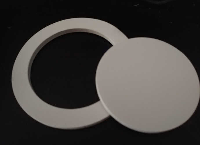

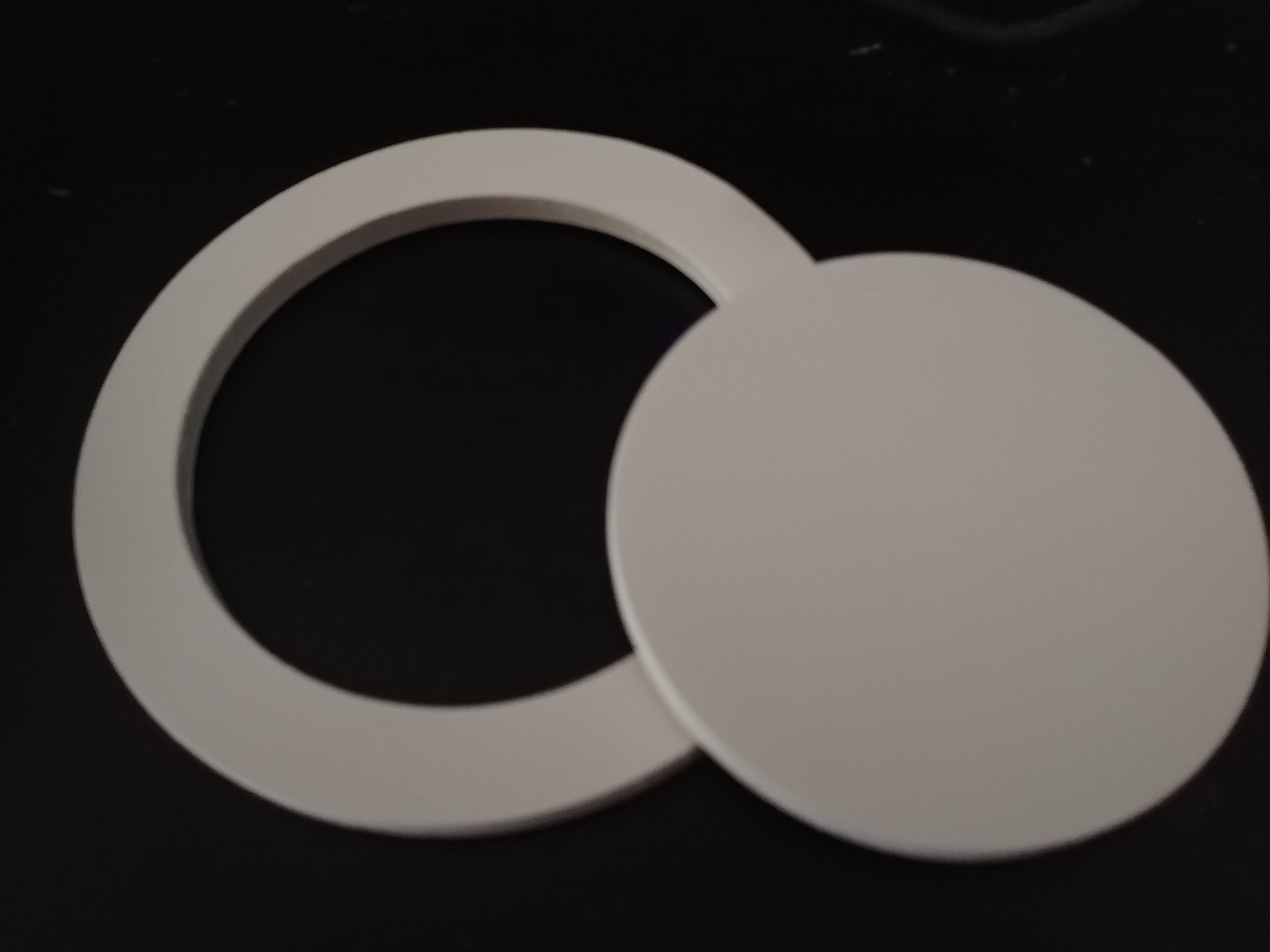

First attempt at foam board, success. Looks like it will be easier and faster than the thick cardboard for those wanting to cut this stuff:
[attachment file=48257]

If smooth rod works better, I can make that blade holder & bolt clamp one part and add 1 or 2 tightening bolts similar to what is on the pineapple coupler. Probably could make that blade holder even shorter. I will take a look at that sometime today.
It does work better in terms of vertical travel, but there is still play as mentioned above. I had some 130mm bolts left from my MPCNC build which were smooth up to the last 3cm where they are threaded. I have cut the hex head off one of these, and mounted a nut in the blade holder, hence the shaft screws into the nut and is held at the other end just with the coupler. I still think the two skate bearing arrangement has to go. Perhaps my bearings are not engineered to a good tolerance, but there is about 5-10 degrees of play in the middle ring.
Edit: just re-checked. There is perhaps 2-4 degrees of play in the bearing, but adding to that the fact that the shaft is not a tight fit, there is 5-10 degrees overall. I think if you had a tight fitting metal tube the shaft passed through, probably with some grease, it would work better.
What about something like this for the blade holder using only 8mm Flat rod? We could make a simple clamp ring in place of the M8 nut above the skate bearings. This design shortens the design another 6mm or 26mm from the original design. I made that little bump where the M8 rod goes thru the holder is 0.5mm shorter so there is only .5mm overhang there until it goes to 45 degrees. I guess that bump kind of keeps the spring in place? I could probably make that holder less thick now since the M8 bolt head is no longer there. There is 6.3mm of plastic below the length of M8 rod & 2mm above it. Above it there is the clamp, so it really is more than that above it. The M8 rod extends into this holder 20.7mm. Is that enough distance into the holder?
I think this is the way to go yes, another good step forward. Losing the bolt head, thinner design, 20mm is enough in the holder given it will be clamped nice and tight.
The bump was there from the original design, but shouldn’t be needed for the spring I don’t think.
I think it will be good going to 8mm rod. My m8 bolts are measuring ~7.7mm at the smooth shaft.
As for the skate bearings, I’m pretty convinced your idea of PLA bushings is the way to go with the central bolt too. If I understand correctly, in your design, the form of the bushings is embedded in the parts. Given that PLA bushings have a shorter life, is it worth making them slide-in instead?

I will finalize that design after lunch & upload it to thingiverse along with a rod collar for the M8 nut replacement. The plastic bushings could be separate which probably would be better way for the reasons you stated. I have already made a customizable openscad version of those already.

I added the updated files to thingiverse. The files you want to use for this are MPCNC_TN_8mmRodBlade_Holder_Rev32.stl and M8_Rod_Collar_Rev1.stl or the associated openscad files. I printed them & they look pretty good. The blade clamp has not changed. I sized the holes for M3 on the tightening brackets. I will see if I can get the plastic bushing files cleaned up & add those to thingiverse. M3x12mm screws should be all you need for the blade clamp.
Cool, looks pretty close to optimal now. Will try it ASAP and let you know how it goes, thanks.
It was fun working on this. Thanks for getting this project started & getting most of the bugs out.

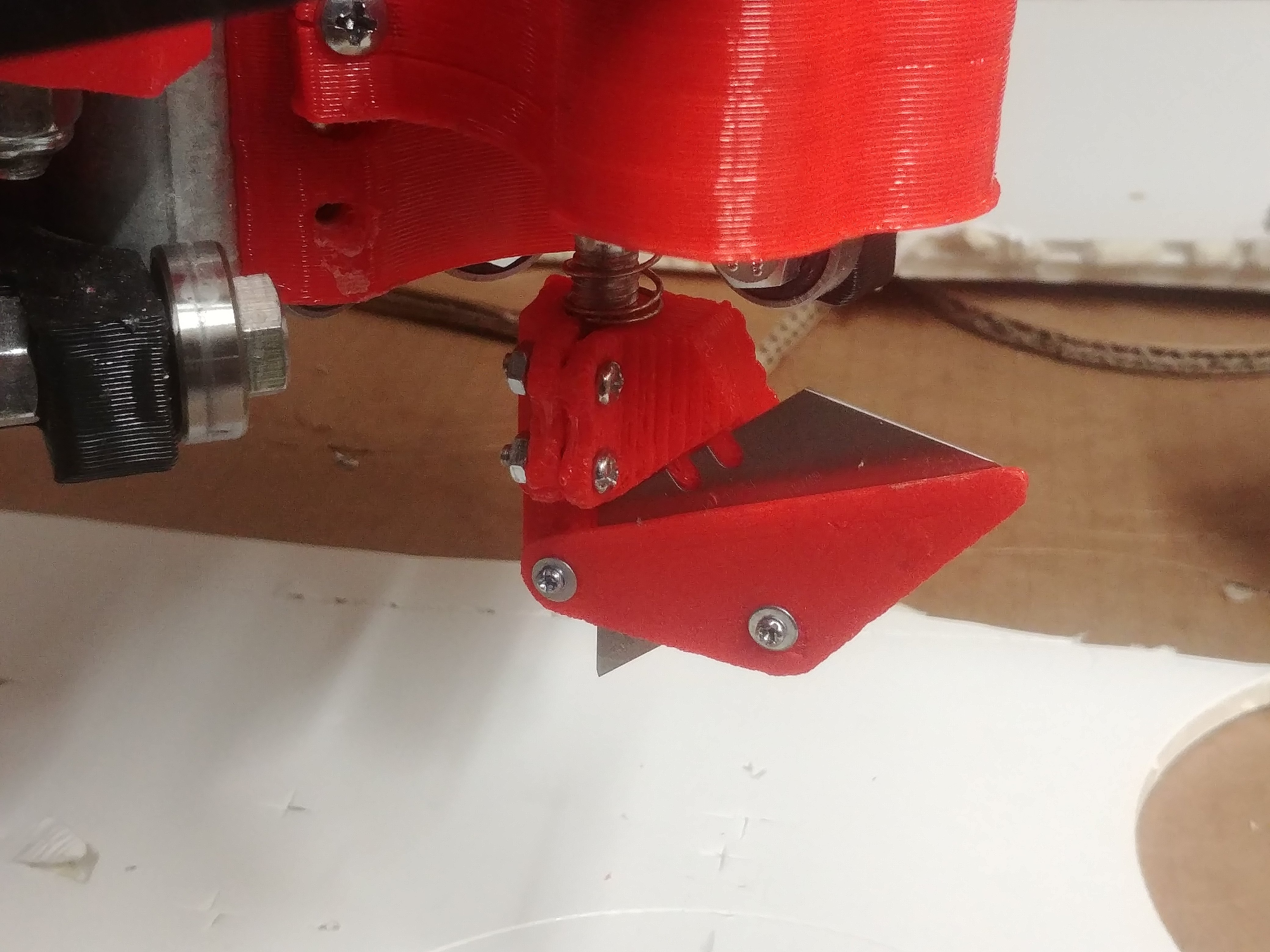

Good to hear. It’s been a rewarding project for me too, learned loads. Your blade holder is on my cutter now, and looking good. It’s a big improvement. It’s more rigid and has better blade positioning support. The end of the rode is about 40% closer to the blade tip, which is a big deal for rigidity. I also like the integrated blade guard for the back end. I’ve scratched the redesign job off my list!

Since I put the rigid alu coupler on and installed the new blade mount, my blade tip x/y tolerance has improved a lot. Watching the bushings updates closely, but I’m pretty happy with the accuracy now, so it’s not as urgent. I do want further improvements so please keep going with this.
