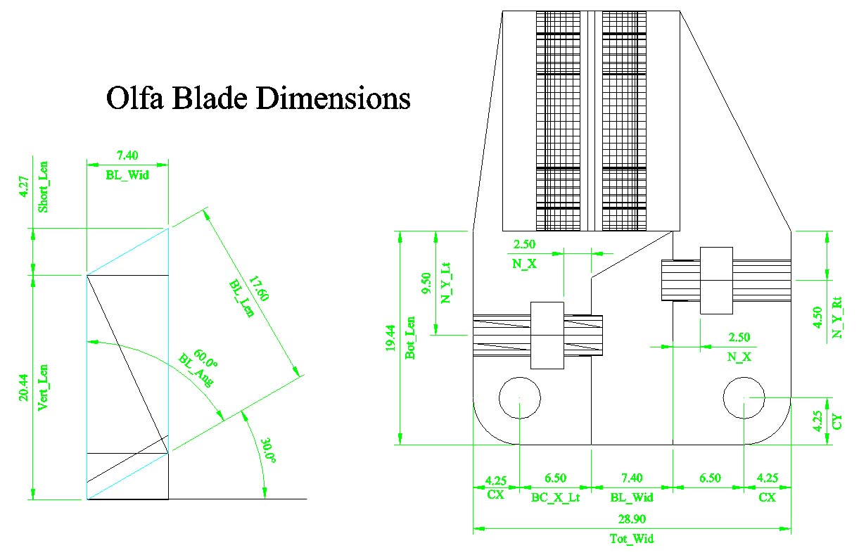

How about something like this? I have adjustments for the blade size and a few other dimensions. I have it set to use an M5 screw & Jam Nut as it seemed like a good size to use. A lock nut or regular nut will increase the height more. I have the shallow cut blade shown, but could use the steeper cut blade also. I show 2 views of it in one image. The m5 screw might not be necessary as I have the cutout for the blade at .3mm depth which should be the half the blade thickness. The cover itself might be enough to hold it. I guess the M5 screw would give the blade less chance of coming out.

What are the width of those blades, 9mm? The one’s I am using are 7.21mm & I add .2mm for clearance. I was thinking of using set screws along the side also, but dismissed that idea thinking that was not enough support. I then realized that might actually be a better idea & looks a lot better. The nut & screw are sandwiched between the cover & the holder. Here is what I am thinking. This is using 2 M3x12 screws with jam nuts.

I added MPCNC_TN_OlfaBladeHolder_Rev72.scad and an image showing dimensions for variables to https://www.thingiverse.com/thing:2661474
Here is a copy of the dimension image. The main dimensions you probably need to change are:
BL_Wid
BL_Len
BL_Ang
