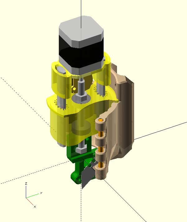

After leaving this alone for a week, I had some different ideas. I attached a couple of screen shots of what I came up with so far. Let me know if any of this will not work. I had to add 20mm to the height of the TN_machine_Mount insert for the blade to clear the bottom of the quick disconnect mount & therefore had to lengthen the M8 bolt to 90mm. I can find M8x90mm hex bolt caps screws from http://www.mrmetric.com/M40425 (They also have these in stainless, but are currently out of stock). I changed the 10mm rods to 8mm & made the mount with a plastic bushing for them using the profile of Drylin_Bushing_v2.stl from https://www.thingiverse.com/thing:1871890 . I measure 5.5mm from the bottom 608ZZ bearing to top edged bump of the TN_Blade_holder.stl for the spring adjustment. Is that enough gap? I put the 8mm smooth rod on each side & below below motor to give me more space to work with & those rods are now 100mm instead of 120mm. Will that work ok that way? Is adding 20mm to the length of the M8 bolt going to make it less stable. Seems like moving the M8 rod connections below the motor should give it more stability. I probably need to add kind of a fillet weld where the M8 flat rod connection is on the motor mount to make it more solid. Using the plastic bushings, I might have room to use M10 rod. In the screen shots, I just noticed I need to shift the blade up to the other notch on the blade, but it still fits in the design.
Great to see, although I’m not able to understand all the changes so far. I love the plastic bushings - I might try those out, and its great if we can get rid of the linear bearings.
I looked at an arrangement where the guide rods are either side of the A axis, but went with my solution to avoid too much width and too much distance from the gantry. I doubt your changes would introduce any instability. As for the spring gap, it can be as small as you want as long as you get the right spring tension (adjustable better I expect). The actual travel in the Z direction is going to be very small.
I expect the area where we can usefully add stability will be in the lower blade holder assembly. It’s blade tip is too far from the bolt, and creates a lever effect reducing lateral blade stability. I want an Olfa snap off blade design like the TOCK has. Been thinking about somehow cutting a blade channel in the bolt itself. The mechanical stiffness between blade tip and bolt is a key weakness of the current design.

After reading some comments on that 3d printed Drylin bushing, I am not sure how well they will work 3d printed. I also wonder if that is a patented design & I should not use that idea in my remix even though there is that design on thingiverse using it. I have a 7.5mm carbon arrow I bought from Walmart awhile back & might try creating a single bushing to test it with. I have enough room to put 2 bushings on one side & if I used carbon fiber I might use it this way as shown in the attached image.

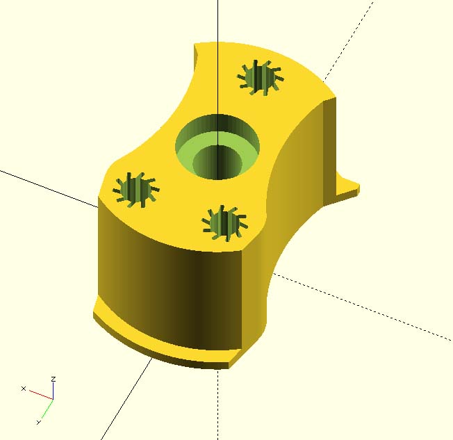

Cool. I printed one of these bushings sized for the 7.5mm carbon fiber arrow I have & it seems to work well. Since it is all vertical movement I don’t think it is a problem wearing the plastic. I found a lot of various designs of those plastic bushings on thingiverse, so it does not seem a problem to use them. I made a customizable openscad design of the bushing to be able to test it for various sizes. After the fact, I found a couple of customizable designs on thingiverse. Just search for “bushing” on thingiverse to find them. Aafter seeing how well this works, A plastic shaft might work if it is thick enough. I am going to make a bushing to use an 8 sided oblong shaft so I can print it on a face & see how strong that is.
Great, I really look forward to hearing about your results. So to be clear, you’re going to try out an all PLA linear motion system based around a single shaft? I take it the 8 sides idea is to reduce the requirement to one shaft. If that works well it would be really sweet.
This is what I had in mind & putting like half 8 sided bolt head on the top so it could just be held in with gravity. Or if that does not work, secure each shaft thru the side of the motor mount with a M3 screws. M3 screws would probably be easier. I don’t really want to superglue into the motor mount.

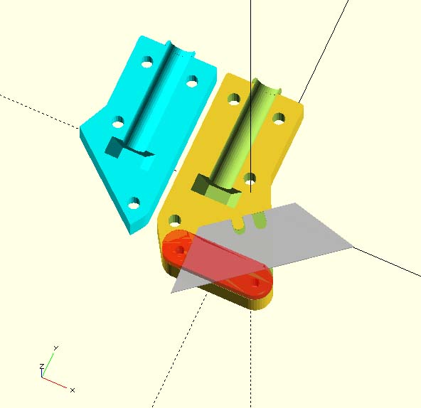

Since the drag knife part is the weakest link, how about changing the design of that part to move the M8 bolt head closer to the knife blade? Looks like you could move it 10 to 20mm closer, but of course would need a longer bolt.
I decided to take a look at the blade holder & associated parts & this is what I came up with. I made the M8 bolt connect 20mm lower which would lengthen that bolt. I could easily change that to a shorter length. I did not add that ridge that you have to match the holder and bolt clamp, but did add a 4th screw to hold those together. Seems like having the bolt head closer to the cutter should make it more rigid. What do you think?

Thanks for the progress, yes, shortening blade tip to bearing (fulcrum) distance will definitely help.
The ridge was inherited from remixes of remixes, but it does support the positive location of the blade tip. When your offset is anything from < 1mm to 4mm like a drag knife, this is useful enough, but when you are looking for perfect alignment between centre of A axis and blade tip, I see it as important.

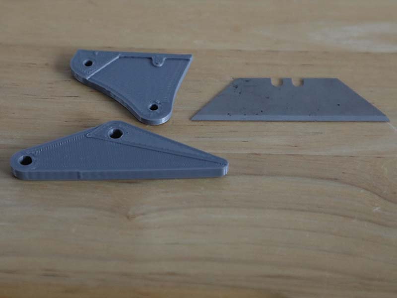

I have been printing some test prints of the bottom part the blade holder and blade clamp to see how it looks and feels. After the 4th test print, it looks ok as you can see from attached photos. I will put this remix on thingiverse after I cleanup the openscad file some. I made the clamp a little longer to cover the blade edge to the end & give a ledge to bear against the blade. I also made it so I only have to take one screw out to change the blade. I need to adjust my infill orientation, but left it alone for the test prints. These test prints only take 17 minutes to print.
I made the blade holder so you can adjust for 0 to 20mm extra length on the M8 bolt. That way someone can test it if they are using the M8x70mm screw.
I am using Stanley box cutter blades, but in my research in looking for standard dimensions of these blades, seems like they are not all the same for this style blade.
