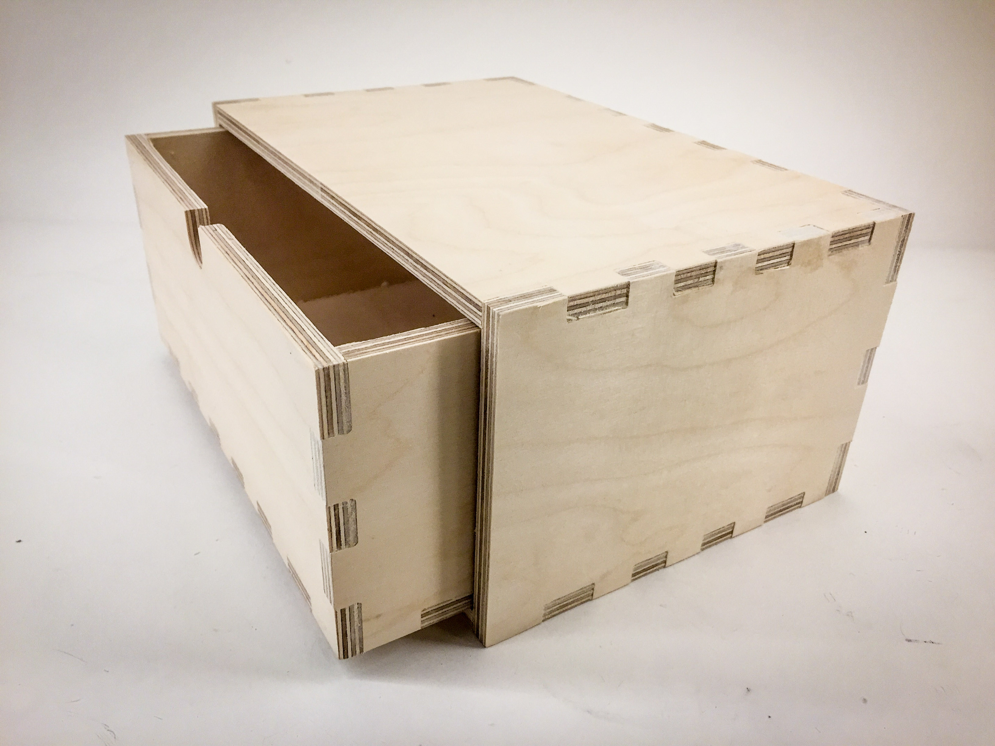

When the cuts started coming out accurate enough, I was able to assemble the stand.
I will still need to figure out the proper dog bone hole diameter, as the endmill is making strange sounds when it enters the hole. I used 6.5mm for the 6mm endmill.

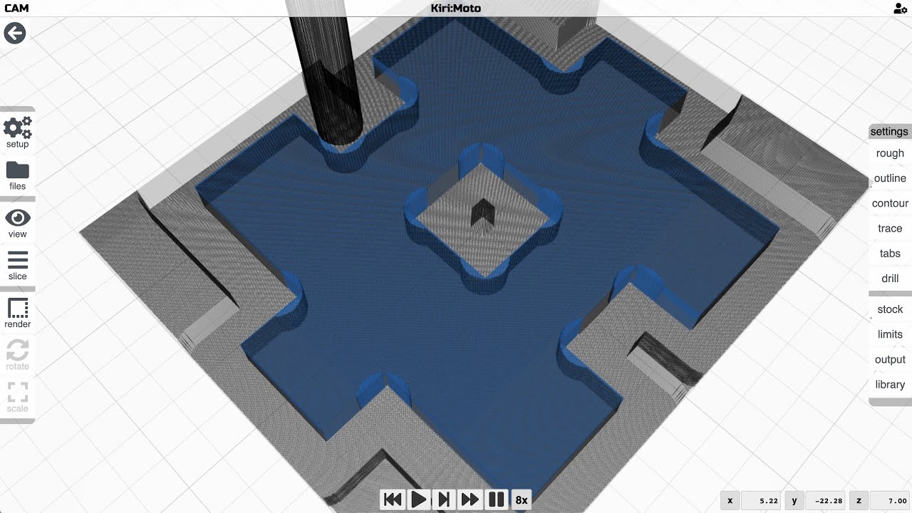

And they are built in to Kiri:Moto so no need to draw them in your CAD program. just tick the “dogbones” box and watch the magic happen! :wink:

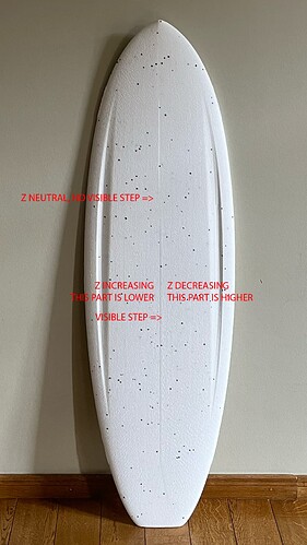

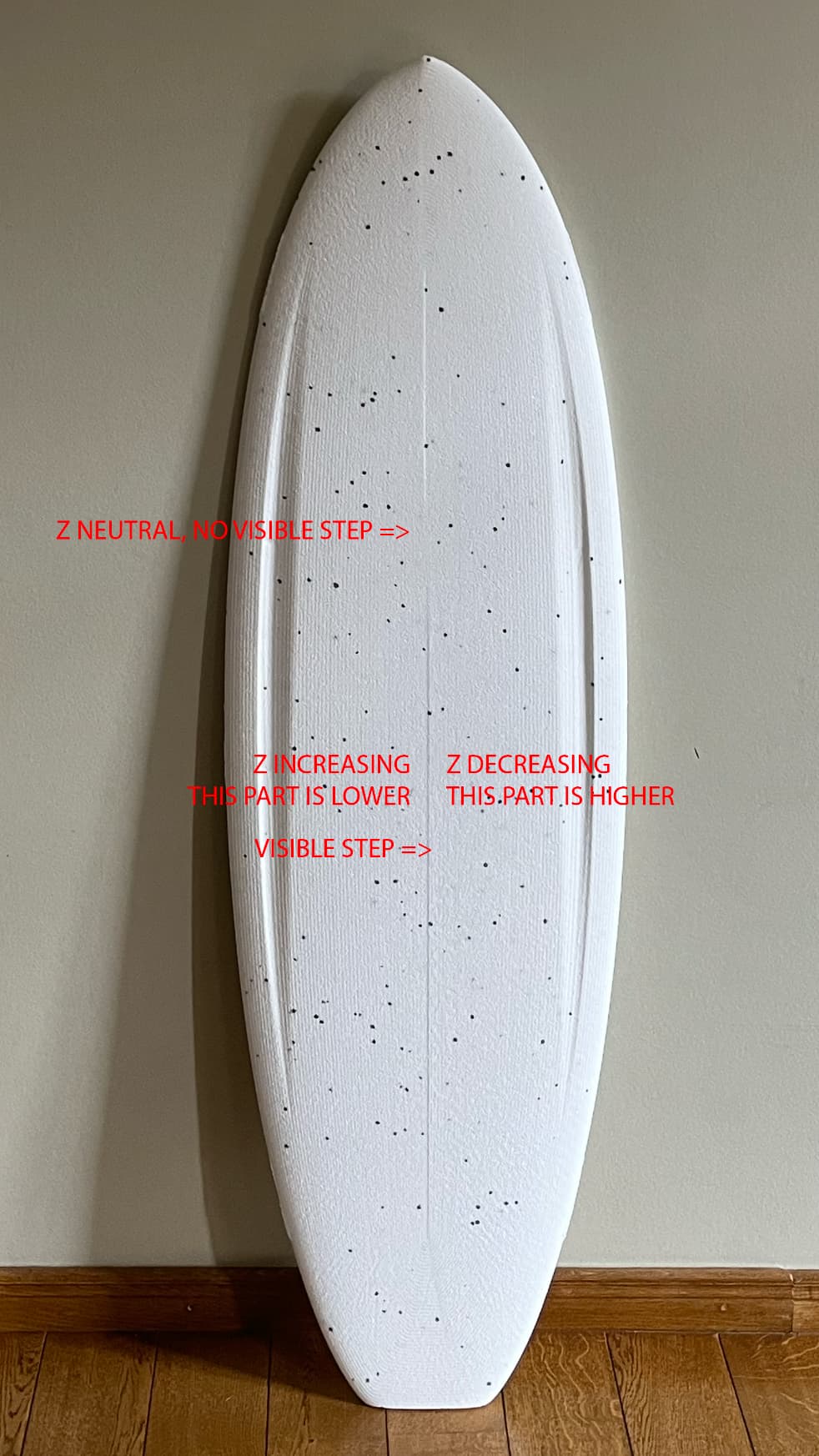

I’ve been out of the country for 6 months and my LR3 was left to rust in the basement during this time. I am now back to cutting my boards (did 4-5 last month) and it’s going pretty well. One minor issue I noticed is that there is probably some slack in the Z axis and I can’t figure out where it’s coming from.
If you look at the pic, there is a visible step at the center of the board. At the bottom, the right side is slightly higher than the left side. At the top, it’s the other way around. The step is not big, maybe around 1mm or so. My first thought was that I moved the stock by accident, but I now have at least 3 boards with the same step and it’s becoming obvious that this is an issue with the machine. The deck of the board is completely flat in the model.
The cutting program is a morphed spiral generated by Fusion 360. The endmill is basically spiralling around the center of the board in CCW direction, doing really long ellipse shaped passes.
I think that there is a little play somewhere in the Z axis, and the endmill ends up in a different position depending where Z is travelling from. I’m pretty sure that if I reverse the direction of the spiral, the step would get mirrored as well.
Not really a big issue, but I would appreciate any ideas if you’ve experienced anything similar.
Check the grub screws. :slightly_smiling_face:
With that step being at the exact center line, I have a feeling it is CAM related. Try opening your gcode file in a gcode visualizer to see if it shows up. You can add a finishing pass as an XY direction to just that section of your board to level it out.

Philip is probably right, though, The coupler grub screws are a prime suspect. As well as hitting your Z bearings with a light lube.

The step is right in the center because … how do I explain this in English… this is where the opposite direction lines meet. On the left side, the endmill is traveling nose to tail, and on the right side the endmill is travelling from tail to nose. Z axis travel also becomes opposite, which creates the step I think. I will double check the gcode. The model is completely flat in the render:

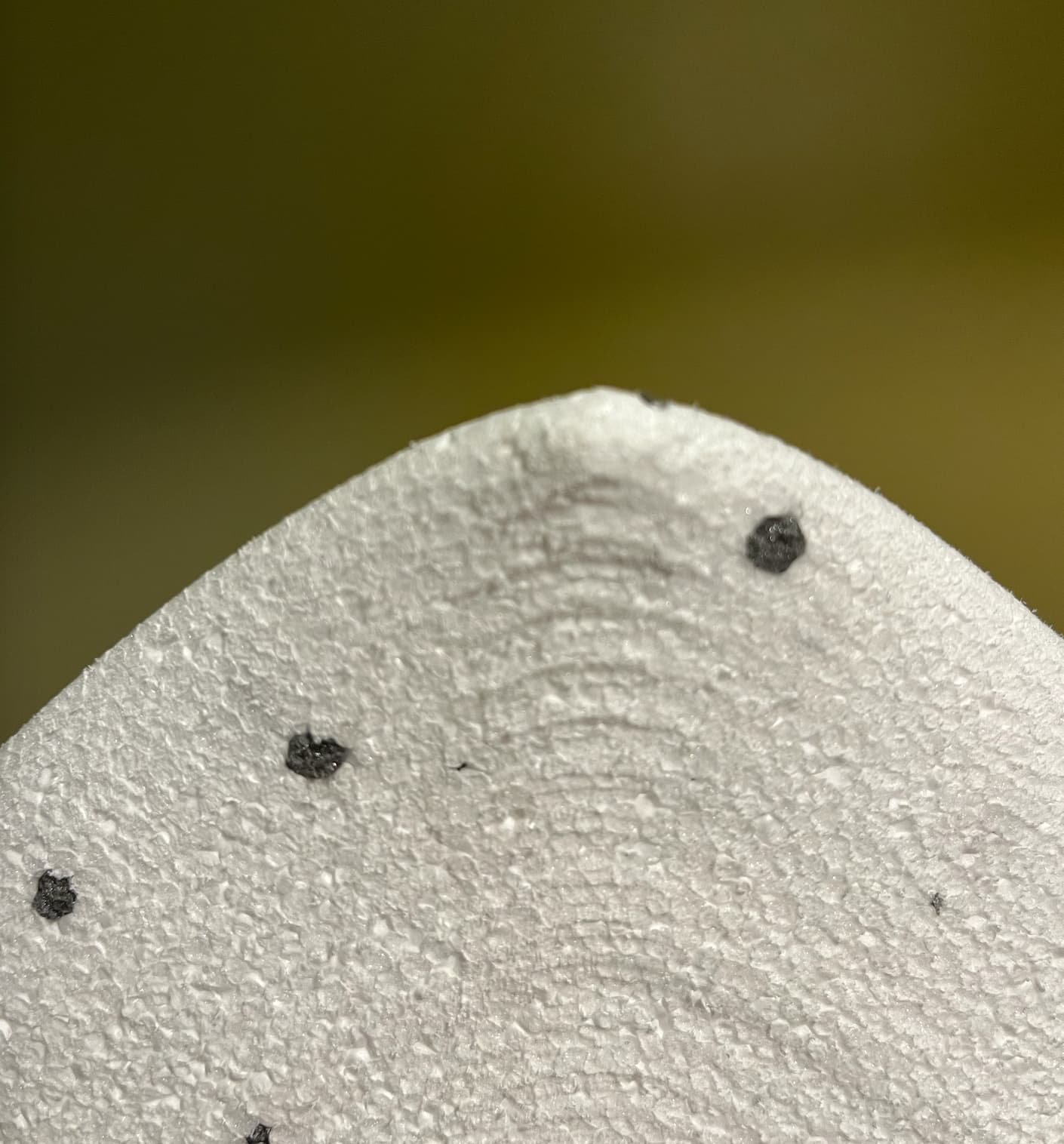

This is probably just a poor photo quality or a shadow that you are seeing. Here is a more close up pic:
Yeah, gut reaction is that if the issue is at the inflection point where the Z-axis travel is changing direction, you likely have a loose grub screw or two. That might explain the apparent backlash (too low on the way up, too high on the way down). That, or your couplers have gotten… springy.
