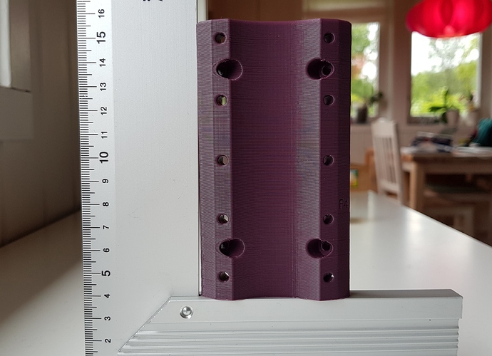

My printing is progressing slow and steady. Right now only the tall parts remain. I just printed the tool mount, and I noticed a sliight skew in the print… aye caramba, this project has a long learning curve!
What can cause this? The bed is levelled thouroughly and no warping or obvious shifting has happened. Can it be y-belt that’s not properly tightened? Or is the y-axis not perpendicular to the bed? I thought it would be all right when it’s levelled correctly?
I also wonder if this is too much distortion to make it work with the pipes. I will know for sure in time…
[attachment file=107052]
Edit: I got useful help from a ender-3 board. They figured out what was wrong - the vertical axises was not 90 degrees on the horisontal plane! That explains the whole parallellogram-shape. It’s too obvious when you realize it. Now I’m trying to adjust, but the whole thing is a little wobbly and unstable. I’m positive I’ll figure it out in the end. I bought the printer used, and have had many issues with it. It’s annoying, but a good learning figuring out the kinks!!

Also - it looks like you’re using the bottom of the part as the reference, does that skew show up in the hole patterns? Maybe this is a bed leveling issue. Maybe try installing long screws (with nuts) into the 4 mounting locations and see how square the hole pattern is?
Your printer is not square. Chances are good your Z smooth rods are not right. I really suggest not printing any MPCNC parts until you fix the printer as that is a very large error.
Test your printer buy printing a very large cube and measuring the edge diagonals in every direction. Normal “calibration” prints are only testing steps per mm, not the actual machine.
Thanks Ryan. You are (not suprisingly) correct! I adjusted the vertical axises their sideways direction, had to lay in some aluminium foil under the right side of the axis bottoms to get them square. What I DIDN’T measure and fix, stupidly enough, is the y-direction of the vertical axis, since it didn’t seemed skewed that way. I have printed a big test tower, and it seems fine in all directions, but I made it with the sideways direction in mind. Thank you for learningful input - this is sure a journey full of new knowledge…

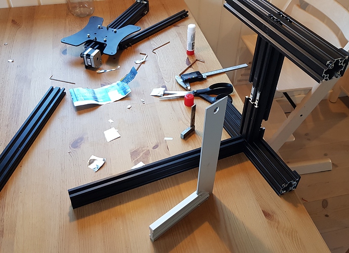

Ahhh - dear sweet mother of… reminder to self! Don’t buy cheap 3d-printers used… I’ve jumped down the rabbit hole, trying to get the axises perfectly square. They are not square at all, no matter how much I try to loosen and tightend each of the two screws - from the underside. SO WHAT DO I DO? I get down and dirty and do my best with small aluminium shims, from foil and drink cans. The digital caliper sure comes handy now. Should the shim be 0.1 mm or 0.07 or 0.05?? It makes a huge difference when trying to get something square! One down, over the rainbow, my printer will be kind to me - and I will finally get to assemble the MPCNC.
