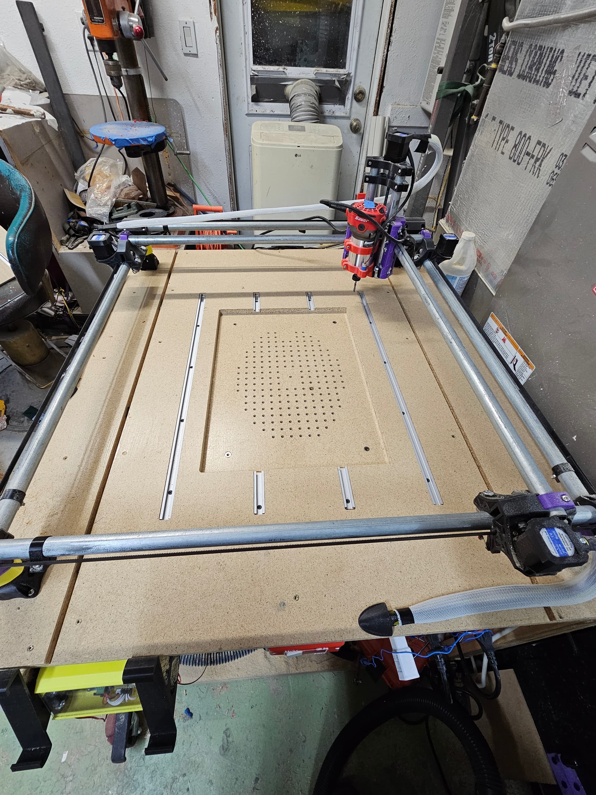

Mine.
Are you satisfied with your table?
I’ve made a few additions to it, it’s working well now.
Looks really good. What t-tracks are you using?
And what do you think about 3d printed t-tracks?
Aluminum, I picked them up on amazon so no brand that I’m aware of. You could try the 3d printed ones but I don’t think they would be very smooth when the bolts are sliding through unless you can print without any supports on the inside or spend a lot of time sanding in there. In any case I think you’ll want to go really thick/strong on the top as I can see pulling through the top as you’re clamping down.
The xcarve I was using used carved tracks through the mdf. I have to shove a flat head screw driver into the track until the tbolt starts to grip the top, otherwise most places are beaten up enough it just spins and irritates me. And the bit to do it was about the price of the aluminum tracks so it was an easy decision for me.
