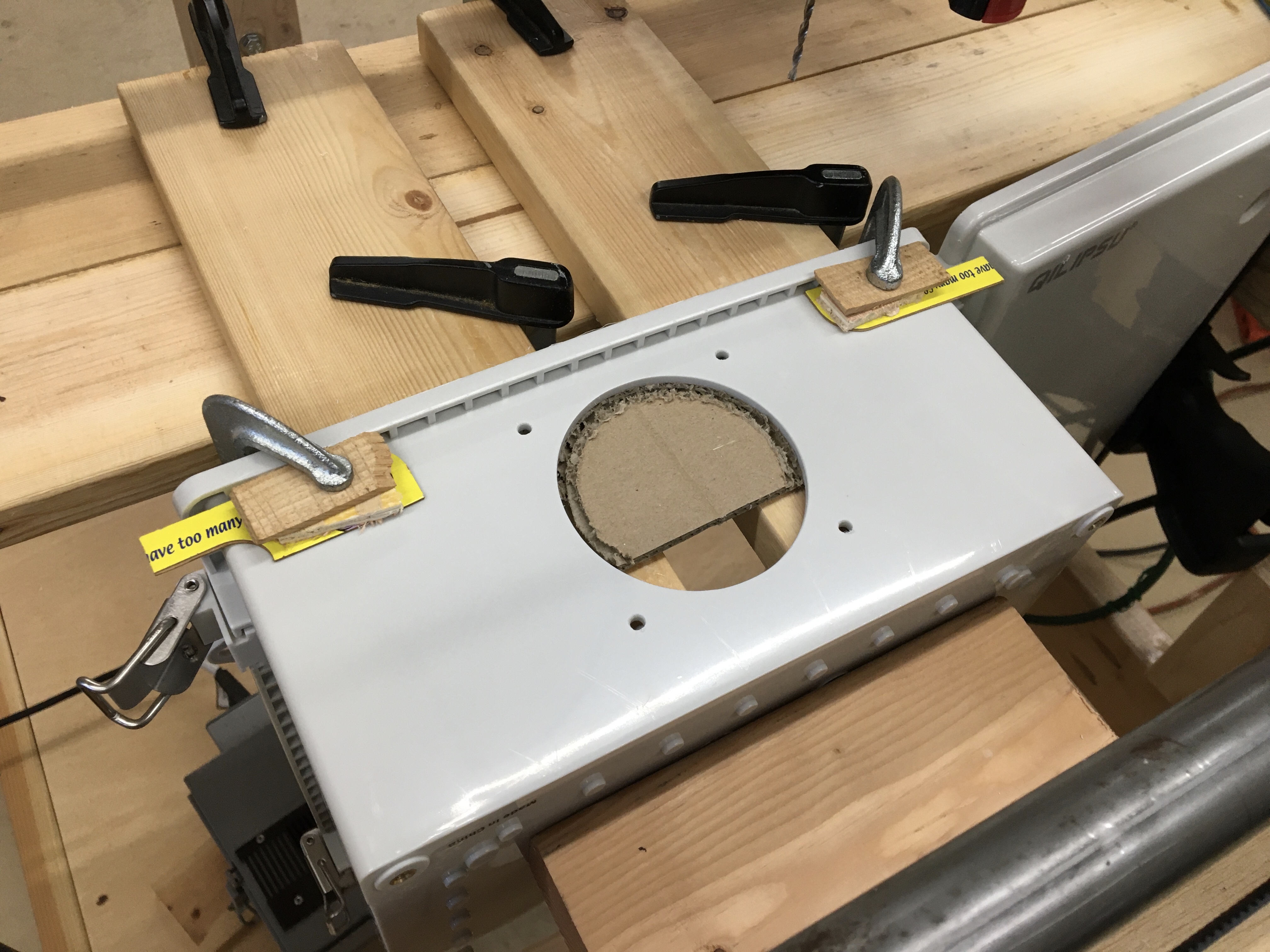

I needed to cut some holes in multiple sides of an ABS junction box that I purchased for a work project. The overall box dimensions are 350mm x 270mm x 150mm (14.6” x 10.6” x 5.9”).
I dropped the table about ~150mm (~6”) for the first operation
and bored out the E-Stop hole.
I then removed the elevator board from my table (to get a more stable mounting surface in the next areas to be machined), clamped the enclosure down to the table with a few 1x4 boards and machined the aviation connector holes.
I then rotated the enclosure 90deg
and cut the intake fan opening.
Finally, I rotated the enclosure 180deg and machined the power, exhaust and USB openings.
