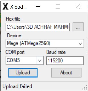

Hello, I have an uncommon problem and I can’t find a solution to it, I need help from an expert or someone who knows how to solve it

It looks like you’re trying to flash firmware to an ATMega2560.
What type of device are you trying to flash?
Where did you get the firmware that you are trying to flash?
What filename is it?
What kind of V1 machine are you trying to get running with that flash?
Why did the device need to be flashed in the first place?
The device type is a SUNLU S8 PLUS 3D printer and I am trying to add a BL TOUCH sensor to it. All these steps that I did before, you can see them here 🔧 BLTouch Holder and firmware Marlin 2.1.1 for SUNLU S8・Free 3D File for ・Cults and the program as well. The reason for installing this sensor is its accuracy in leveling the floor

generically, back when we were working with old RAMPS boards, XLOADER upload failures were generally of three types- bad driver, something else like a sender or slicer having the port open, or a bad connection to the target device.
You may want to reinstall the windows driver, reboot windows and attempt again after confirming no other softis running, and double check that when you connect your device a COM port shows up in device manager.

Not sure about the Sunlu in particular, but serial file transfers in general can fail due to a number of reasons.
  • incorrect Baud rate
  • incorrect file transfer protocol (XModem vs YModem vs other)
  • Incorrect COM port selection
  • Incompatible file type
  • COM port in use by other program
  • Faulty serial cable or incorrect pinouts
The first step is usually to establish and confirm a working serial connection to the device from your computer’s serial interface program. Once you can see the commands echo from the device, then you’ve eliminated 4 of the items, and are left with incompatible file type or incorrect file transfer program.

  • Did you successfully install the drivers first?
  • Have you confirmed that the newly installed drivers are COM 5?
  • Did you unzip the Xloader file first, or did you try to run the program from the zip file itself?
I work on the “XLOADER” program, it does not require specifying the Protocol, and I followed all the steps mentioned on YouTube.
