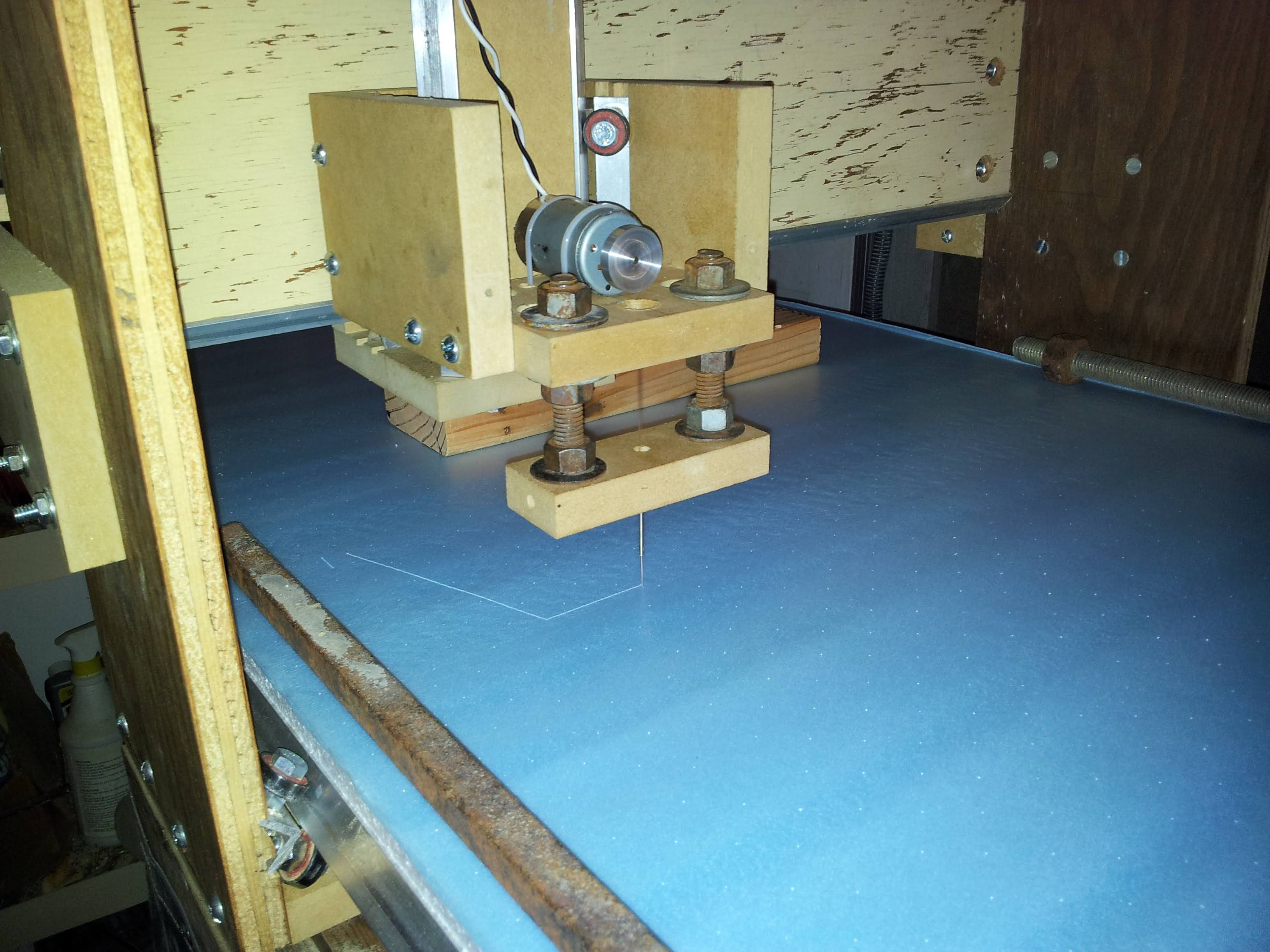

A blast from the past… BuildYourCNC, early needle cutter, bluecore foamboard, and LinuxCNC! Styrofoam insulation panels made for perfect spoilboard for cutting RC planes/parts with needle cutter…

I was using 0.8mm router bit. I built a needle cutter, but never got it to work right. I was frustrated enough that I just tried with the 0.8mm bit, and it worked fine. The edges were slightly fuzzy, but other than that, no issues. The needle cutter is in my pile of “someday” projects. If I end up with a stack of foamboard to cut, I’ll revisit it.
Also built a needle cutter, but wasnt happy with my results. Ended up cutting black foam with a laser. Re-trying the needle cutter is on the list, I also have 0.6mm cutters for the CNC that I may end up trying. I think I bought those for PCB milling…
A needle cutter certainly can be fiddly to set up… but they usually can be made to work reliably once that’s done. My earlier ones were actually the simplest and cut “miles” of bluecore and DT foam with just a DC motor from a junked HP printer, a small disc of aluminum, and a ball-inflation needle for a guide…
The later introduction of brushless RC motors, 3d printed frames/parts, and various bearing guides introduced a bit more complexity (though they’re still quite simple) and made them a bit more fiddly and less robust than those early ones. But those early all-wooden and metal ones were most forgiving and almost immune to construction issues often seen with later versions. Longer needles with shallow bend angles and lower RPM’s and feedrates let them run longer and with less stress.
