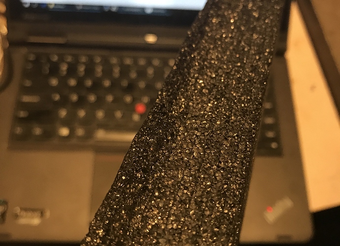

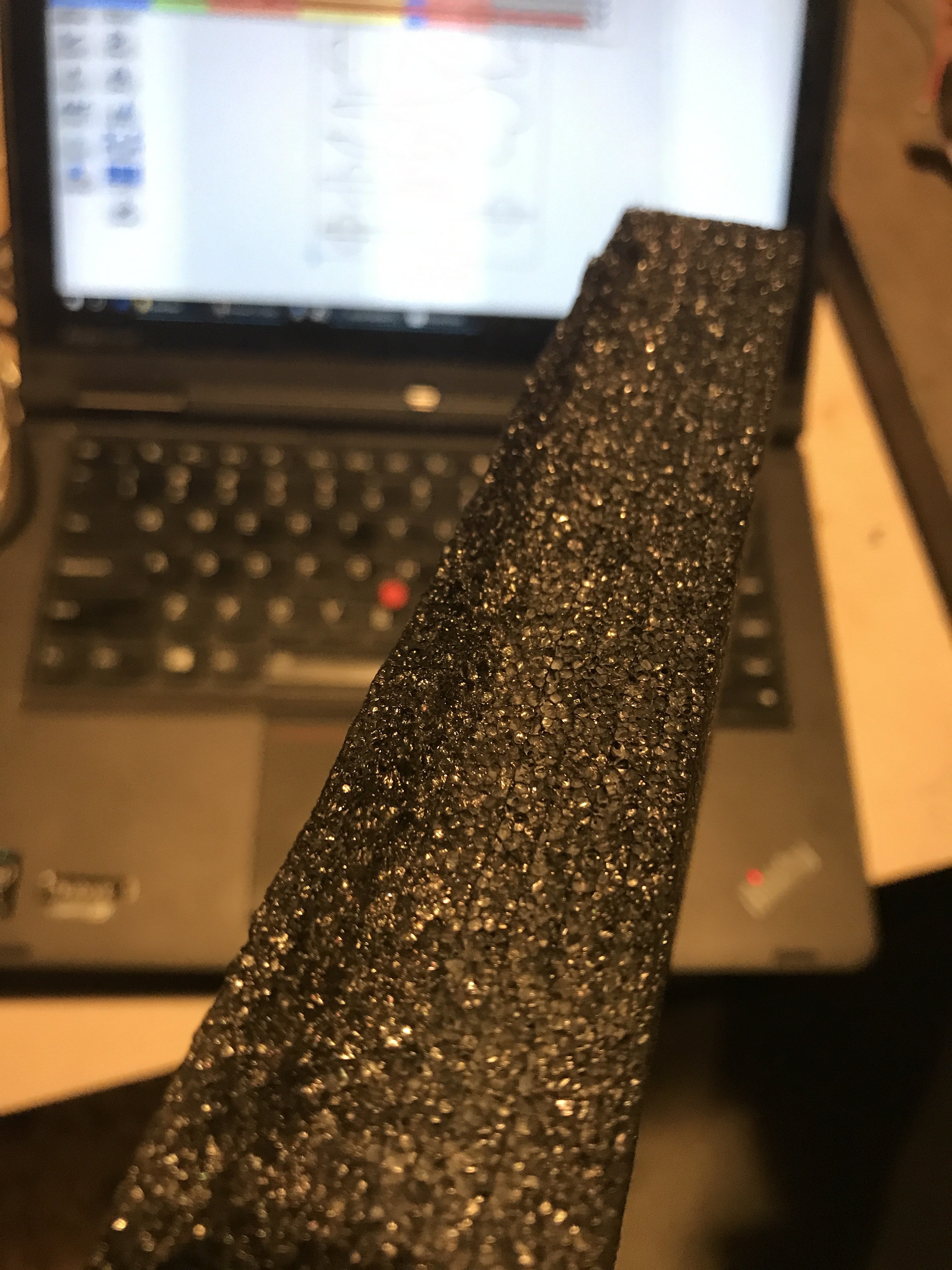

Just to show what I was running into at slow speeds and full power. I was able to cut the same material in 3 passes at 10 mm/s But it melted huge grooves into the material on each pass. Not sure if they will show in this pic but here are the grooves.

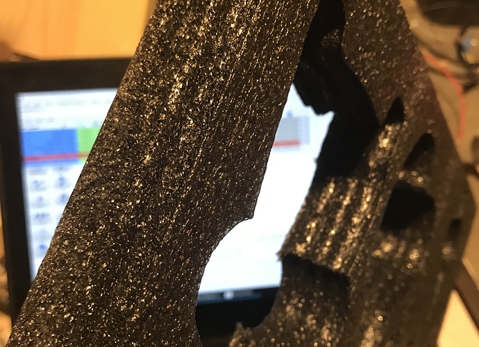

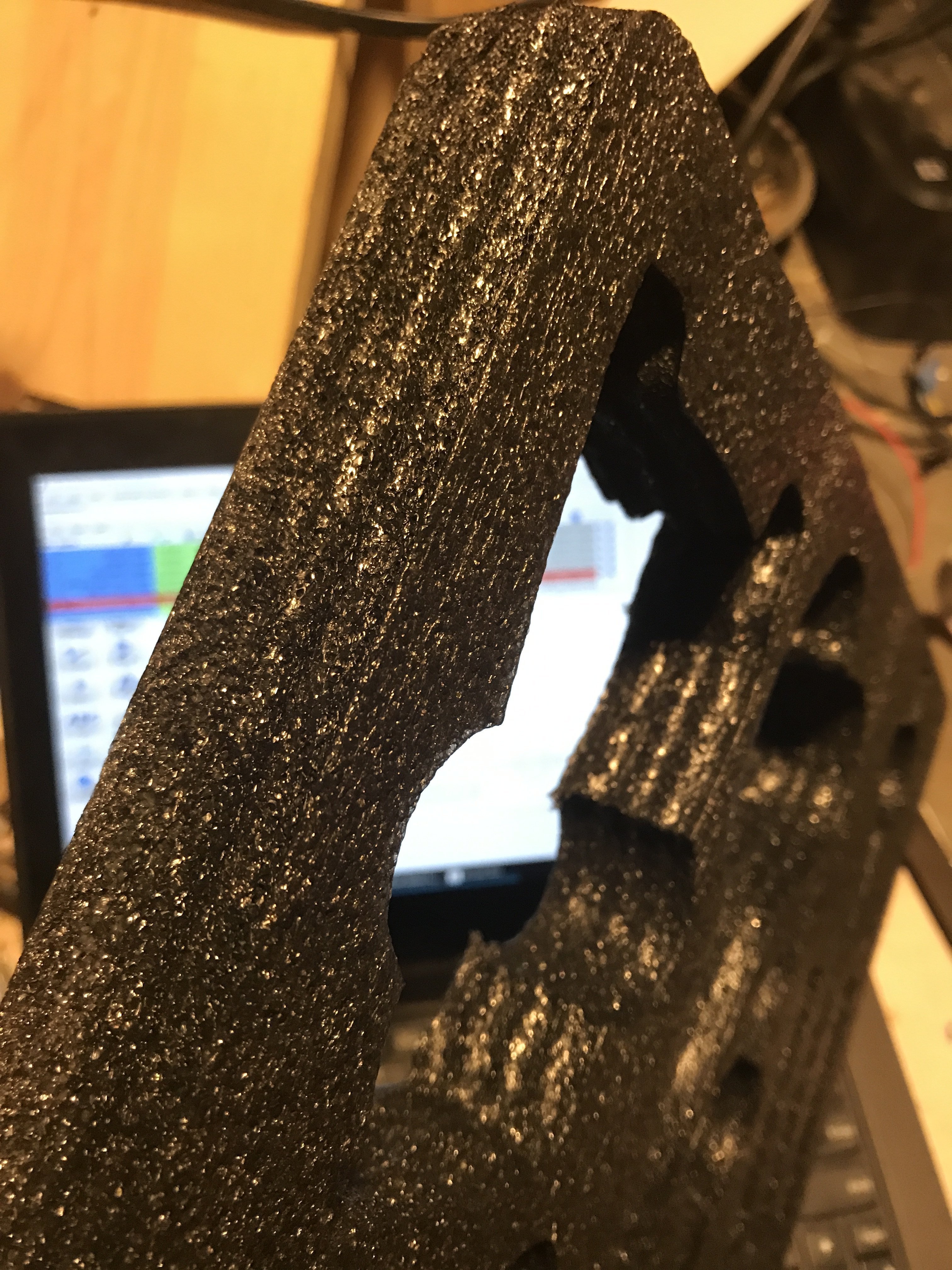

As I said before I am now running 70 mm/s at 120 power. This picture I only made 15 passes. I had to rip the foam the rest of the way. But the part that was cut is clean.

Yeah. I have learned that moving the laser down doesn’t help. It will only burn about 18 mm down and that’s it. I assume it is because the beam gets spread out onto the sides of the walls. So I am now getting clean cuts with 15 passes at 70 mm then a couple slower passes to make sure it cut through.
