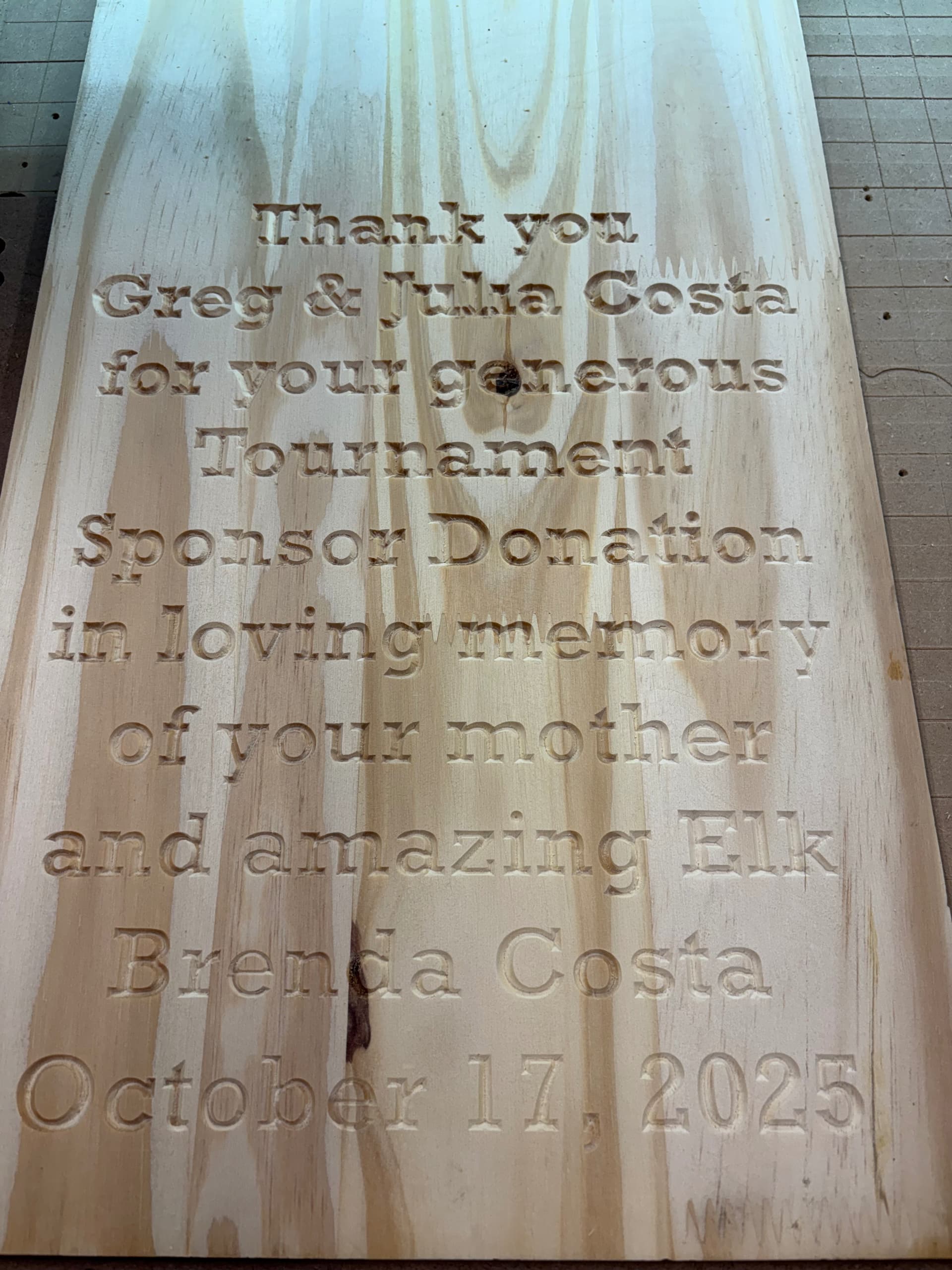

An odd thing happened today. 10 lines of text with a half inch wide 90° V groove on a 12 x 15 x 3/8” thick plank.
Issue: when I created the G code in Estlcam 11 to do all 10 lines of text in a single job beginning at the top left to the right then down from right to left progressing all the way down 10 lines ending near the 00 Mark, as it progressed down each line of text, the carving got deeper and deeper.

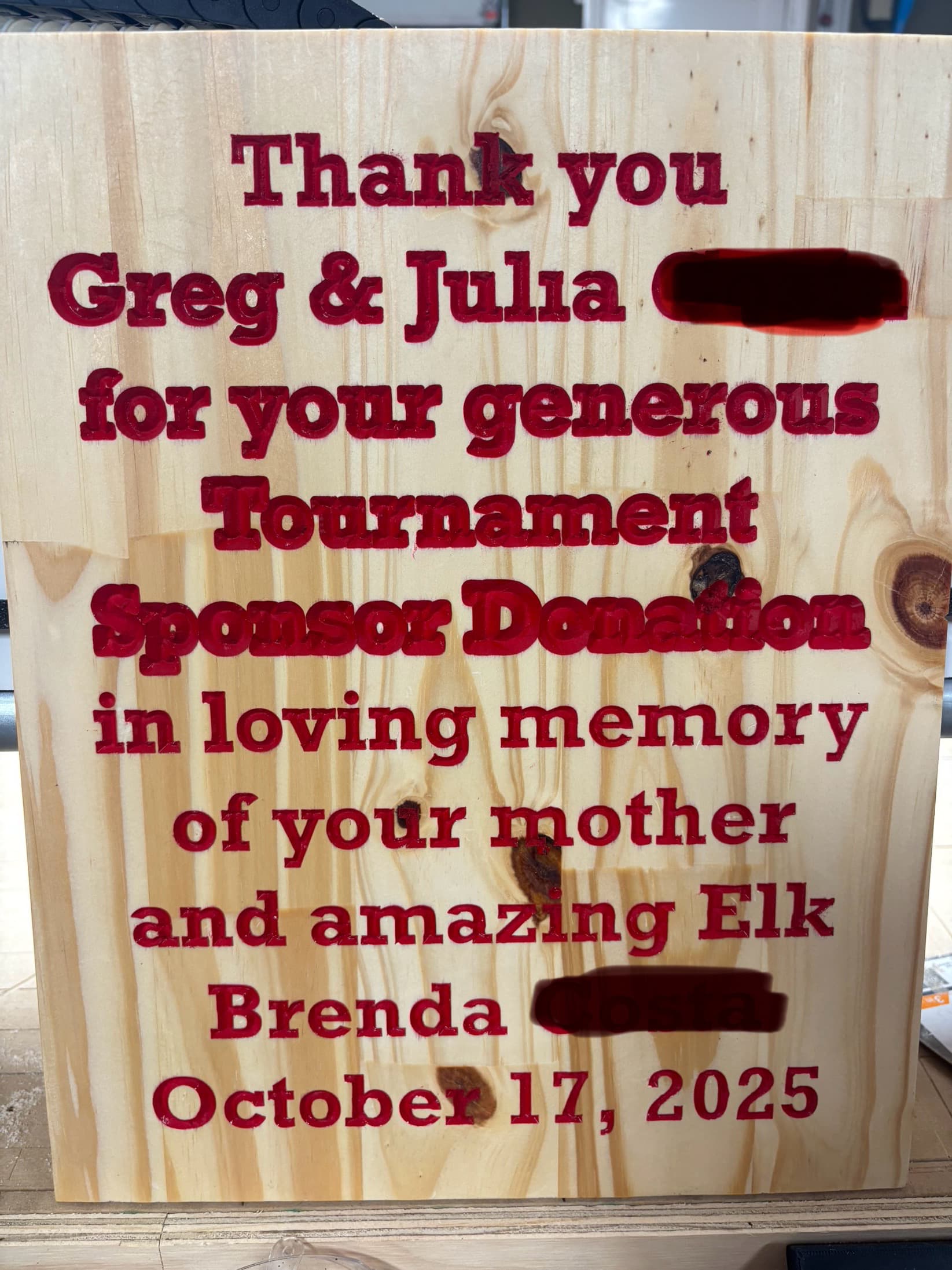

At first, I thought maybe it was time to resurface the spoil board maybe I had a high spot so I did that and it made no difference so I terminated the job after the line with the word donation. See the image I went ahead and painted the engraving, red and removed the mask for clarification of this issue
Nothing else changing other than saving the G code one line per job, beginning with “and loving memory” and a single line of text each thereafter. I ran each line below the word donation as a single job and I never even bothered to reprobe Z so it was at the same setting that the initial 10 line job would have run from.
This really has me stumped, doing a sentence One line at a time is fine doing the paragraph all 10 lines in a single job and the carving goes deeper as it gets further along the paragraph

You can see the super wide letters overlapping each other which is the line where I stopped the job. At that point, I did a single line ‘in loving memory’ and it was fine, and then I did ‘of your mother’ and that was fine, nothing else had changed in Estlcam other than doing one line at a time as separate jobs rather than all 10 lines as a single job.
This one’s truly a puzzle Anyone experienced anything remotely close to this?
when I did the last five lines independently, they looked great by comparison when I did the first five lines as a 10 line paragraph each one went deeper.

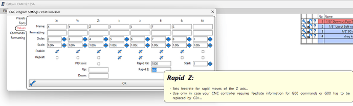

On my LR4 I was losing steps on Z when it was trying to lift too rapidly. Might be worth checking/adjusting as a test?

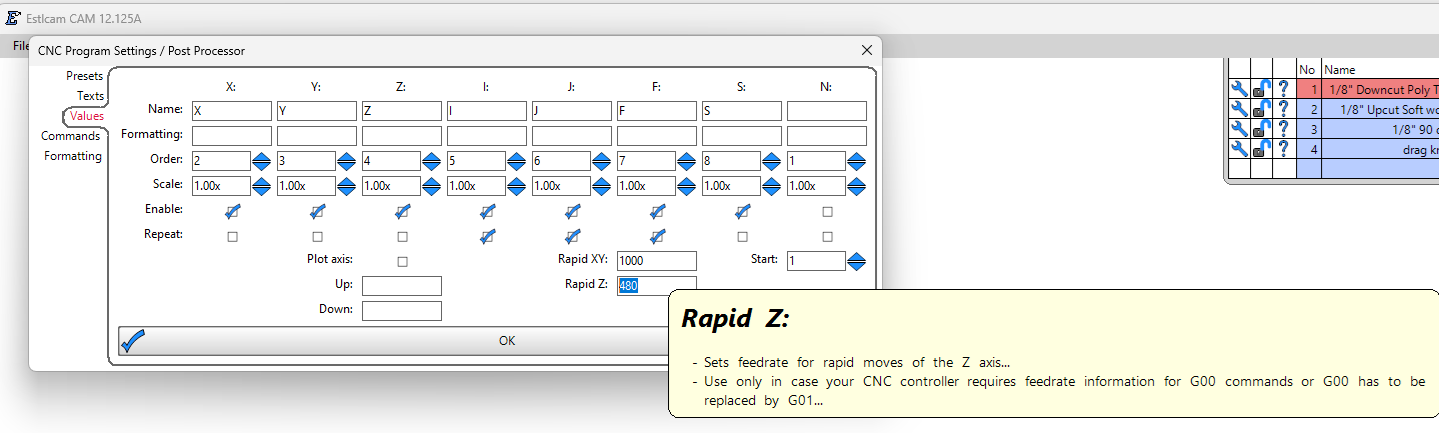

What depth does the gcode show for each line of text? If the gcode is correct, then it is highly likely you are skipping steps on the upward Z movement. That could be caused by too high of acceleration setting, or too fast of a Z travel setting
I can bet this is the solution, irc the default z rapids are 800mm/min+ that didn’t work for me
Mine are 2000 and it’s fine now. :sweat_smile:

Am using conservative Z Rapid 480mm/min, so a slow (and steady…) 8mm/s. My Z Plunges are even slower. I’m not cutting enough to care to tune the assembly, but probably should.
EstlCAM Setup - V1 Engineering Documentation docs contain a teeny tiny image with Z Rapid 900mm/min == 15mm/s
Sounds like you’re losing steps when gantry rises because of Z Rapids too fast for the combo of assembled friction, gantry weight and stepper current of your setup. So, consider ensuring leadscrews are aligned and lubed well. This a full width gantry with 4’ usable? What’s your current settings for Z axis steppers?
