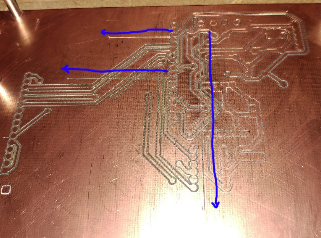

Hi, I have a strange issue happen while milling a pcb. I’ve restarted the job 3 or 4 times with similar results. The job start correctly but after some time seems to head towards 0 on either x or y axis. I’ve attached a picture to try and show what is happening (the line ends because I shut down the machine when I noticed this happening).
I have tried editing the gcode to omit the first part of the job and start maybe halfway, after some time the same result.
The sdcard checks out fine, I have transferred the file back to the PC and compared the gcode file to the original and it is identical. Opening the gcode file as a simulation in LinuxCNC shows that the file should render correctly.
Has anyone come across anything similar happening? These are the first jobs I have run since upgrading to the dual endstops with the latest marlin firmware linked. I had previously run many jobs with no issues at all, even after 8-10hour long jobs.

Check your power connection. I’ve had an intermittent power disruption do that exact thing to me.
I had that trouble too. (Didn’t really fix it though). I supposed that it coumld be radio interférences (in part from my chinese spindle + PSU), so I’d suggest first make sure the wires don’t overlap (especially long display seem problematic from what other posts with a similar problem I’ve seen)…

I had this exact same issue when i was using sdcards bigger than 2gb . I once tried to use one out of my 3d printer which has 8gb. My marlin recognised it, but some time into the job just glitched out.
I have double checked all the connections, they are fine. Polarity of the endstop wiring shouldn’t matter, but checked that and all switches are wired the same.
The smallest card I have is a 4GB, I reformatted this with just a 2GB partition and ran the job on the top side of the pcb, this worked fine. I then tried the reverse side with the gcode on this new card and this exhibited the same symptoms as before. I will try and dig out an actual 2GB or smaller card to check this.

The gcode is not how I would format it and 99% sure it is your problem. No spaces, too many decimal places, extremly high resolution per step, no speeds on each line.
Start with ESTLCam look at the gcode it produces, try to match that. 0.0001mm resolution is too high and you are probably trying to process way too much info. You also can not just change one speed it is embedded all over the file, and should preferably be on every single line.

After swapping out the arduino, ramps board, display for others I have laying around, the issue still remained. Reflashed the firmware and tried various other sdcards, the issue was still there. I also noticed that while running a job there seemed to be ‘clicks’ from the display unit, just like the button was being pressed.
Anyway, it turns out the issue is only present when the spindle is running at or near max speed, the higher the rpm, the more pronounced the issue. Presumably some form of EMI. Looks like I’ll have to upgrade the spindle.
Or shield and ground the wires and its spindle power supply.
