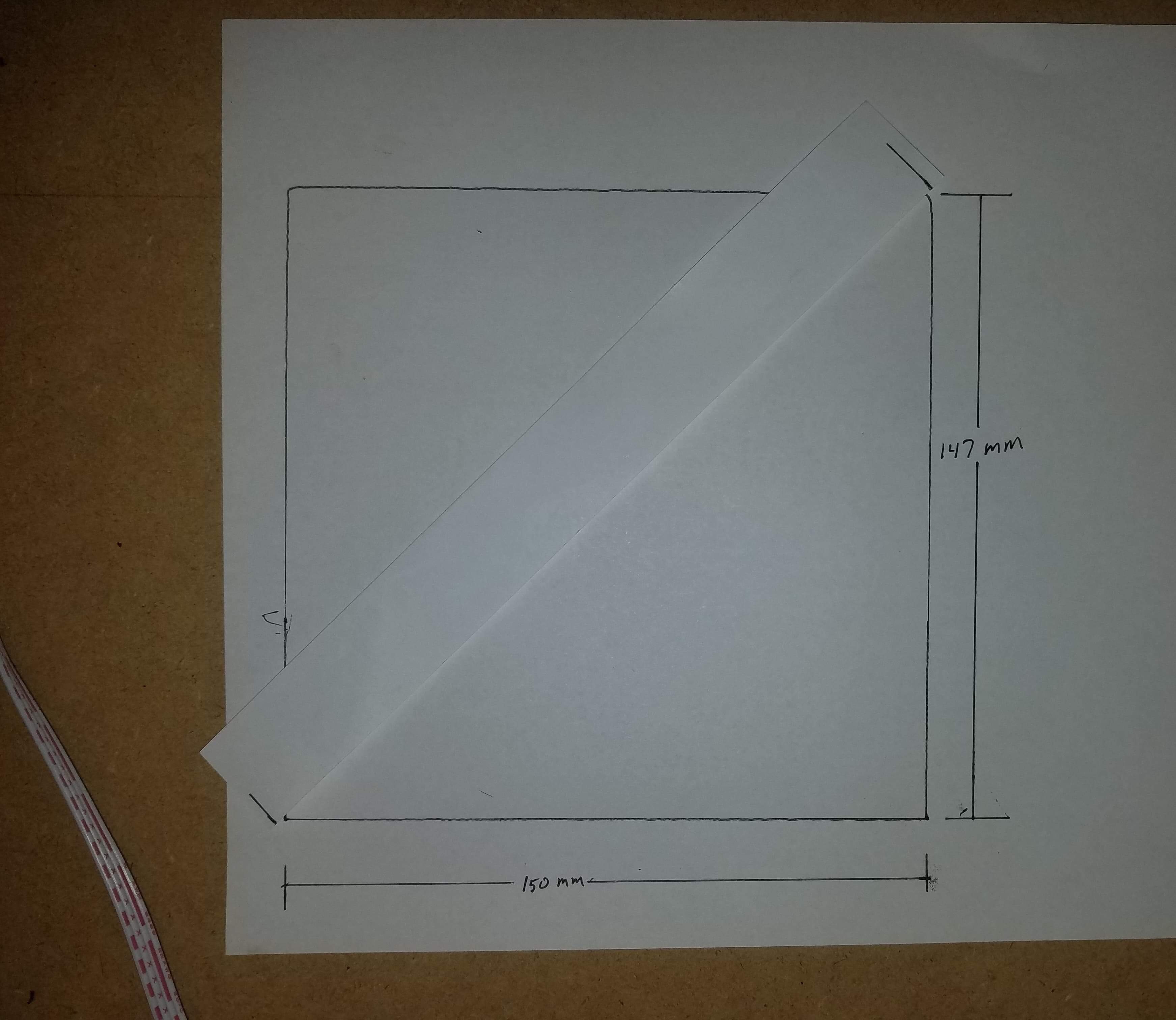

Hey everyone! So my Dad and I just finished up our build and we are trying to make sure everything is working properly but when we try to draw the crown, a strange shift is happening where everything on the left side of our picture is slightly taller than everything on the right side of the picture. So in doing a little troubleshooting, we drew a “Square” by jogging the machine right 100mm, then up, left, and back down all 100mm. The “Square” is only 97mm from front to back (Along our y axis) and it is 100mm from left to right (Along our x axis). Anyone have any ideas as to what our problem could be? We are very puzzled. Attaching a picture of our shifted crown.

Just to add a couple more pics. I have double checked the connections, and it appears all of the motors are working. When I jog it in a 150mm square the diagonal measurements are exactly the same. The Y travel loses 3mm over 150mm of travel. X travel isdead on 150.

New information - I jogged it 5 times in a row along the Y axis (50mm each), and discovered that the total line was still 3 mm short. When I measured each segment I found out that the first one was 47mm, and the rest were all dead on 50. It seems like I read something about an offset, but don’t know where. I will keep looking now that I have this information, but thought I would post it to see if this clarifies anything.
