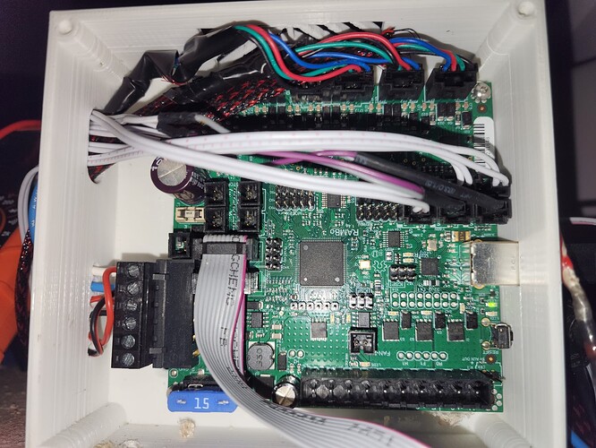

Can you share a picture of the rambo all wired up?

The rambo looks like an official one from ultimachine.
I know you changed the firmware. But that all looks fine. Is it possible the wiring came loose or something isn’t plugged in after the update?

There are a pair of pins labeled “X30.” In the picture of your wiring, the pins are in the upper left under the cabling and above the big capacitor. These are a pair of aux power out pins on the motor rail. Carefully take the voltage at these two pins. This will tell you if you have power at the motors. Do you know what version of the firmware you were running before?
It wouldn’t hurt to do a factory reset. I think you can do one from the display, but if not, send an M502 followed by an M500.
I do not know the previous firmware version. X30 pins are dead so the motor rails don’t have power. Replaced the only fuse I saw and still no power.

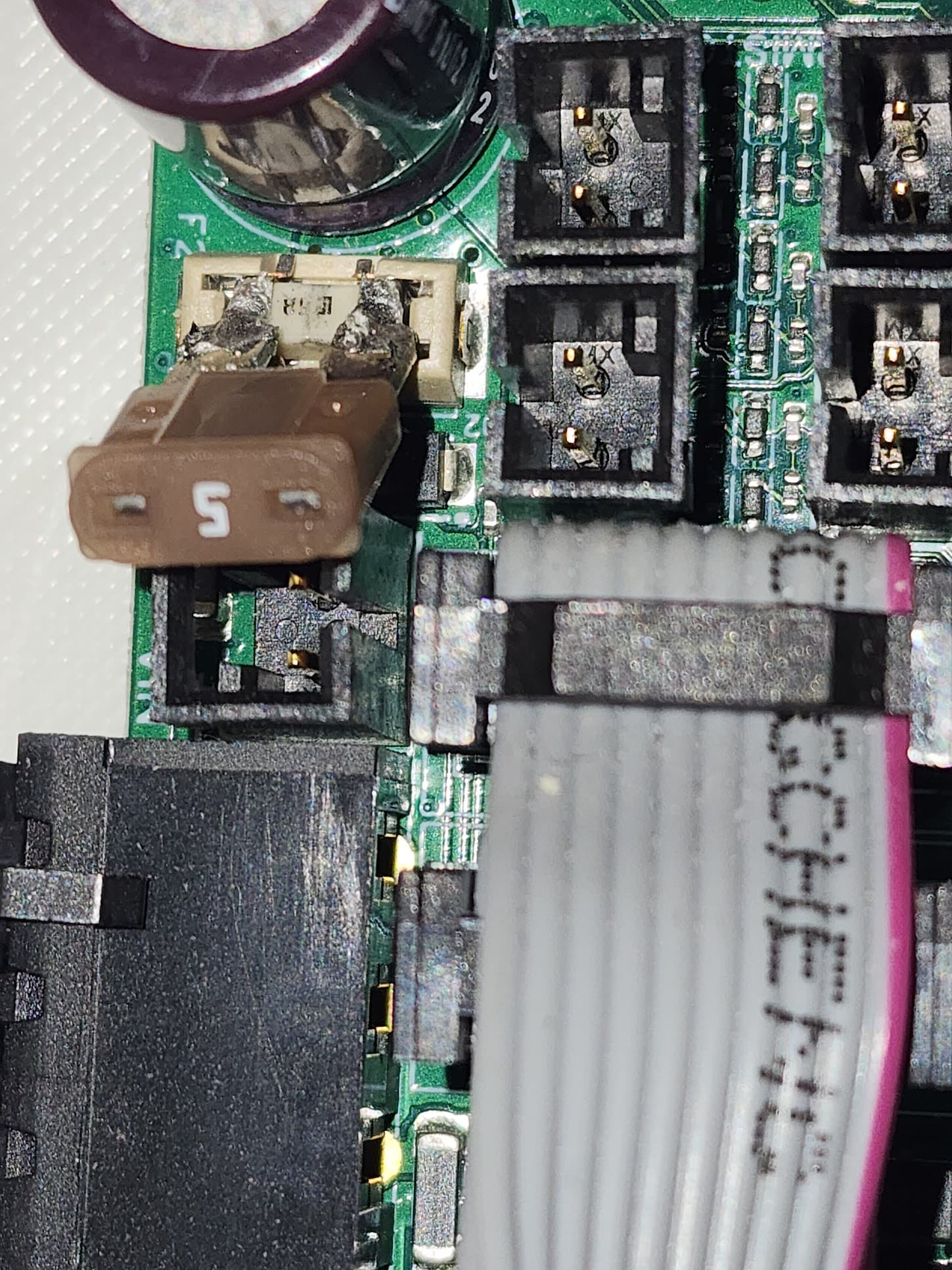

There are at least two additional fuses. Looking at the pinout diagram, they are labeled F2 and F3. These are small fuses. Ryan sells replacements in the V1 store. I’m not sure which fuse is the motor fuse.
So if my research is right, that’s the nano fuse below the capacitor and not the blade fuse.
I took a brief look at the schematic, but could not find the fuses. I suspect the blade fuse controls the heated bed, and the fuse you’ve identified is the motor rail. What is puzzling to me is how updating the firmware resulted in a blown fuse.
Edit: Fuse F2 (the one you’ve identified) is definitely the motor fuse. It says right on the pinout diagram.

Thanks for the help all. I have confirmed it was the fuse. All is working now. On a related note, in this week’s episode of “don’t try this at home” :rofl:
(This is just for testing purposes. My actual 5A SMD fuses will be here tomorrow)
