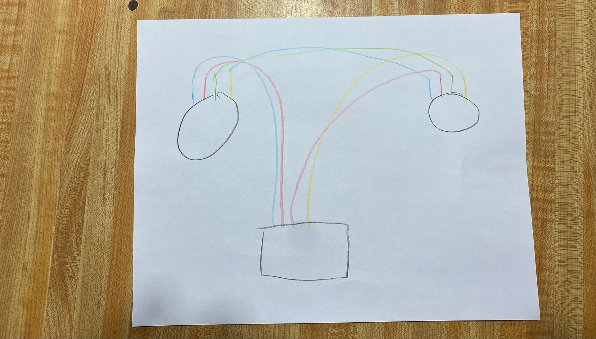

This was easier then trying to show all the wiring.
Keep in mind that the wire colours change according the the harness. Will include a pic or two
First pic shows the wiring colour change.
Second pic is what I used to wire it
Third pic is how my wiring is laid out.
So after posting the last reply I realized the wiring is wrong. Here is the new way I wired it. Does this look right ???
That doesn’t look right. If you follow the path of one wire, it goes through 3 coils. I am not sure why that would work plugged into the Y port.
Your previous picture, the hand drawn one, doesn’t look right either.
If possible, I would make the wires from the steppers to the mini Rambo a straight 4 pins. All the way to the Rambo board. You can then test the motors individually. After that, make a small 6in or so harness to do the serial wiring (like the picture you posted from the docs). That will let you test the motors and the harness separately.
According to the second drawing I posted and the diagram I posted my wiring in the second drawing would be correct
I wired it according to the second drawing I posted and it works now. Although I don’t want to burn anything out.

This is what this wiring looks like to me. That doesn’t look like the same wiring as this:
Your drawing shows the coil going from 1 to 3 on the mini Rambo, not from 1 to 2.
Maybe the disconnect is that your motors aren’t wired the same way I expect. I am just trying to help. If it isn’t broken, don’t fix it.
If you have a multimeter, you can check the pins at the mini Rambo for pins 1-2 and 3-4.

So if I hook up like this pic then it should work and not fry anything ??
That is correct.
That is wiring in parallel. It works, but it halves the current through each motor
https://docs.v1engineering.com/electronics/steppers/#parallel-dont-do-it-this-way
The motors are robust and won’t be damaged if wired wrong, they just won’t behave as desired.
