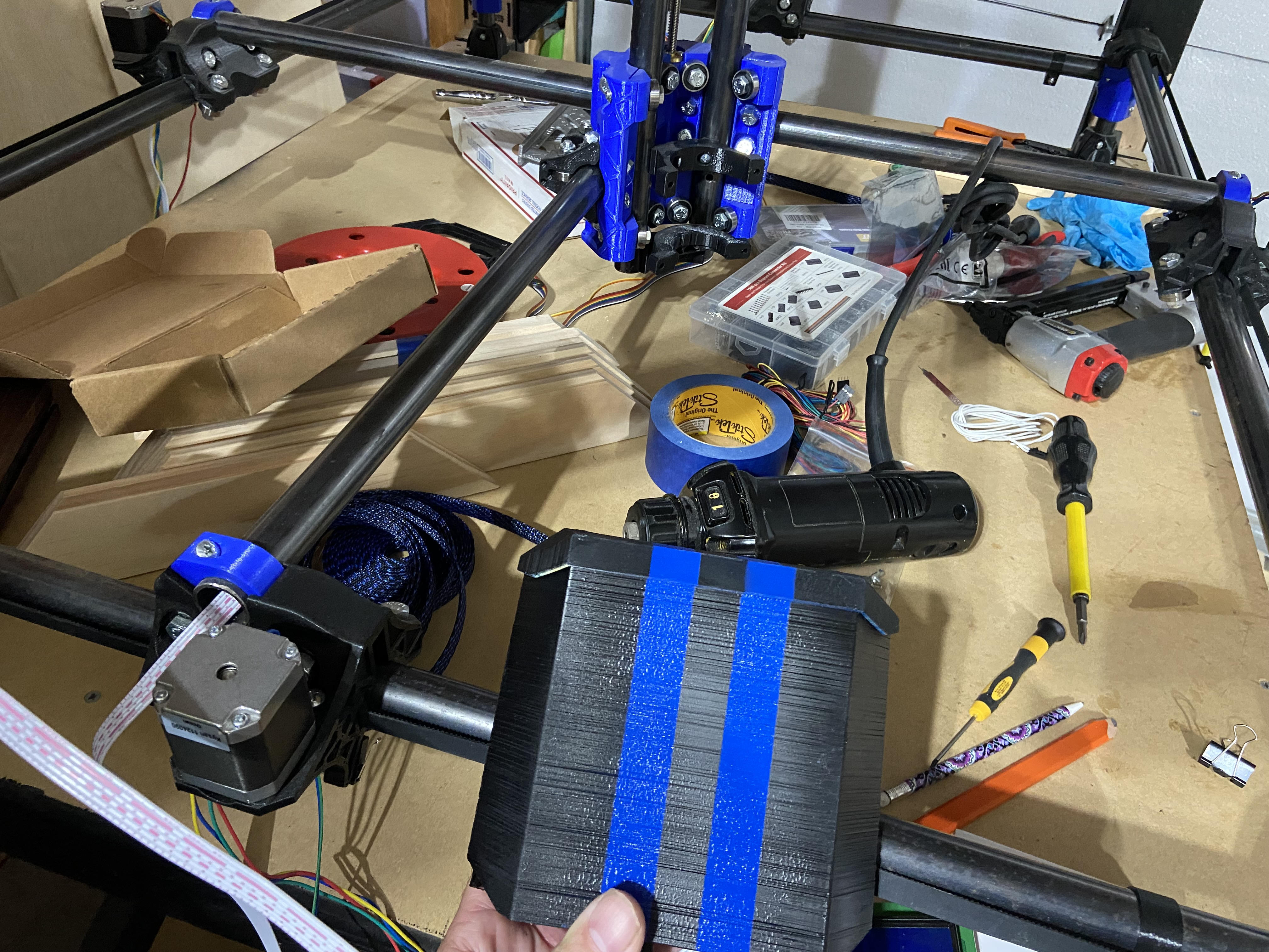

Pic of board enclosure:
Had Z movement in the print, and didn’t surface prep, but I can always redo it later…
Put a blue racing stripe on it, because why not. Now I’m thinking I need to jazz up the dewalt with blue also…
It seems I am enjoying drawing out the build process alot. maybe more than I will enjoy learning the CAM and making things, but I guess time will tell.
