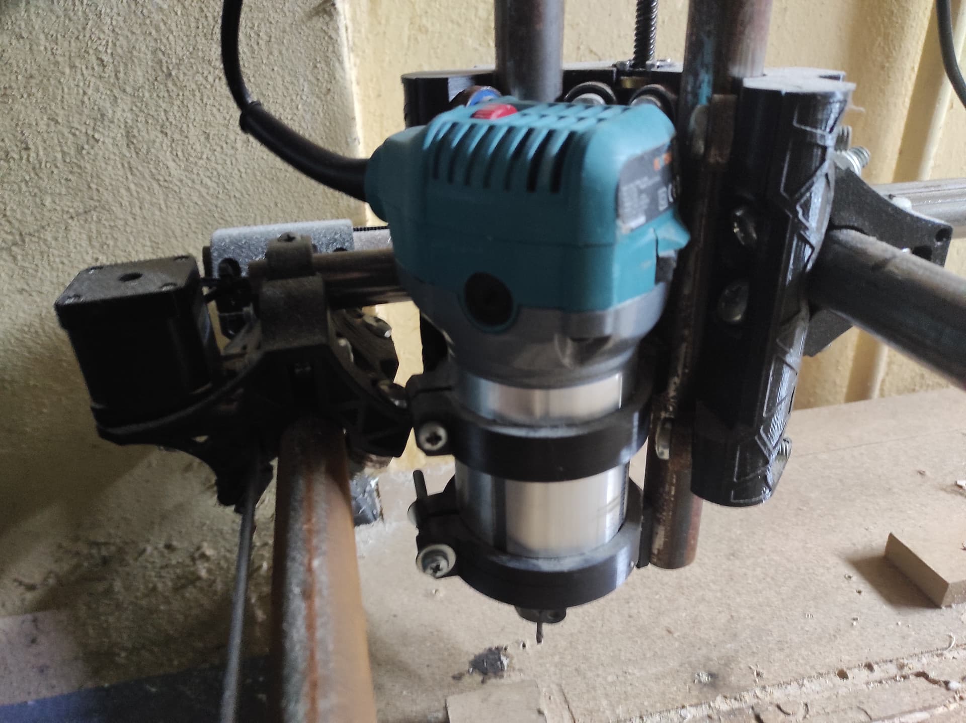

I’ve been using MPCNC por a couple of years now, with inconsistent results. Most of the time I get missing steps, even with very conservative cuts. I think the steppers are a little weak, since I can move them by hand without much force when energized.
I’m cutting plywood mainly and some acrylic, so there should be no problem, but sometimes I get missing steps even a low speeds (1000mm/min) and 2mm deep passes.

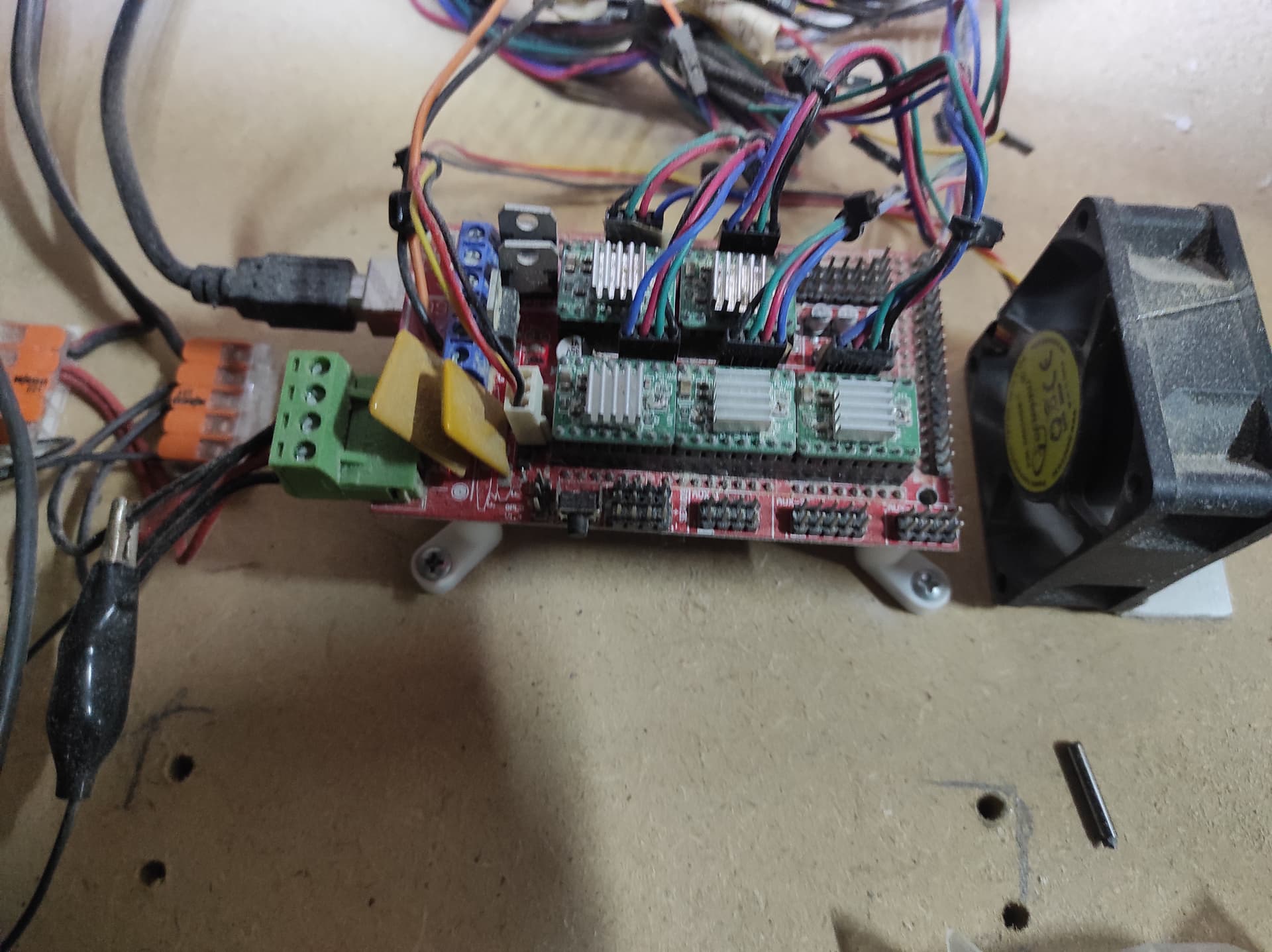

I have Nema 17 Stepper Motors (1,7A 0,59Nm 83,6 oz.in) controlled by an RAMPS 1.4 with A4988 Drivers. I have Vref set to the max (1.7V) → meaning in this drivers that I have 1.7A : Smart choose of the reference resistor.
I also measured the current going to one of the motors, and to my surprise it was exactly 1.7A at max, so I’m running the steppers at the max binary.
For power I use the 12V from the PC controlling the MPCNC. The PC power Supply says it can deliver 30A at the 12V output, so I don’t think there’s a problem with that.
How can I add more force to the motors? Maybe new stronger ones, or better drivers?
I am surprised that 1.7A would still be weak.

I am still using the same setup as you it appears. But I have the voltage reference set at .75 volts. It is very difficult to move the steppers by hand when enabled. At one point early on I thought I would gain " more power" by increasing current to 1.5V. I losed most of the holding power and steps were erratic. I went back to the ‘sweet spot’ of .65 to .79V. I never really messed with it more. My guess is that the overcurrent and over temp controls had something to do with it… Other than measuring the holding current of one of the coils, it is difficult to measure the true current of the coils without a very good scope.
I also remember that the steppers got very hot when enabled with the higher current.
I’m not sure how you are getting the 12V from your computer. But I would check again and make sure your getting 12V at the ramps board connector when running.
I bought the cheapest ones in Amazon :crazy_face:. 17HS19-2004S on the sticker. In the seller page says the same. I also tried lower currents, mainly at the first runs, but it failed a lot. Completely unusable.
With 1.7A the motors get a little hot, but not much, I kept them at 1.7A since they don’t get very hot and the results are better.
A number of builds have come across the forum with your same electronics (Ramps + A4988), and the same stepper motors purchased off Amazon. They are not having your issues (running at less current), so you might want to look beyond the electronics and steppers to see if there is some other issue:
  • What is the feedrate you are using for your cutting? Using too fast (and sometimes too slow) a feedrate can cause issues.
  • What is the depth of cut you are attempting? Start with something shallow like 2mm then increase it.
  • Have you checked the grub screws that hold the pulleys to the stepper motors? Historically this is a common root cause of slippages.
  • Is your wood or your bit or wood burned? Getting the wrong speeds and feeds will quickly burns bits making it too dull to cut effectively.
  • What bit are you using? I suggest you start with a 1-flute, upcut bit.
  • What RPM setting are you using with your Router? For most bits and woods, you don’t want to be running your router at full speed. You can take a look at the chart for the old Shapoko to get an idea of the RPM setting for your Makita router (though I would start with a shallower DOC than the chart). Your feeds and speeds will vary from this chart, but this chart will give you a starting point.
  • Any chance you used steel reinforced timing belts? If so, the steel will break running over the pulley resulting in inconsistent stretching.
  • How easy do your axes slide when the steppers are off? They should slide smoothing with little resistance.
  • Are you sure both steppers and each axis are working consistently? Wiring issues can cause a stepper to lose steps.
  • Make sure your router is turning clockwise. While I’ve never seen this issue with a Makita router (it happens with spindles), it only takes a few seconds to check.
Note that I can easily overwhelm my engaged steppers, but I don’t suffer from lost steps. Also, I’m concerned about your high current setting. I’ve never seen a “stock” Primo run this hot. My concerns are the stepper motors getting too hot and melting the PLA plastic, plus running hot can cause the stepper drivers to shut down temporarily.
This may or may not play any role in your issues, but you might want to clean those tubes and bearings up a bit. The rust could be adding unnecessary resistance.

It seems to me, I’ve underestimated the material hardness. With plywood I can go to around 2000 mm/s without any problem but I need to go to much lower speeds cutting acrylic, but even that needs to be tested before going to the final pieces, since some acrylic are much harder than another. I figured out that the problem was on the RPM and feed speeds since I managed to break the cutting bit.
With acrylic is much harder to find a good RPM / Feed combination, because if I go too slow, it’ll melt and be stuck to the bit. Even changing one brand to another I need to lower or raise the RPM and adjust the feed. I’m doing this, starting at 1000mm/s and increasing or lowering the feed in the OpenBuilds.
I think the problem wasn’t with MPCNC, but with my lack of knowledge in using it.

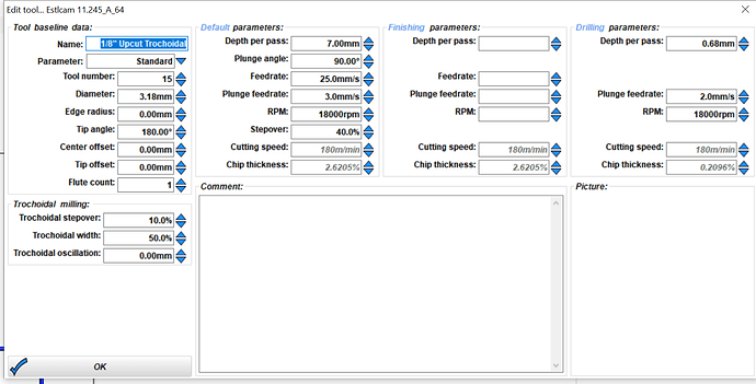

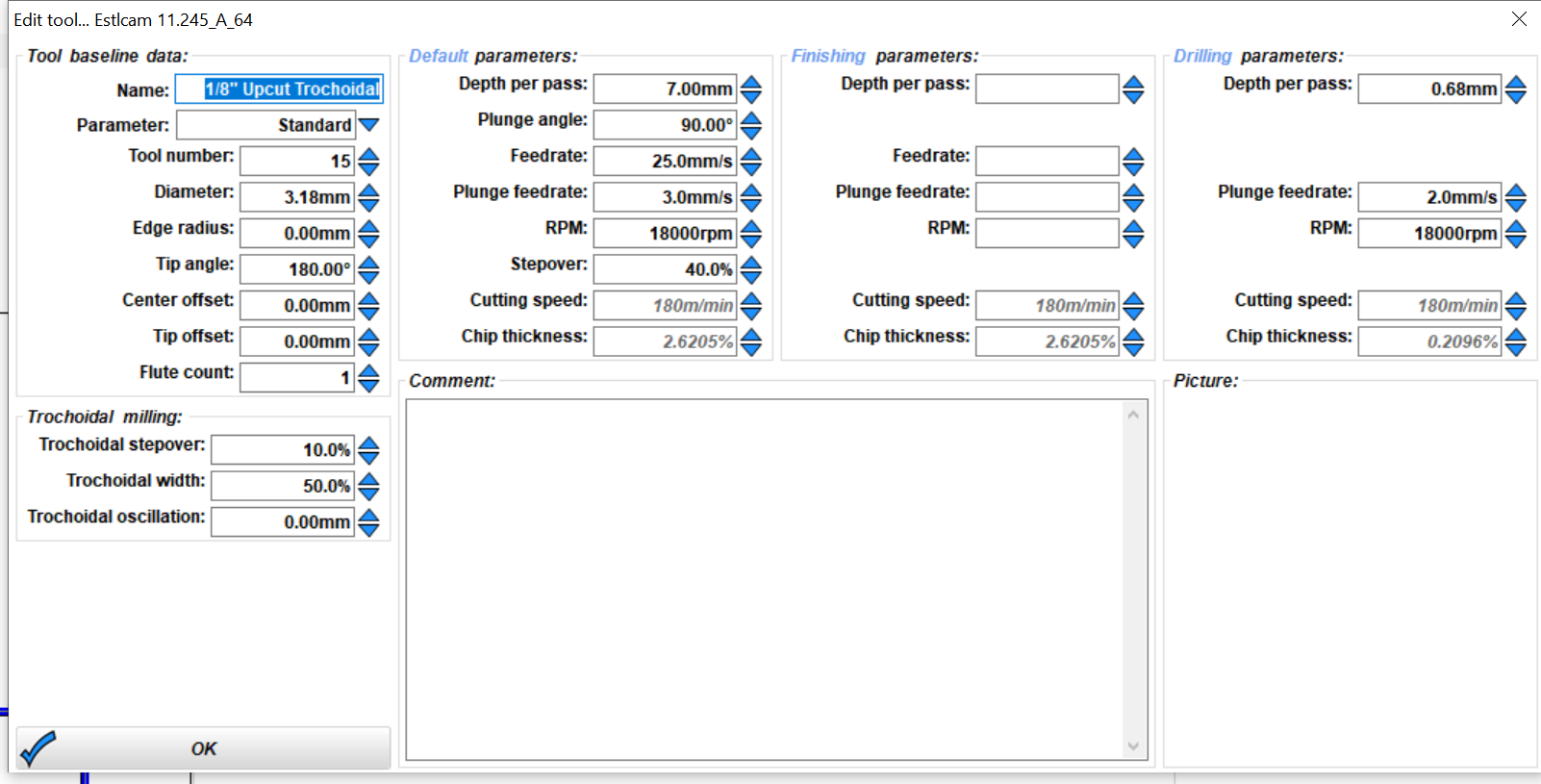

for acrylic Trochoidal works well. I cut full depth in one pass. Helps keep the bit cooler and gives a clean cut
Chant with me: Trochoidal, trochoidal. Hoohaa.
What do you use to make the Trochoidal path?
Assuming you are using Estlcam…
In the bit settings you can set up Trochoidal. Click the wrench icon to the left of which ever bit you want to use.
How much stepover depends a lot on what you are cutting, how stiff your machine is, how fast your feed rate is. I have found for aluminum 5% stepover and 25mm/s works good. In acrylic I can go 10-15% stepover. And I always cut full depth.
Soon ill be doing some testing in 1/2" aluminum and will post my results
