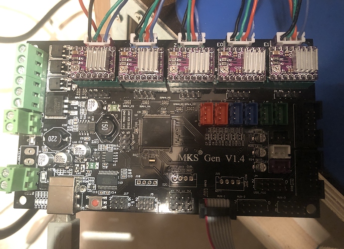

I am using MKS Gen L 1.4 board + TFT28 Display + Marlin from V1engineering, Mac using Repetier.
I just made my CNC alive, I can move gantry via Repetier, I notice that only one Stepper Motor of the X and Y axis is working, the axis move but can not figure out why only one side is working.
Any idea?
How are they wired? If they are wired in series, they should be moving in lock step.

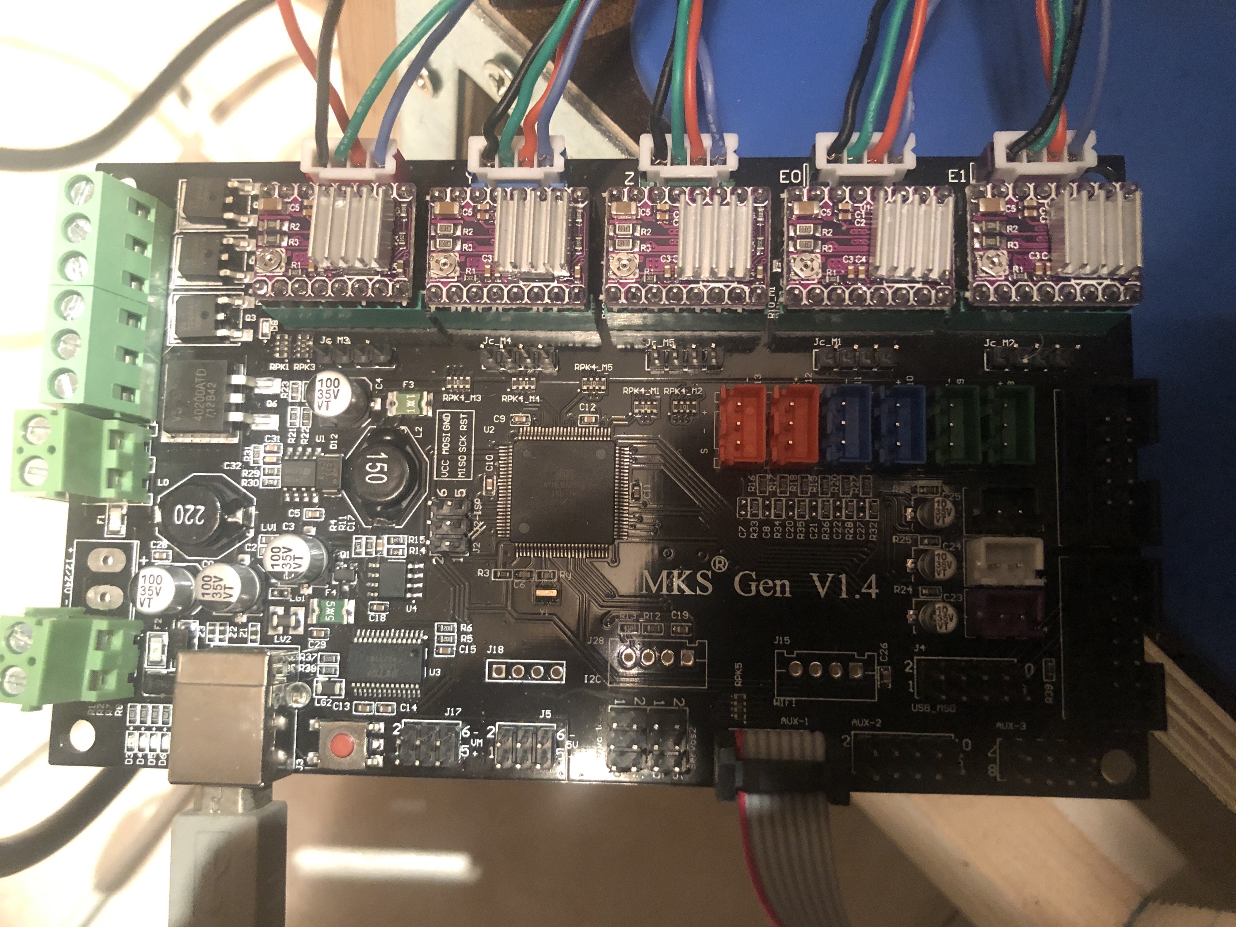

Hi Jeffeb3, you are asking too much :frowning: have no idea… I am sending you a picture maybe you can tell me.
Aha. OK.
The “normal” configuration is to have both X motors wired to the X driver and both Y motors wired to the Y driver. To keep the drivers from having to pump out an enormous amount of current, it is suggested to wire them in “series”. Here are Ryan’s details on it (Look at the DIY way):
https://www.v1engineering.com/assembly/wiring-the-steppers/
If you have a board with 5 drivers, you can change the firmware so that each X and each Y gets it’s own driver. This is the “DUAL_X_MOTOR” and “DUAL_Y_MOTOR” settings in Configuration_adv.h.
The trouble is, E0 is already used for an extruder, so you have to changing the pin mapping too. If this sounds like too much, then just do it the normal way. It will work great for you.
I also see that you don’t have any endstops connected. So don’t do any homing (to answer your other thread).
That is assuming that this is a 3D printer setup. From the information I can see, I don’t know if that is what is going on. Does he have the second x and y motor stuck into the extruders?

From the picture, he’s got the X2 and Y2 plugged into the E0 and E1 ports. That’s fine, if he’s using the Dual Endstop firmware, but this isn’t a RAMPS or Rambo board.

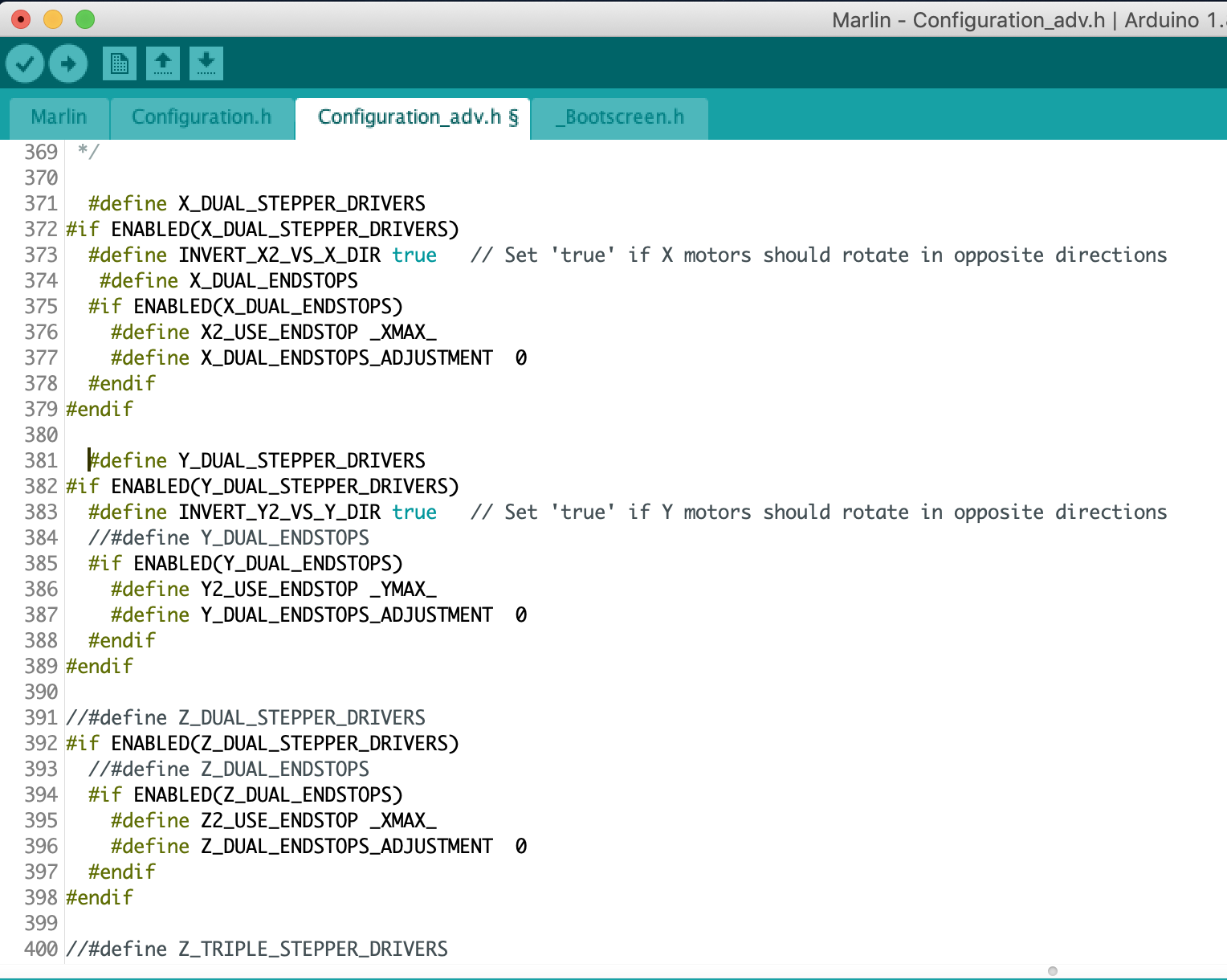

Hi, I am not planning to use the machine to print, already have 3D printer, in this case can I leave the cables connected separately in the board?
So the only thing is to delete the comments “//” in the Configuration_adv for #define “X_DUAL_STEPPER_DRIVERS” and " Y_DUAL_STEPPER_DRIVERS".
Keep the Z with the comment “//”
I am correct?
Cheers.
No you also need to shuffle the pins file. Have a look at the dual page for details.
