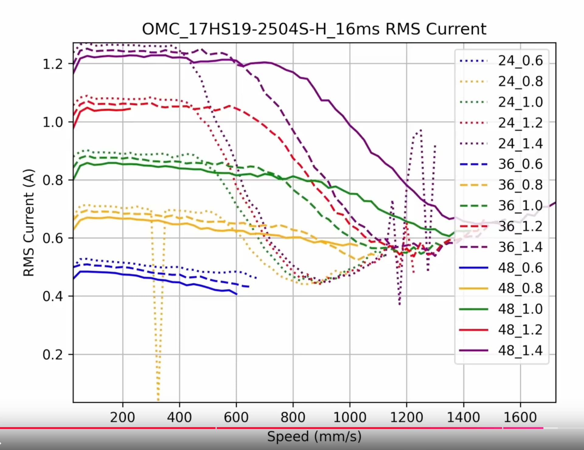

https://www.youtube.com/watch?v=4Z2FBA_cBoE is probably the video you need to watch to understand this.
Spoiler:
Pretty much same torque with all voltage/amp levels.
At 24V all ampage levels drop off at a similar speed, a speed that (other than travel moves) we are very unlikely to hit.
