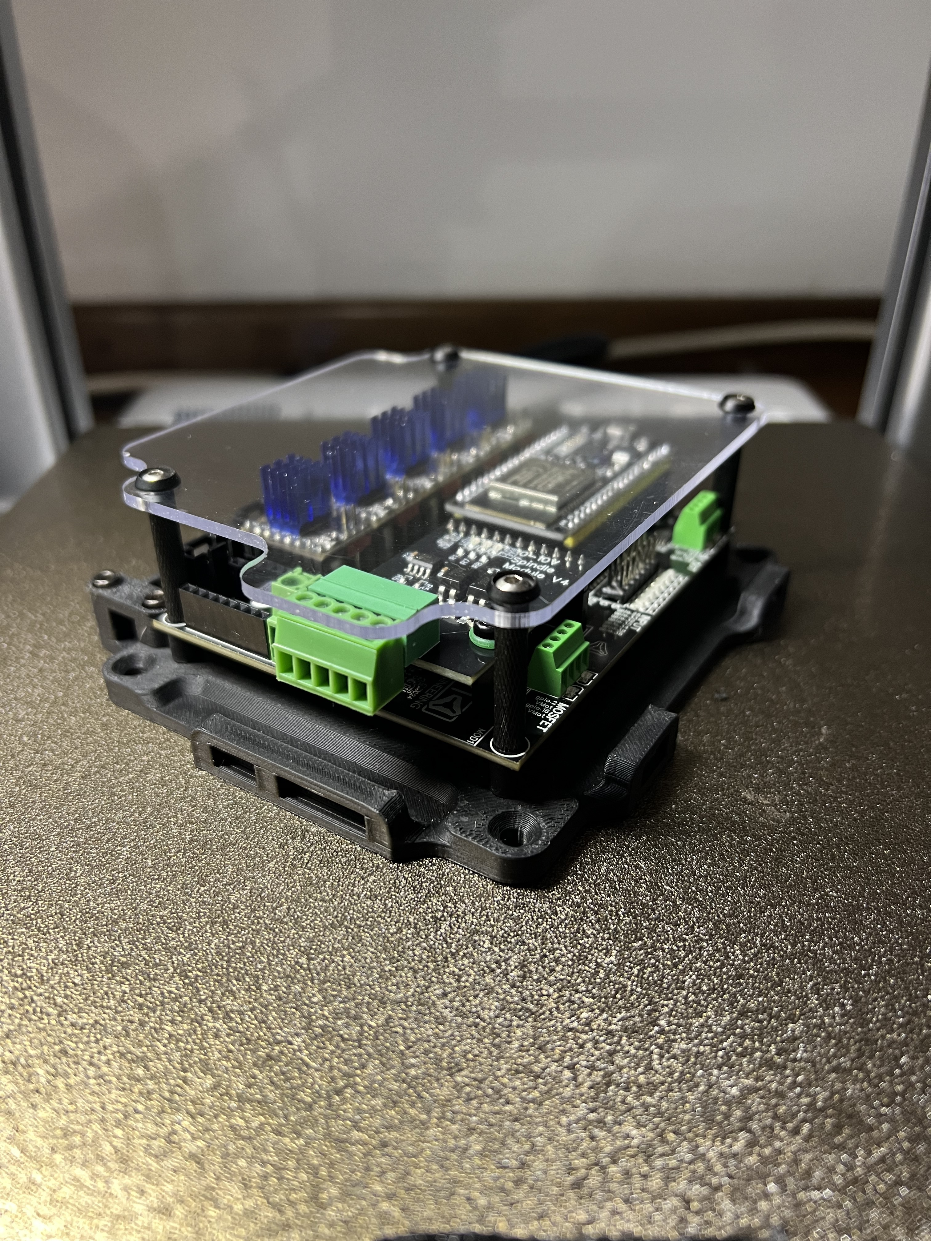

The Jackpot setup for the compact LR4 is ready😂
Next step is to build the complete electrical box with all the cable management and control panel.
I’m still deciding if put all inside a drawer under the machine, or in an external box🤔

Dang, I love it!!
There will probably be a box that fits inside the beam, but yours will fit, too, I guess. :slight_smile:
