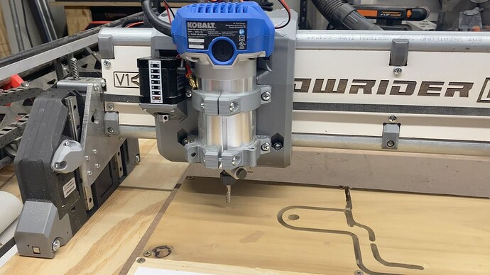

VIDEO: LowRider v4 (RC2) - NEW HARDWOOD SPEED TEST cuts! 50mm/sec. 12mm depth of cut. 1/4” 1-flute.
NOTE: I seem to have mis-identified the wood, and I’m getting heads up that it’s probably either Alder or Poplar rather than Maple.
NOTE: I also had reported the stepover was at 50%, but I just checked the ESTLcam file and it was actually 75%. So that’s even better cutting performance than I originally stated!
For specific cutting details on a broad range of uses with my Kobalt router, please check out my most recent five videos or so. They include cut settings for aluminum, MDF, and hardwood.
Poplar and maple are two very, very different books.
I’m definitely no expert on identifying wood species, and so I’m bound to make mistakes and get corrected. Getting corrected is OK, especially when it was as nice as @CFIMike was about it.
Not cool Doug. I was watching this thread for the last few months with a lot of interest but until your video I was content with my LR3…because how could it get much better. Well, the video shows how!! Time to buy some more filament.
Note: this was cut using the “glued-together” RC2 core that resulted from a misprint due to an out of spec bulge in some cheap PLA! Glued together with CA glue. Riding OK and cutting just fine!
UPDATE: I had switched back to normal driver power settings, and forgot I had done it. I have updated the video’s description to say:
For these tests I had the steppers at 0.8 amps — driver power was exactly as set in Ryan’s config that shipped pre-flashed on the board. Here’s the default power settings that were used on this job:
run_amps: 0.800
homing_amps: 0.800
hold_amps: 0.500
More soon!
ALSO: I also had reported the stepover was at 50%, but I just checked the ESTLcam file and it was actually 75%.

Wow! Those chips are awesome!!!
Still some minor quality of life improvements happening.
I’ll bet Ryan’s edit log is passing the mid to upper single thousands at this point.
It’s going to be another great machine.
INSANE!!! It’s infinitely faster and stiffer than my LR2. It will undoubtedly be a great project!
