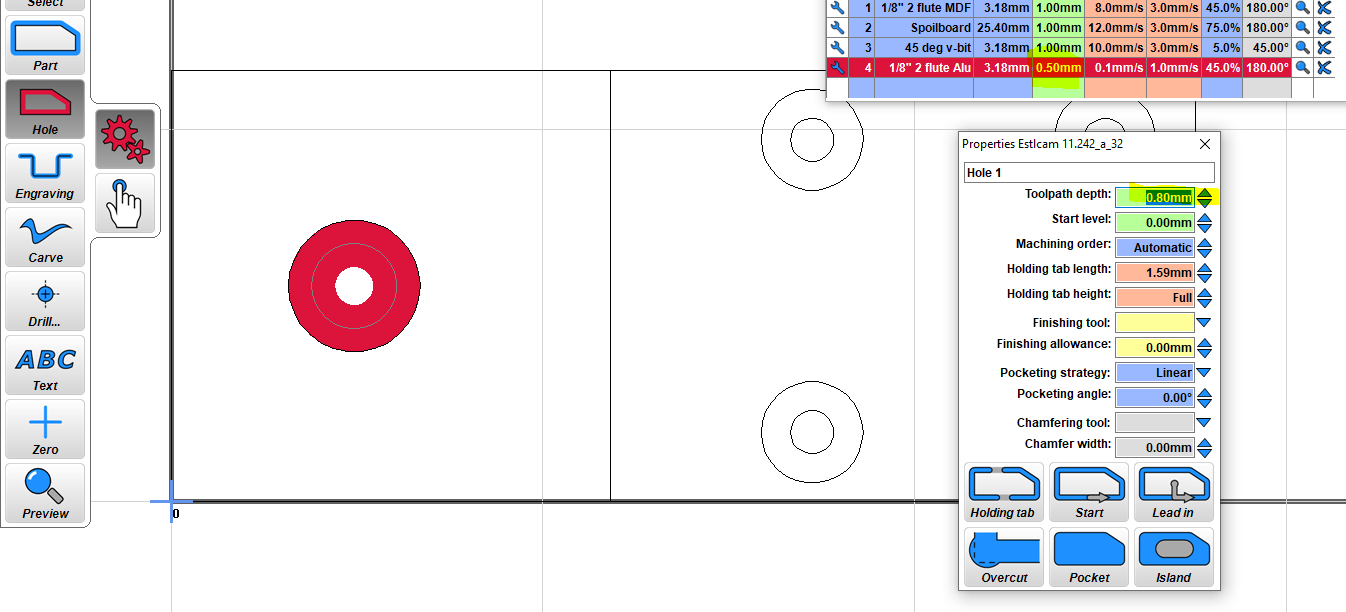

I am just posting a quick question here since I am not sure what’s happening. I tried cutting some aluminum today on my mpcnc and I broke 3 1/8" bits one after another. I didn’t know what was happening until I checked to see how deep the cut was and where the bit broke. I noticed that on my panel I would see -3.00 when the cut started, I decide to zero Z about 15mm above the starting point to be sure.
Once the print started I saw on the panel that it would go down to -3.00 even though I am telling it to only go down 0.10 - 0.50 its not doing that. Can anyone give me a suggestion on where to look to see why its doing this?

This is what I am seeing now. I know there was nothing with a ‘3’ in any of my settings so I started looking at my config to cut the material. I was under the assumption that the toolpath depth is how thick the material is. But once I changed that value to 1mm, then 0.8mm I noticed that when the job starts it goes to that number.
If I am using the program incorrectly then where do you tell the program that you only want to cut lets say 5mm out of a 10mm piece of stock.

Exactly, I had 3mm as my DOC and Z would plunge down 3mm into the stock and break the bit. The only place that I had a 3 was in the DOC. So I did a test to see if that had anything to do with it, once I changed the value to 1mm then Z went down 1mm when the cut started. I then changed it to 0.8 and Z moved down 0.8mm from the zero position. I am using Repetier-Host.

I set the hole parameter to cut 7mm along with a DOC of .8mm and then tried to save as gcode, I was then prompted for a cutting depth even though I already put in the cutting depth.
I looked at the gcode like you said and I could see that the tool settings that I assigned to the cut is not the one being utilized in the cut. I tried deleting the first tool on the list since it was pulling those values and it would not allow me to delete, it said something about the tool being used in the cut. I closed the program and once re-opened I deleted the first tool on the list. It seems like its still not taking the settings from the tool that I select since its still asking me what depth that I wanted when saving the gcode.
It seems that I have found my problem, once you pointed out those areas in the code where I should have those two values and they were not there, it looks like this is my issue. A new update to the EstlCam software was just released and I installed but that didn’t make a difference.

Once it asks for the cutting depth and I put it in manually the gcode then reflects what I put in. I was checking to see what program the guys in the Sketchup forum uses to post their tiny videos so I can make one and you can see. I am testing this at work and I am seeing the same issue. Maybe I need to uninstall/reinstall.
I uninstalled the program, deleted all the settings left behind and re-installed. Its not prompting for the depth anymore and the gcode looks good. All that’s left is to test when I get home.
