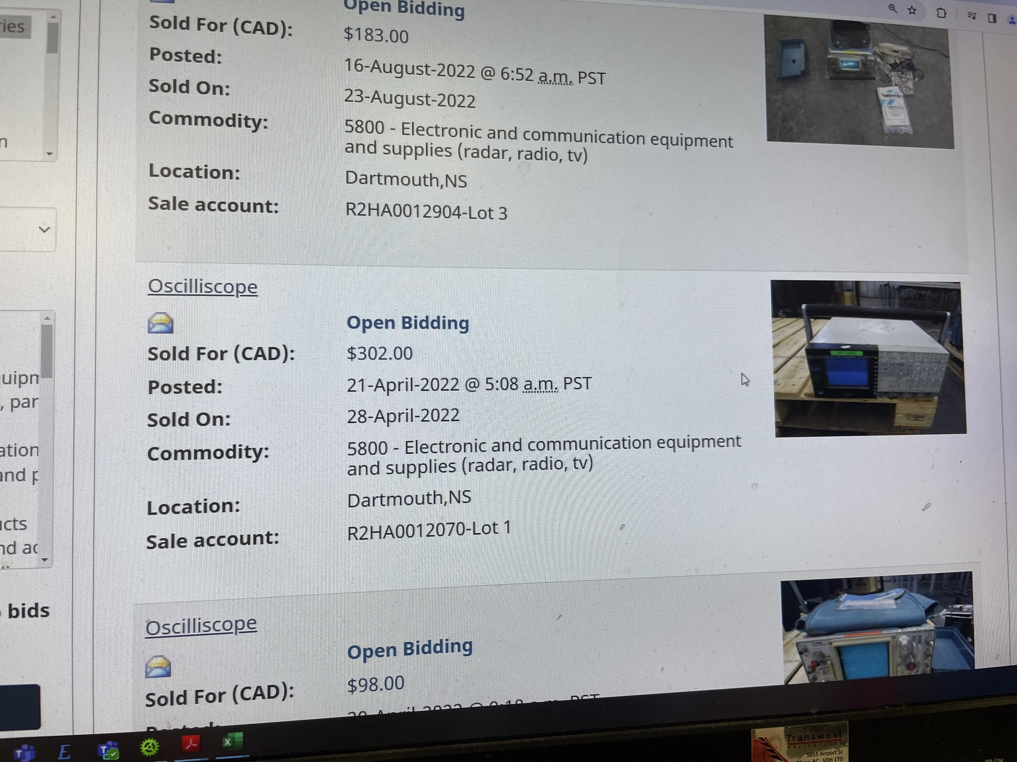

Are these ones obsolete now. They are always up for auction and go for around 100.00 to 300.00 Canadian. Check your local government auction sites.

Yeah, unfortunately. It’s essentially the difference between an old analog radio and a modern smart phone. They’re technically doing the same job in some cases but the technology has advanced SO much that the $300-500 new scopes discussed above are likely better in almost every single way to a scope that was $10-20k when I started into the industry and better than anything that could even really be imagined 40-50 years ago, money be damned.
There are still areas where the cheaper scopes discussed here take massive shortcuts. Typically they have poor sensitivity and high noise on the inputs, along with poor common-mode rejection. That makes life difficult if you’re looking at small analog signals. Most people are going to find the advantages of a modern scope significantly more helpful than the minor disadvantages listed here.
The build quality will also likely be much worse, along with the quality of the probes etc. All of that will be better in older 2nd hand gear, most likely, but those aren’t the things that are going to be valuable to someone for a hobby workshop type scenario.
Well good to know thanks for the detailed response. I have been looking at them for quite some time.
If you’re in the market for one, at that kind of price range I’d be going with the Hantek that Mike M posted above, but my extremely biased recommendation would be to spend a little more and get something similar from a slightly more well known brand like Siglent, Rigol or GW Instek, in that order. The Siglent stuff is extremely well regarded at this level as well as being easily software unlocked for significantly higher capability.
