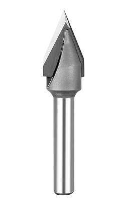

@Tokoloshe What have you found to be the best bit for doing shallow inlays like this?
I’m back home now and am about to start playing with this a bit.
At my disposal currently, I have…
a 45º like this
Some tapered ball nose like this
and Some V1 45º bits
Phew, it really depends. For the coasters it wouldn’t matter since you are setting a max depth anyway, for things like fonts I usually use my 60° over my 30° or 10.2° because then it is just a lot quicker because it doesn’t cut as deep but the full width in one go.
For the tiny birds I used the 10.2° with the round nose, you can just force them together and those 0.25mm round at the tip can safely be ignored. :smiley:
