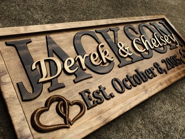

Not sure if title is descriptive enough, but I’m trying to do one of those stacked wedding signs like this:

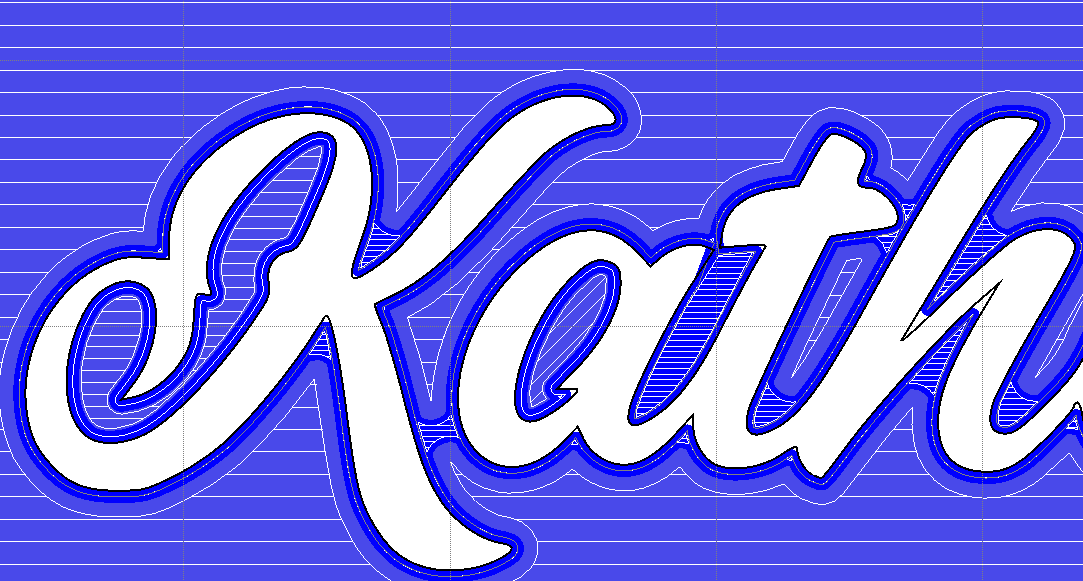

I’m hoping I’m not just being dumb. My thought being that I could use a 1/4" bit to clear most of the island and then a 1/16 bit for the detail around the lettering. My assumption was I created the island tool path with the 1/4" bit and the 1/16" bit would be my finishing tool. But that doesn’t appear to be what it is doing. Instead I get the 1/4" bit overcutting the gaps it’s supposed to. Especially the dots over the i letters in the script.
I don’t really want to use a V-bit for operation because somehow I don’t think it would like right at the 2nd layer. 1/16" bit should be plenty enough detail for all of the lettering. Just seems like a lot of wasted time if I did everything with the 1/16" bit when the 1/4" could clear a majority of it much faster. In reality, after all the time I’ve spent trying to get that method to work, I could have just cut everything with the smaller tool. But the point is to learn so I can be better in the future.

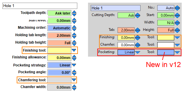

With v11 you could only add a finishing tool to path properties, with v12 you can also add a pocketing tool. With v12 you can set your 1/16" path and then select your 1/4" pocketing tool. It works like carve pocketing (v11 and 12) in that the 1/16" tool will be used to pocket any areas that the 1/4" tool cannot reach.

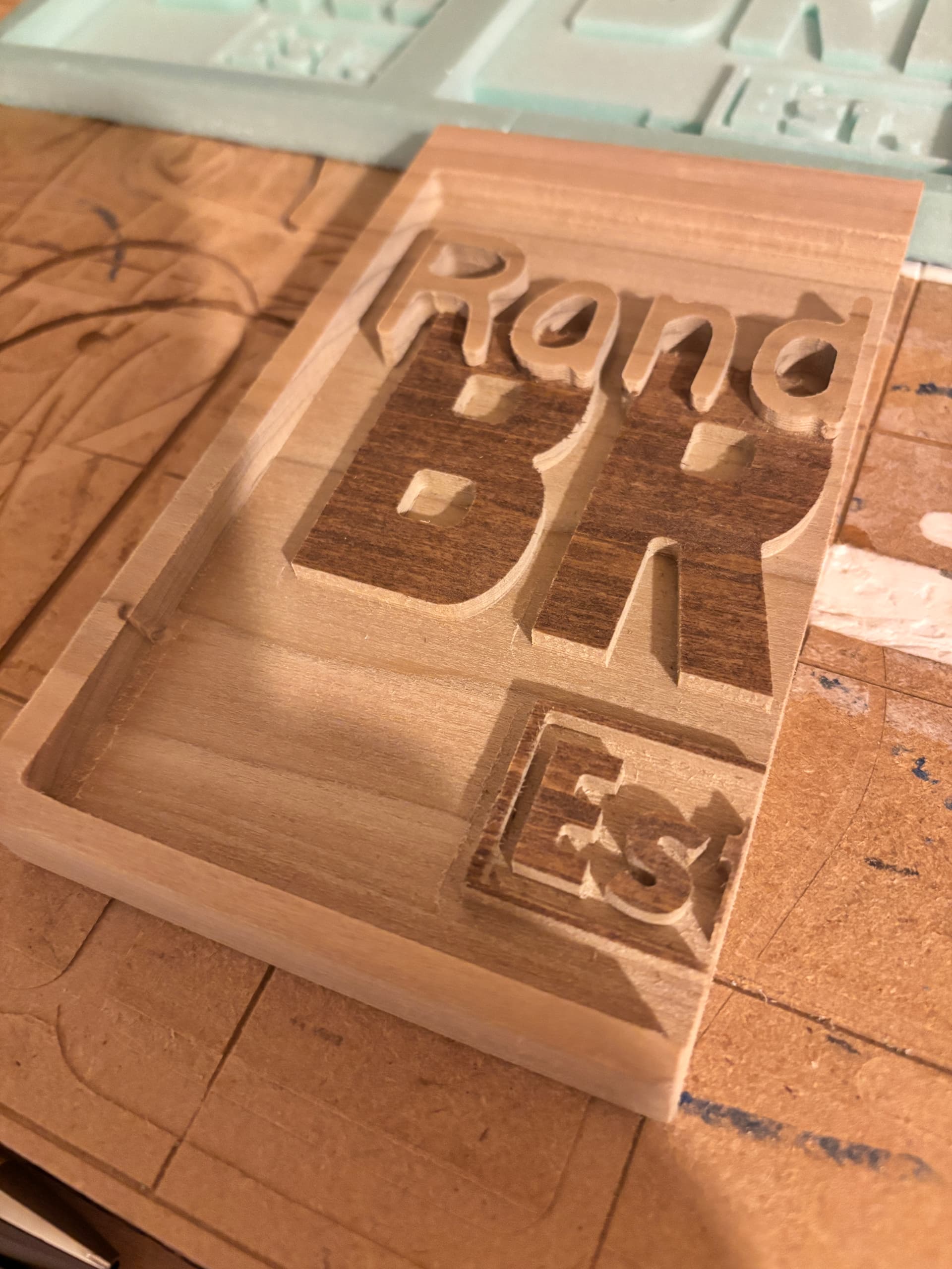

I’m using v12 of EstlCAM and I did a pocket for the middle of the letters (with a finishing tool - 1/16" bit), and an island for the rest. I did the “clearing” with an 1/8" bit, and had it set up with a finishing tool (1/16" bit). Here is a sample (test) cut - I didn’t surface this scrape piece so it was a bit warped.

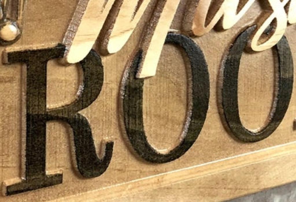

I saved the image because it looks like it was done in 3D (the slight vertical/cross grain lines). The drawback is that the whole surface would have be cut with a <= 1/16" finishing tool.
That 1/8" path w/ 1/16" Finishing tool only works if the spaces between the letters is >= 1/8". That is the only option when using v11.
With v12 you can set an 1/8" path with a 1/16" Finishing tool and a 1/4" (or bigger) Pocketing tool to reduce your pocketing time.
…Tim’s letter spacing is >= 1/16" (a hair less between the a and t) so the path has to be 1/16". While he could add Finishing and Pocketing tools, he gains a lot more from the later.
v12 path pocketing tool 2
