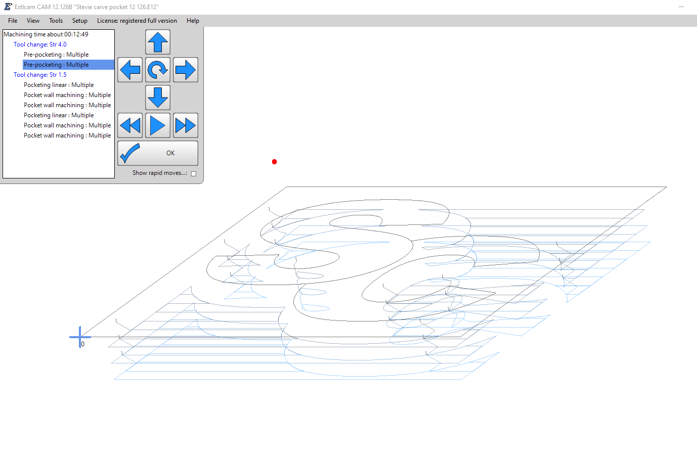

Stacked island pre-pocketing is now grouped (v12.126).
…Note: Stacked carve pockets still need to be checked to insure that the carve tool group will be machined in the correct order, i.e. setting a machining order (No.: ) may be necessary.

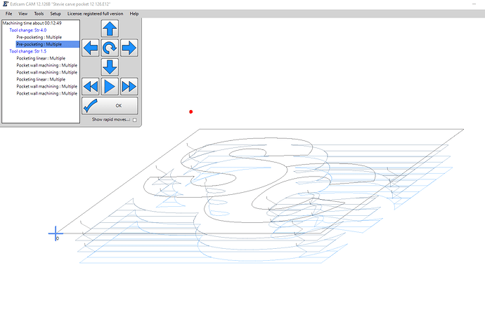

I screwed up, v12 still has a pre-pocketing Start depth bug. To avoid re-cutting what the top straight tool island pocket already cut, the lower down pockets need a Start depth (= to previous cut depth) and I somehow missed that when I first tested .126 (my last image). When I set a Start level the pre-pocketing became ungrouped (same as my earlier .123 image).
Stacked regular carve pocket (no Start depth) and inlay carve pocket (w/ Start depth) pre-pocketing are both grouped.

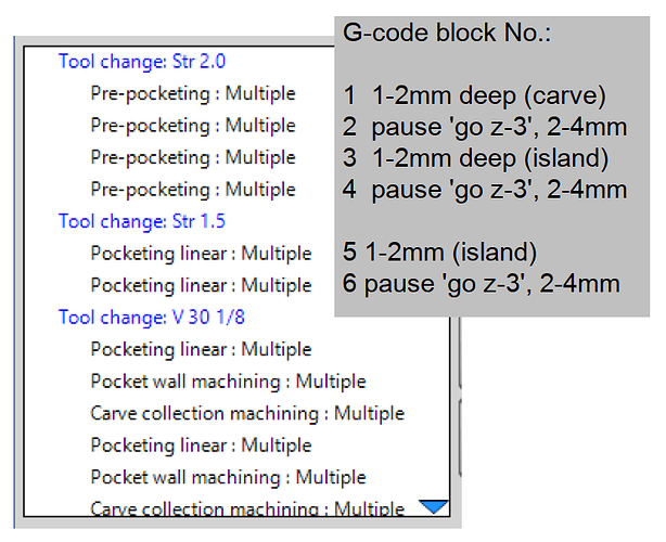

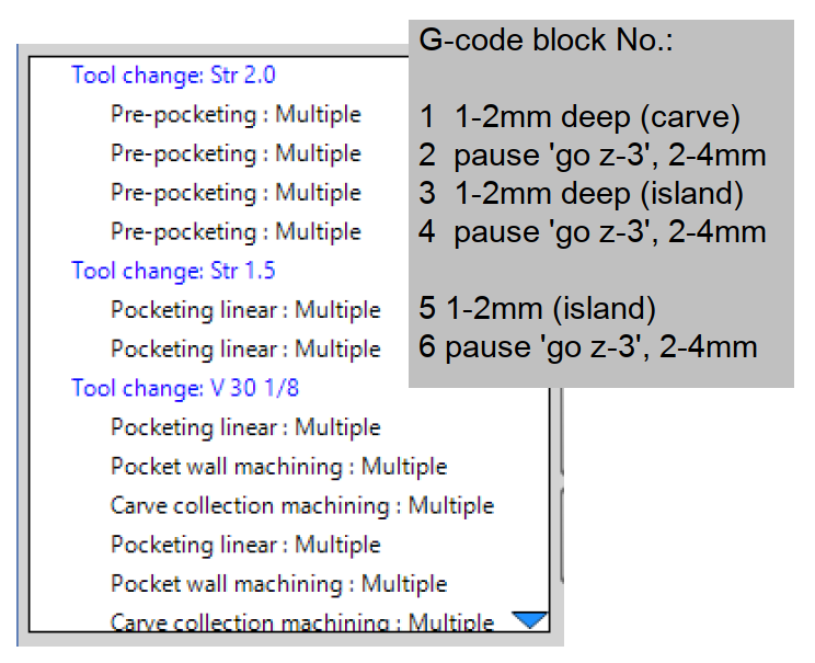

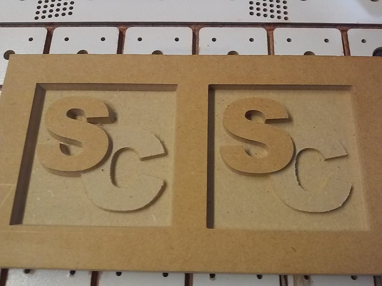

A tested w/ Estlcam controller workaround is to do stacked island pockets the same as stacked carve pockets (no Start depth). The examples have 2mm deep top and 2mm deep bottom layers and all tools (2mm pre-pocketing and 1.5mm/30V primary) have a 1mm depth per pass.
After the top pre-pocketing layer is cut (2mm tool, 0-1 and 1-2mm passes) the machine is paused and the command ‘go z-3’ is entered* to skip what was already cut and start with the 2 - 3mm pass. With the straight tool island pocket the same thing can done with the primary (1.5mm tool) passes, pause at the second layer and ‘go z-3’.
*When manually editing the G-code or using the ‘go z-3’ command to find the first instance of z-3 in a code block, the actual start point needs to be a few lines earlier at the ‘G00 Z clearance plane’ line (e.g. G00 Z5.0000).
