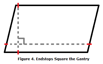

My main claim is that the tool head moves parallel to the gantry rails and not parallel to the side rails. Consider Figure 1 where nothing is square:
[attachment file=92740]
If the tool moves purely in the positive X for example, (left to right) both ends of the X gantry rail are fixed, and both ends of the Y gantry rail will move left-to-right. The tool head will move left to right along the X rail, but since it is not square it will also move slightly downward along the Y gantry rail. The Y gantry rail cannot exert an axial force on the tool because it is on rollers. So the tool head move parallel to the X gantry rail when a +X move is made. The angle of the side rails does not play a part in this motion (except maybe the length of movement could be off by the cosine of the angle error).
And likewise a +Y movement will have both ends of the Y gantry rail fixed, so the tool must move parallel to the Y gantry rail. This is irrespective of whether the gantry rail is parallel to the side rails or not.
To reiterate, the direction of tool head movement is determined by the angle of the gantry rails, not the side rails, and the squareness of the gantry rails determine 100% of the squareness of the cuts, while the squareness of the side rails make no difference (within reason) to the squareness of the cuts. (The side rails had better be parallel, or there will be axial loads on the gantry rails, but they need not be square.)

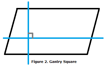

As another example where the gantry is square, and I am claiming square cuts will be made, consider Figure 2:
[attachment file=92741]
In this case, X movements happen to be parallel to the side rails, but consider Y movement. The tool must move along the Y gantry rail. The endpoints of the X rail will move diagonally, and the whole rail will translate a bit to the right for a +Y movement. It’s true the motors and the rail are attached to the sides and will follow their direction, but the tool head can easily roll along the X rail, so the tool will still move purely vertically along the Y gantry rail.

Finally, I am also claiming that with a parallelogram base, careful positioning of dual-endstops can still produce a square gantry. Figure 5 shows how this would work, with the red segments representing endstop positions. As long as the home position of the two gantry rails are mutually perpendicular, it should be possible to achieve a square gantry (and therefore square cuts) even if the sides are not square.
[attachment file=92743]
I hope this does not sound argumentative. I am hoping if I can clearly articulate my conception then you can point out why this is not correct.

No with a square gantry on a parallelogram base you will still cut parallelograms. The base has to be square to cut a square. In your last example X will cut a straight line Y will cut a diagonal.
I am not sure what the actual issue is. Dual endstops easily square a gantry even if your build is wonky. So dual endstops and a square base and you should be easily golden.
This is what I am having trouble getting my head around. In Figure 4 above, you are saying that Y movement will not move the tool parallel to the gantry rail, and the tool head will instead move parallel to the slanted side rails? I don’t see how this is possible since the Y gantry rail is fixed.
I generally agree that it is not that hard to square the side rails and there is no reason to have it out of square, but I am trying to focus appropriately on the part that is truly essential in getting square cuts.
I also agree that a square gantry on a skewed frame will cut slightly short. I believe the length error would be determined by the cosine of the skew angle, so for one degree of skew (which is huge) the actual cut length will be 0.99985 times the intended length, or 0.15 mm short on a one meter cut.
[attachment file=92837]
Edit: adding this diagram to help convey even though the X gantry will move diagonally (blue), the toolhead should move along the Y gantry rail (red).
