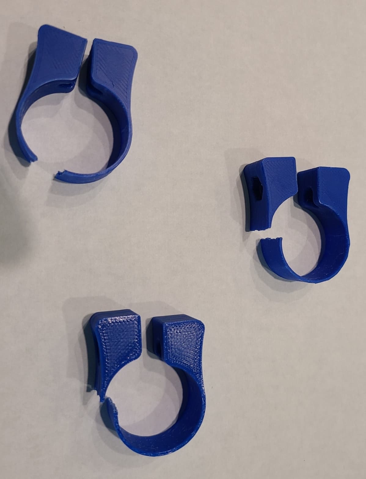

After several weeks of not having used my Primo, I went to use it yesterday and found that 3 of the 4 endstops (PLA) had spontaneously broken.
In thinking about this, I’m wondering if the fluctuations in the tube diameter due to the large temperature swings that occur in my shop right now (about 22C) could be the primary cause of the fracture.

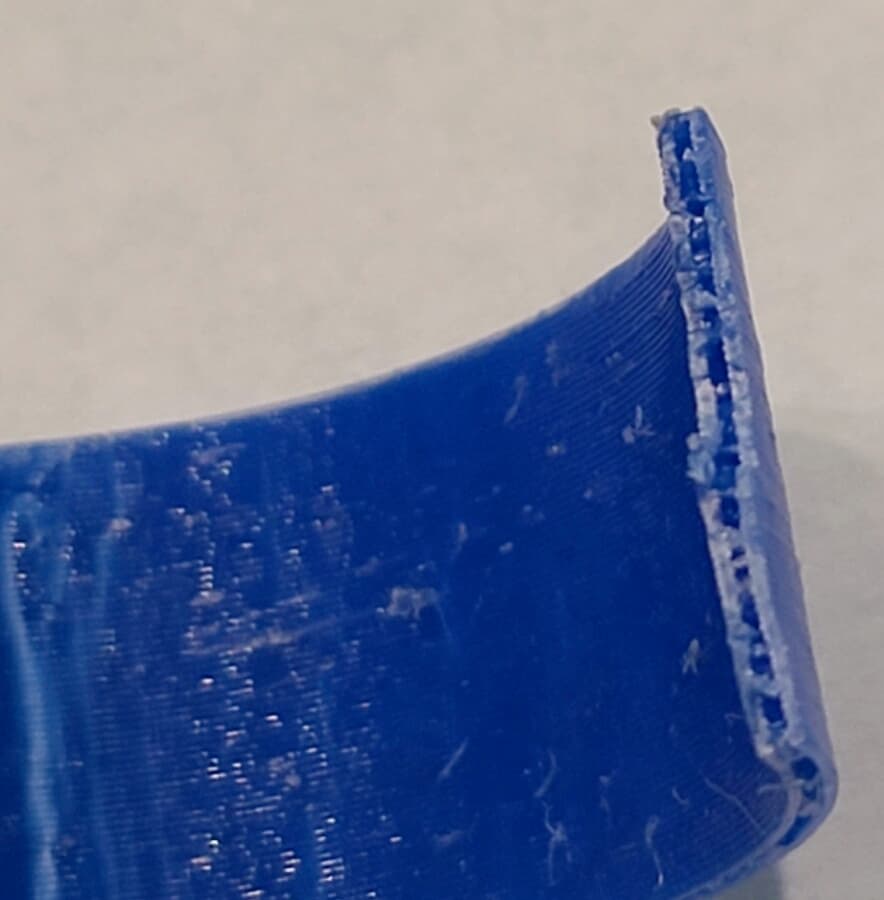

Post pictures of your broken parts.
Lol… I’ll see if i can still dig them out of the trash.
All three fractured in the very thin section. In the slicer, it’s only 2 walls thick (0.6mm nozzle, 0.25mm layers). I’ve not tried to measure from the STL file.

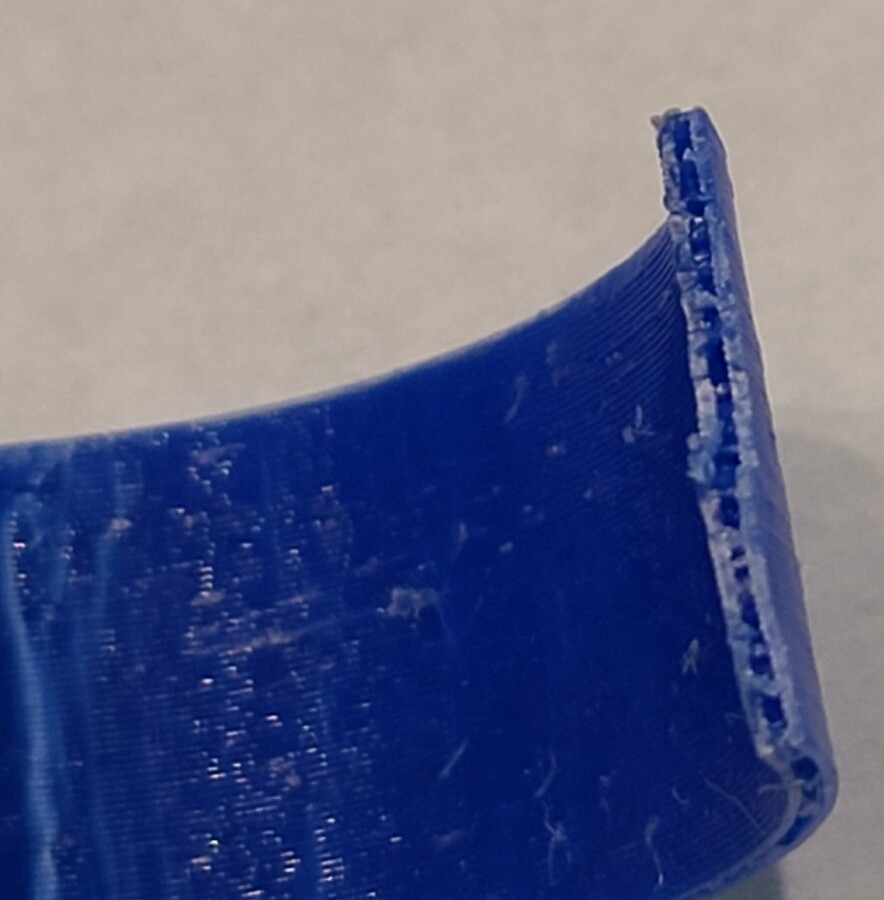

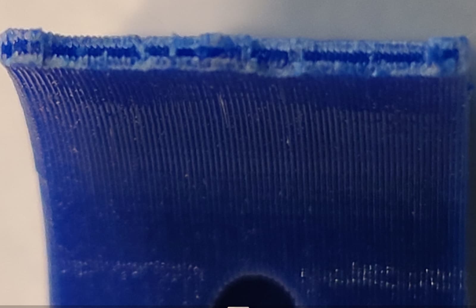

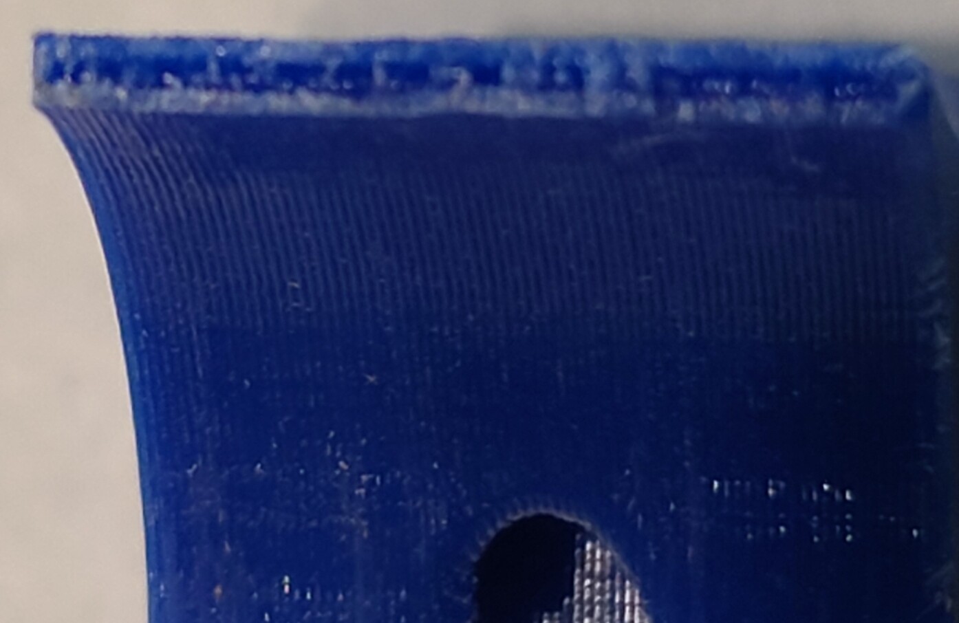

Even though I think using a less brittle filament is the correct approach, these photos seem to suggest that there may be other factors that could also affect this part.
Note that all three broke in the thinnest section. Note also that this is NOT layer separation. The fracture is across the layer. So, whatever the cause, the plastic is failing in tension. And it appears to me to be a fracture rather than some sort of elastic deformation, but of course that’s speculation.
Perhaps the most interesting thing in the photos is that there may be a gap between the two walls. The slicer suggests that this could be the case, as there is no infill at this point. So, one could wonder if a slightly different thickness of the wall could behave differently. I’m unconvinced that it would matter.
Fascinating. That does indeed look like a print defect (really, slicing defect.)
What slicer, what printer, and what nozzle /wall width were used?

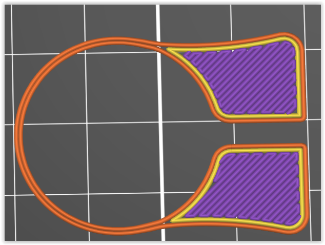

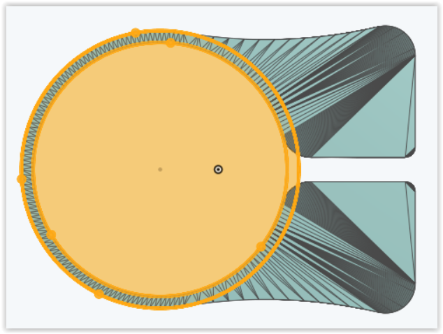

As for the wall width, I doubt that I can recover that. It’s most likely the default as I always start with that. In this case, that would be 0.68mm, apparently. The image shows the first layer in the slicer. There’s no gap apparent but there is also no infill.
I pulled the STL file into Onshape, and there, it appears that the wall thickness is about 1.2mm. So, with 2 walls, there would not be a gap if the numbers are correct.
Second image speed the Onshape analysis which fits circles to the part.

Personally ran into a slicer settings problem (cura) where I’d mistakenly ended up with wall width being too thin. Somehow, my 0.6mm nozzle profile had wall width mistakenly set to 0.44mm. no idea how, I fixed by editing to 0.68mm, and have been a bit more intentional about double checking wall width settings since.

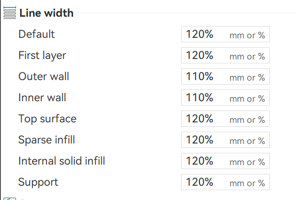

For sclicer settings see if you can use a % instead of a set value. I know in orca thats possible that way no matter what nozzle size you are running it will be correct.
There might also be a “detect thin walls” type setting in some slicers that helps (or hurts!) with this type of print.
