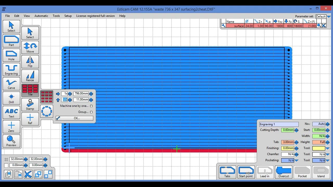

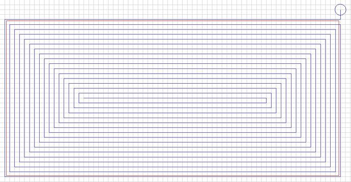

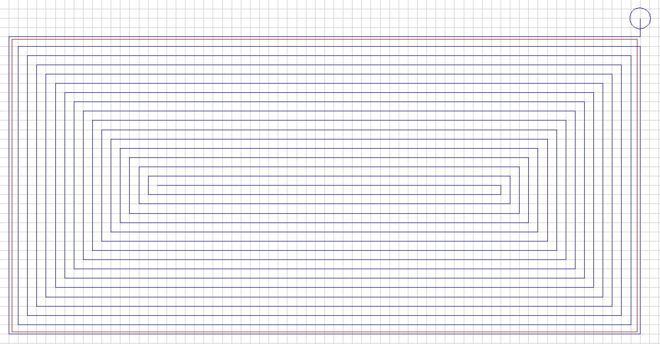

It’s unfortunate that there isn’t a true peel from outside option (VS a mid peel direction changing option that only works with island pockets). My workaround is to set the CAD or CAM grid spacing to the desired stepover, e.g. 11mm for a 25mm tool (~45%), and manually set a point to point spiral engraving path (after centering the board perimeter on the grid, e.g. 3 point center tool).
In my (limited) experience, you can achieve better results using unidirectional cutting (all passes running N-S, or S-N, or E-W, or W-E). It adds a bit of time to the cut because of the return travel, but the results are worth it (again IMO).
I recommend using @jamiek’ s g-code generator for this purpose. Select the “Surfacing” button, then fill in the parameters and speeds that you want. Check or uncheck the "G92 X0 Y0 Z0 according to your preference.
All I can say is that outside in square spiral cutting works really well on MDF, much better than linear…
The issue with bidirectional linear surfacing is the direction changes, switching between climb and conventional cutting. A generalization is that deflection is towards the cut line with conventional cutting and away from the cut line when climb cutting (anyone who’s hand routed an edge has experienced the directional in/out forces). Any tool/spindle/carriage deflection tilts the cutting face of the tool. The result is that the surface of the cut path will be deeper at the cut line when conventional cutting and shallower when climb cutting. With bidirectional cutting the result is a stairstep surface (unidirectional stairstaps = tilted spindle) and is more noticeable when using a large diameter surfacing tool.
At least with MDF, I’d be surprised if there was a noticeable difference in the surface finish of a peel path (unidirectional spiral) and unidirectional linear paths. The former takes more CAD or CAM time, the later takes twice as long to machine.
It’s pretty easy to create linear unidirectional surfacing paths with Estlcam. In the video the first manually set path sets the starting edge (bottom) and cut direction (L to R). I lengthened the path so that all Z moves are off the material (no direction change dwell marks) and moved it down so that it only removes my chosen 11mm stepover. I then used an 11mm tile spacing to cover the rest of the board and set the machining order to As created.
…To have the option of taking additional passes: (Edit >) Group the tiled paths, Tile the group some easy to remember distance, change the new group name(s) and Start depth(s), set machining order to As created and Move the new group(s) onto the original group.
This is easy in v11, v12 having separate path and group names and tiling the group as separate paths instead of a group of paths (the Tile Group option makes an un usable/fixable mess) took all the fun out of this little experiment, i.e v12 can be a nonsensical PITA.
