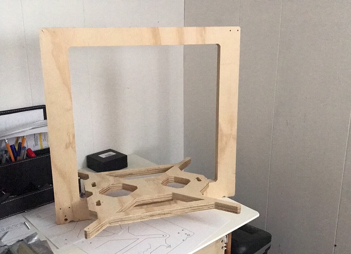

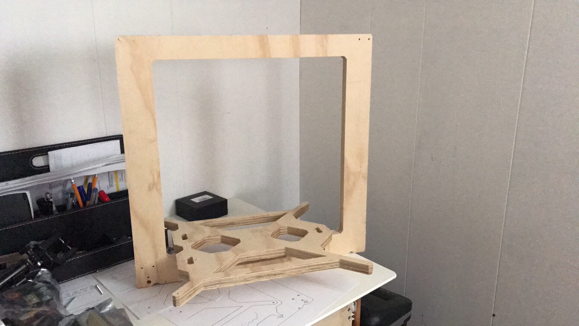

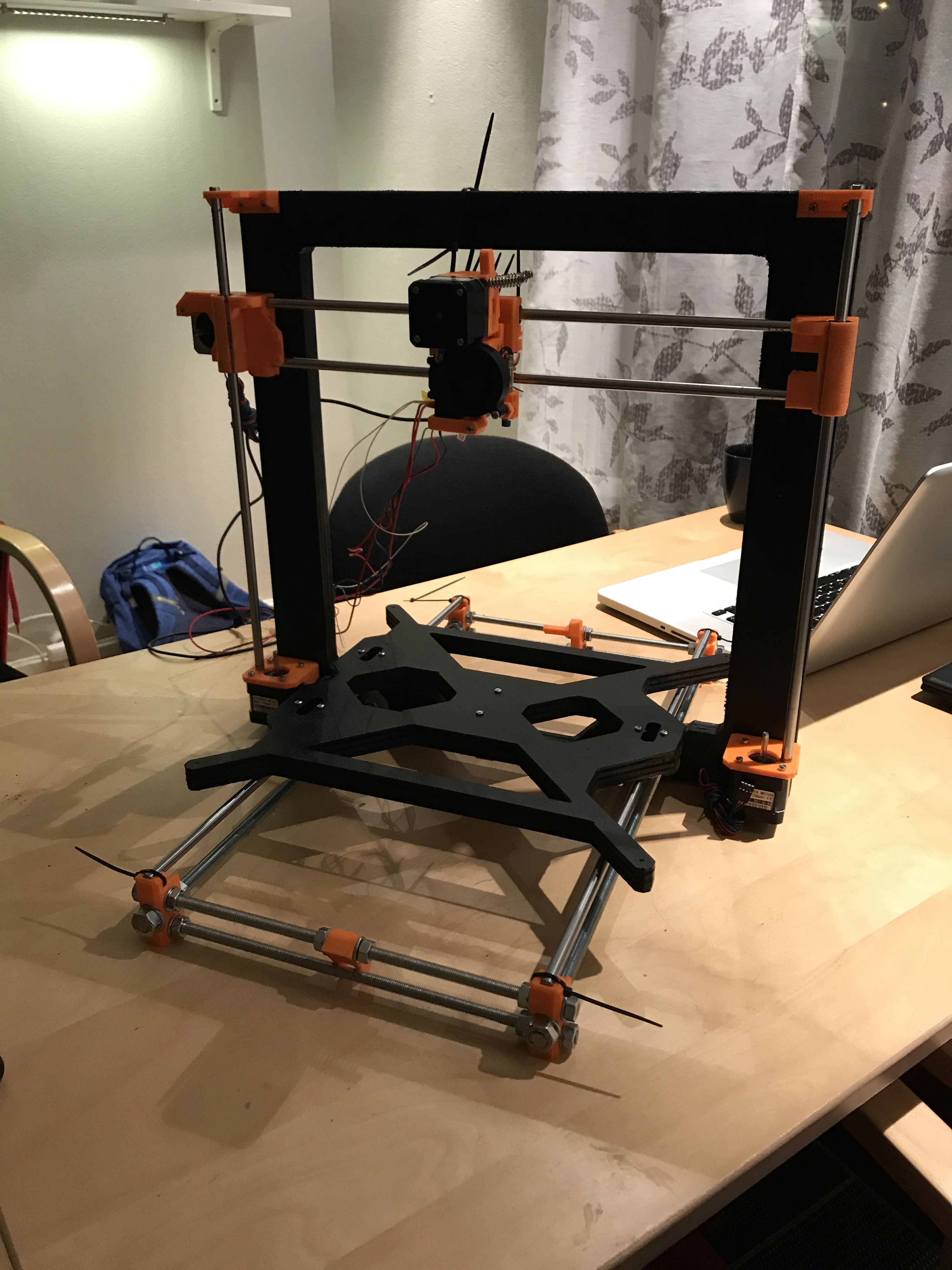

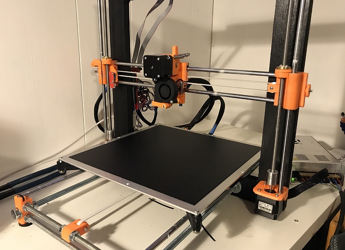

Frame cut on mpcnc

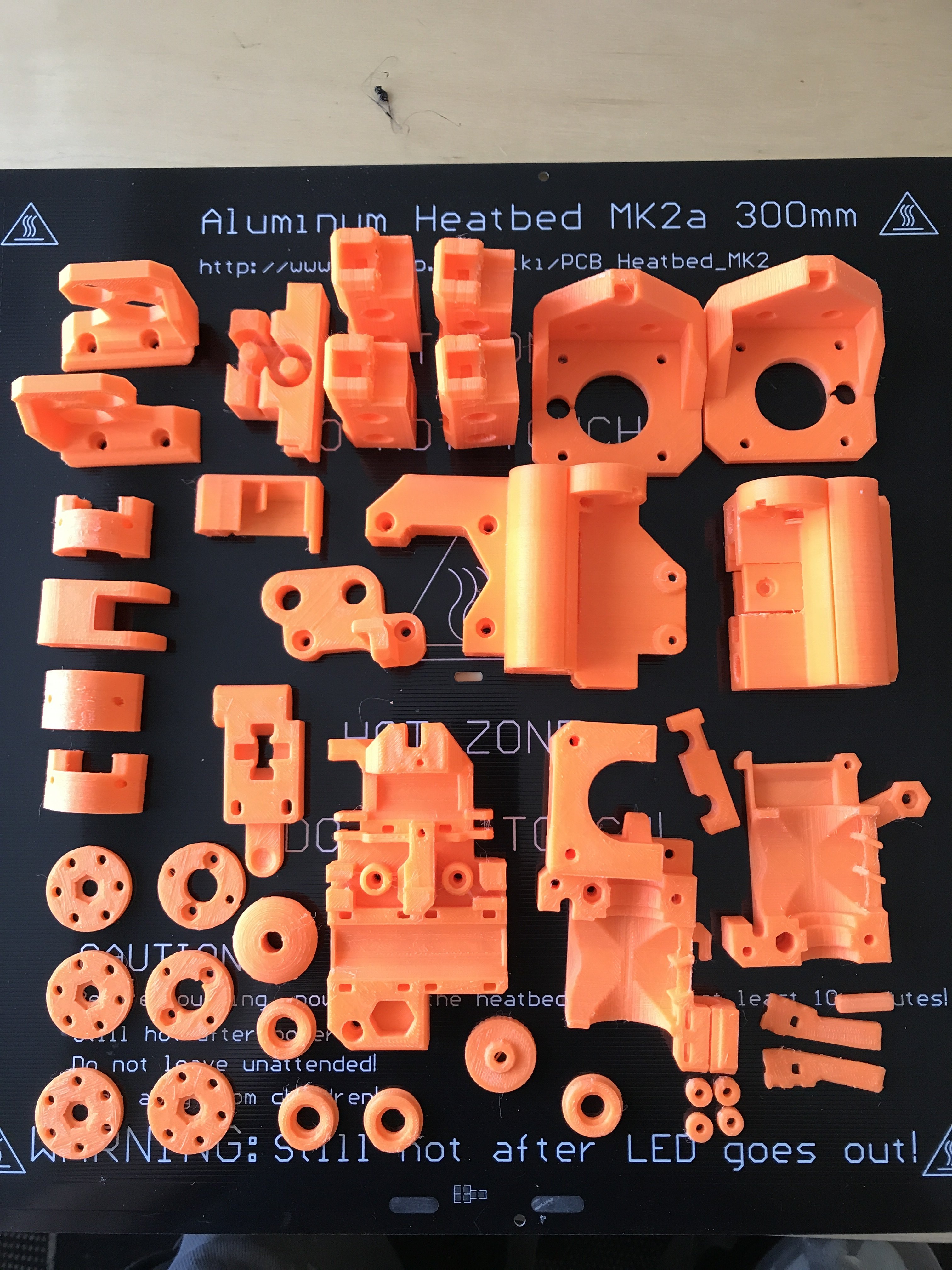

[attachment file=44252]
heating bed 300x300
Nice! Looks great.

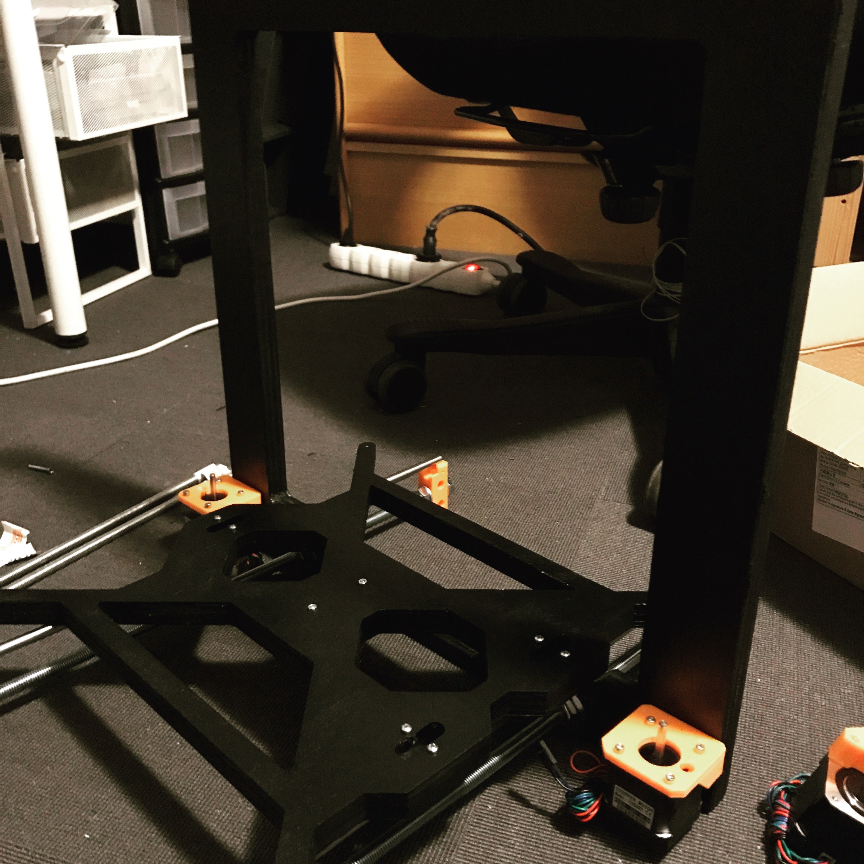

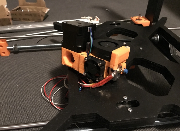

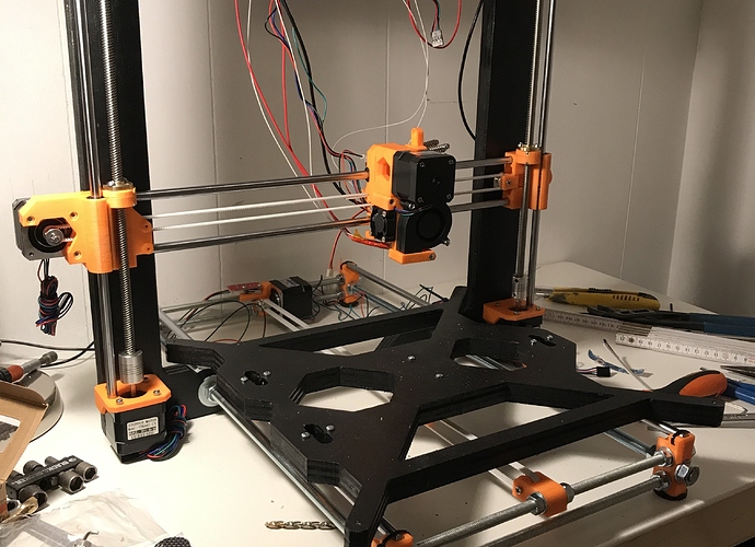

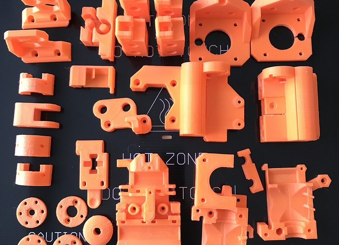

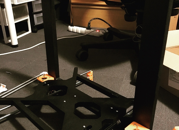

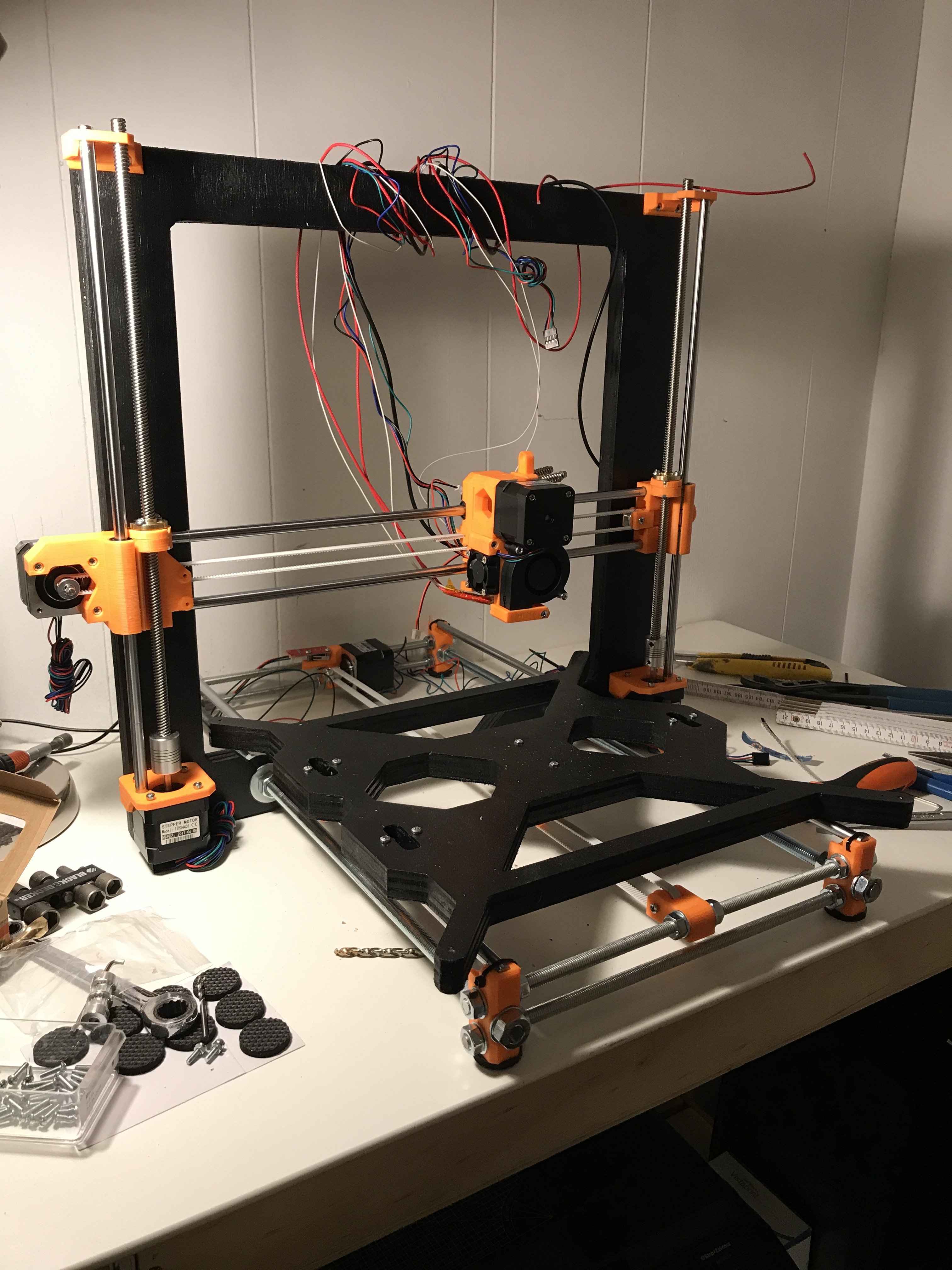

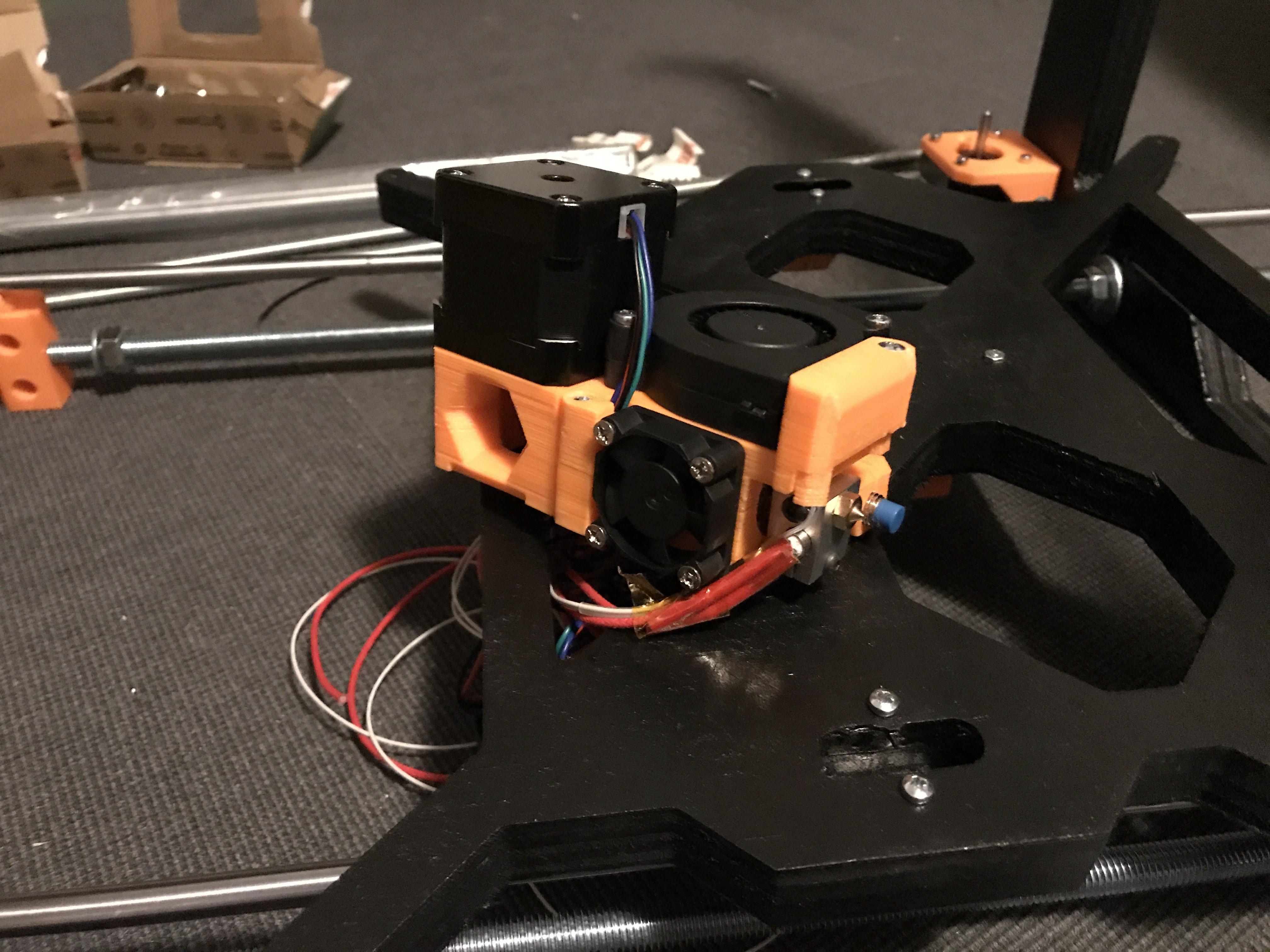

Thanks Johnny. Small update for today progress. I put most of the parts together I’m missing one bearing for extruder. 625. I will cut rods tomorrow when I will see how long they need to be. I’m just wondering what quality of print I can achieve. will see.

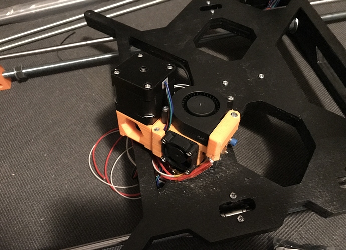

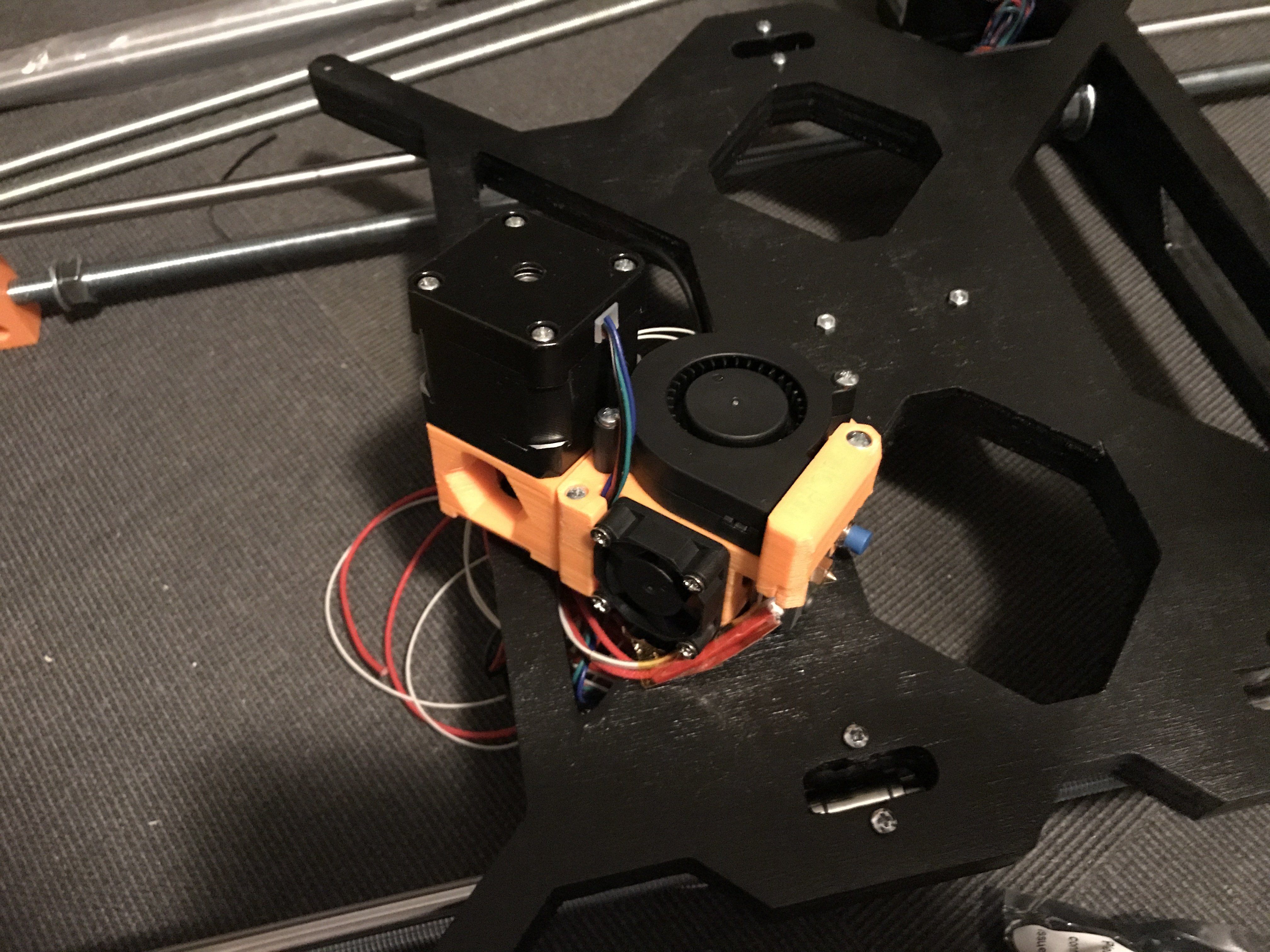

[attachment file=44306]
[attachment file=44307]
[attachment file=44308]
That is going to be a rugged machine. The first print is going to feel great after doing a complete build.
Looking back at the pictures closer I realized why everything looked so familiar. Looks like you are building a Prusa i3. As long as the axis are perpendicular and the movements are smooth I think you will get very good quality prints. I have an Original Prusa i3 MK2 and its an impressive machine. No reason you can’t replicate the results. Can’t wait to see how it turns out.
Im super excited how those parts are designed. all things are fitting so smart together. Just wow :). I will try to hit the best print result I can achieve don’t meter time of print but quality(in reasonable time). For prototyping I will build another printer with bigger nozzle and titan extruder. with totally different style of frame.

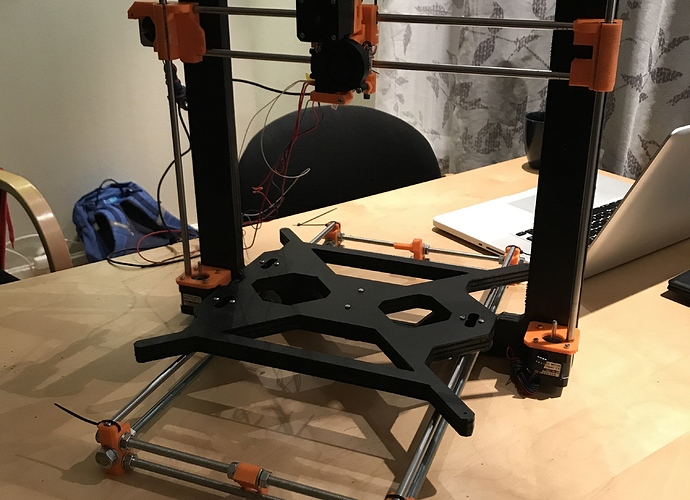

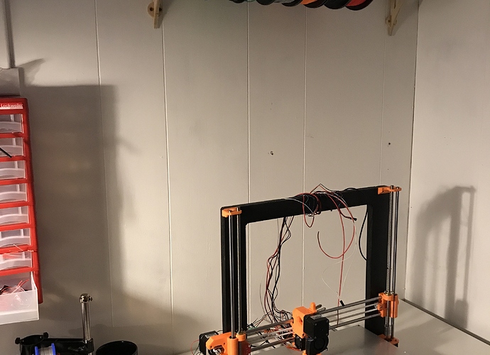

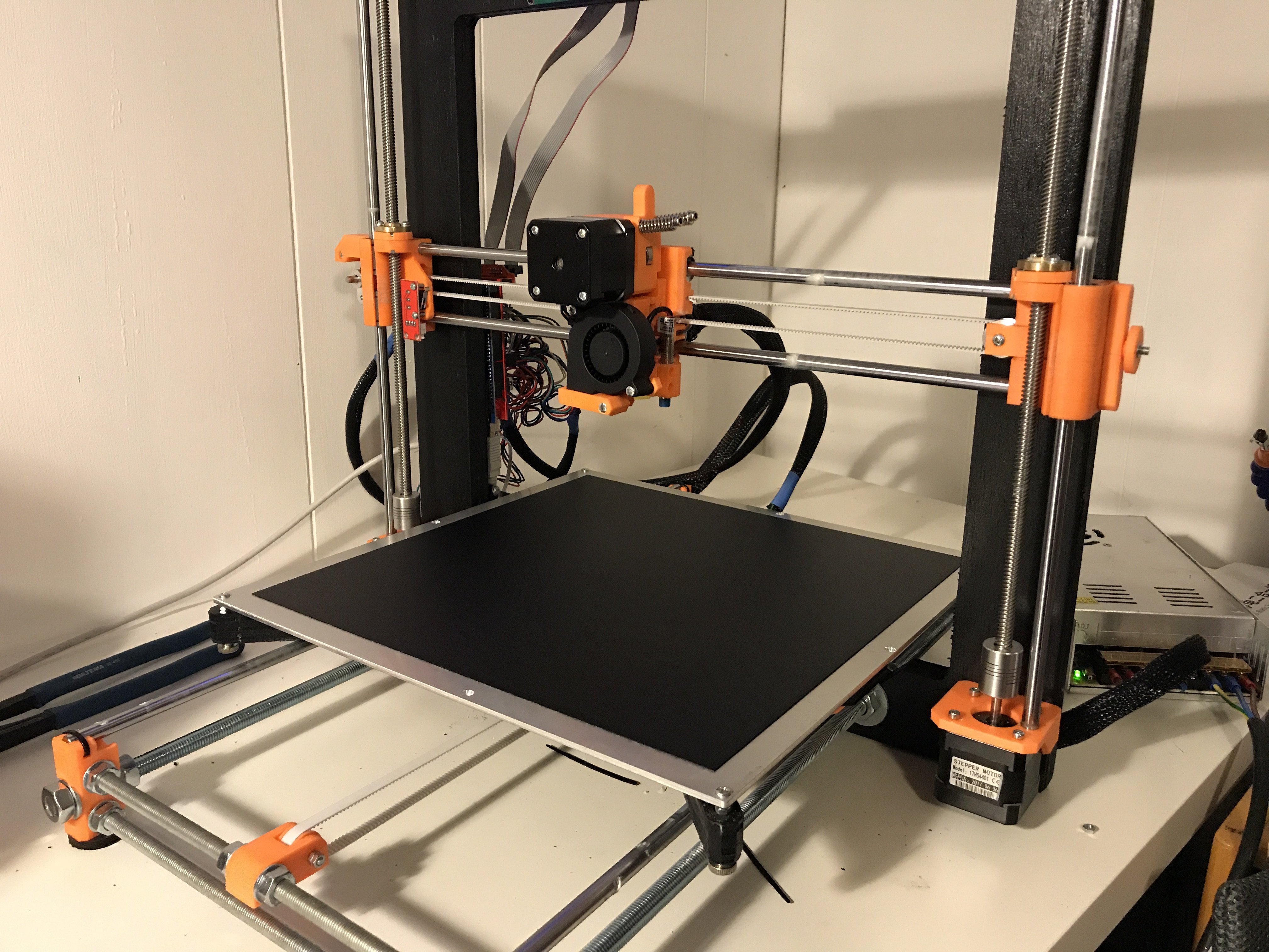

all smooth rods cut to lengths also all M10 and M8 cut to length it was little bit tricky because this printer is bigger then original purse bed is 300x300 hight don’t know exactly but around 300:D like always some pics for you guys.[attachment file=44363]

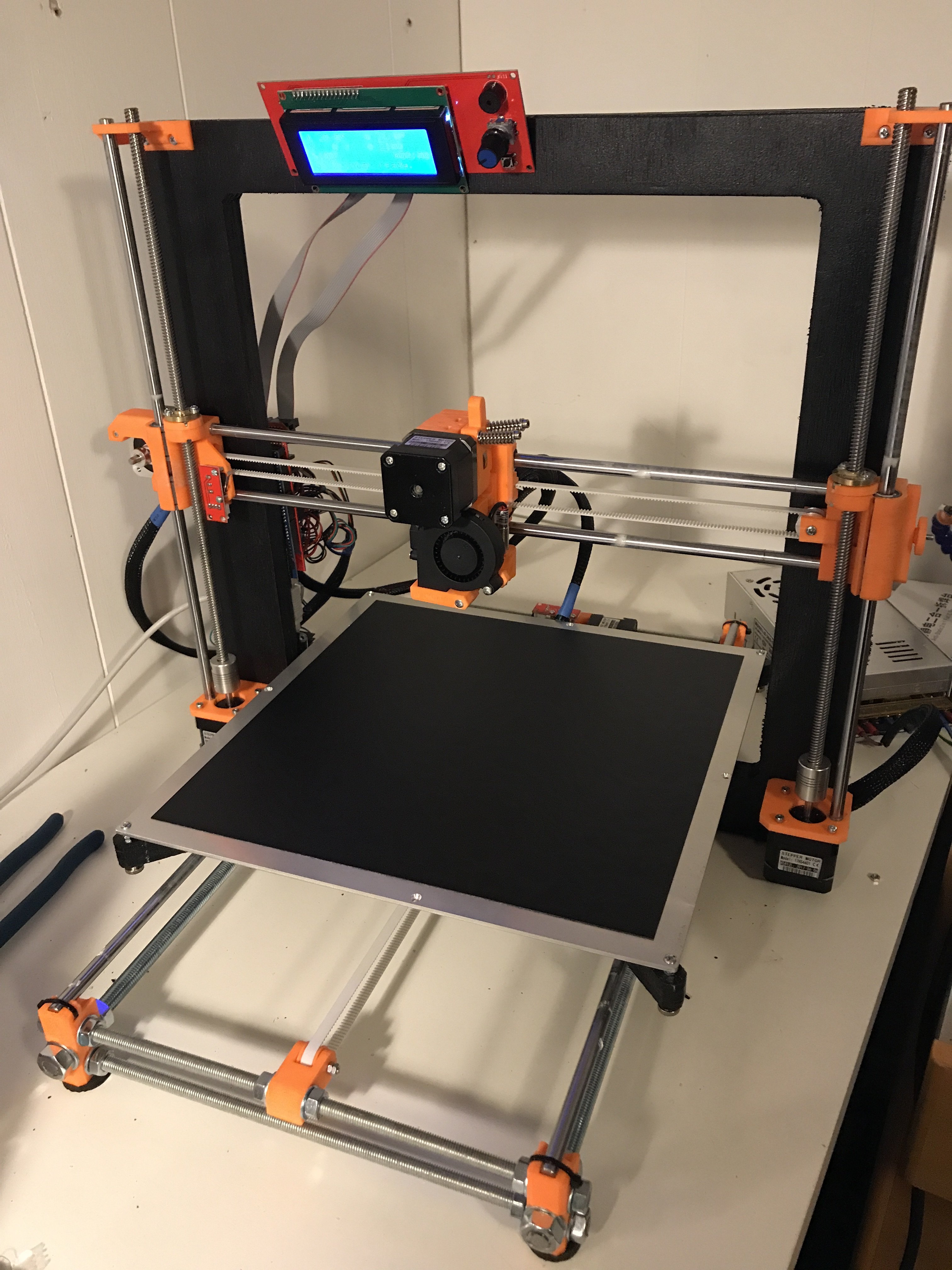

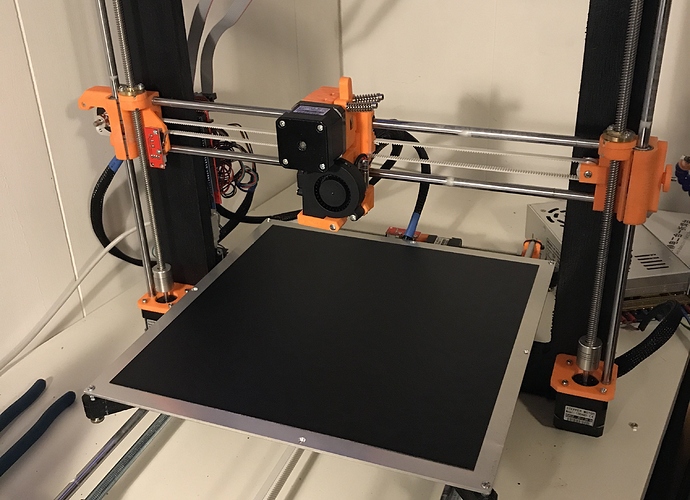

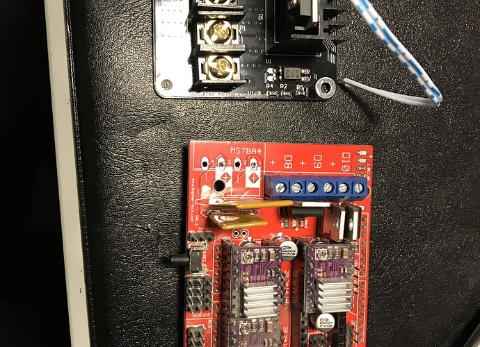

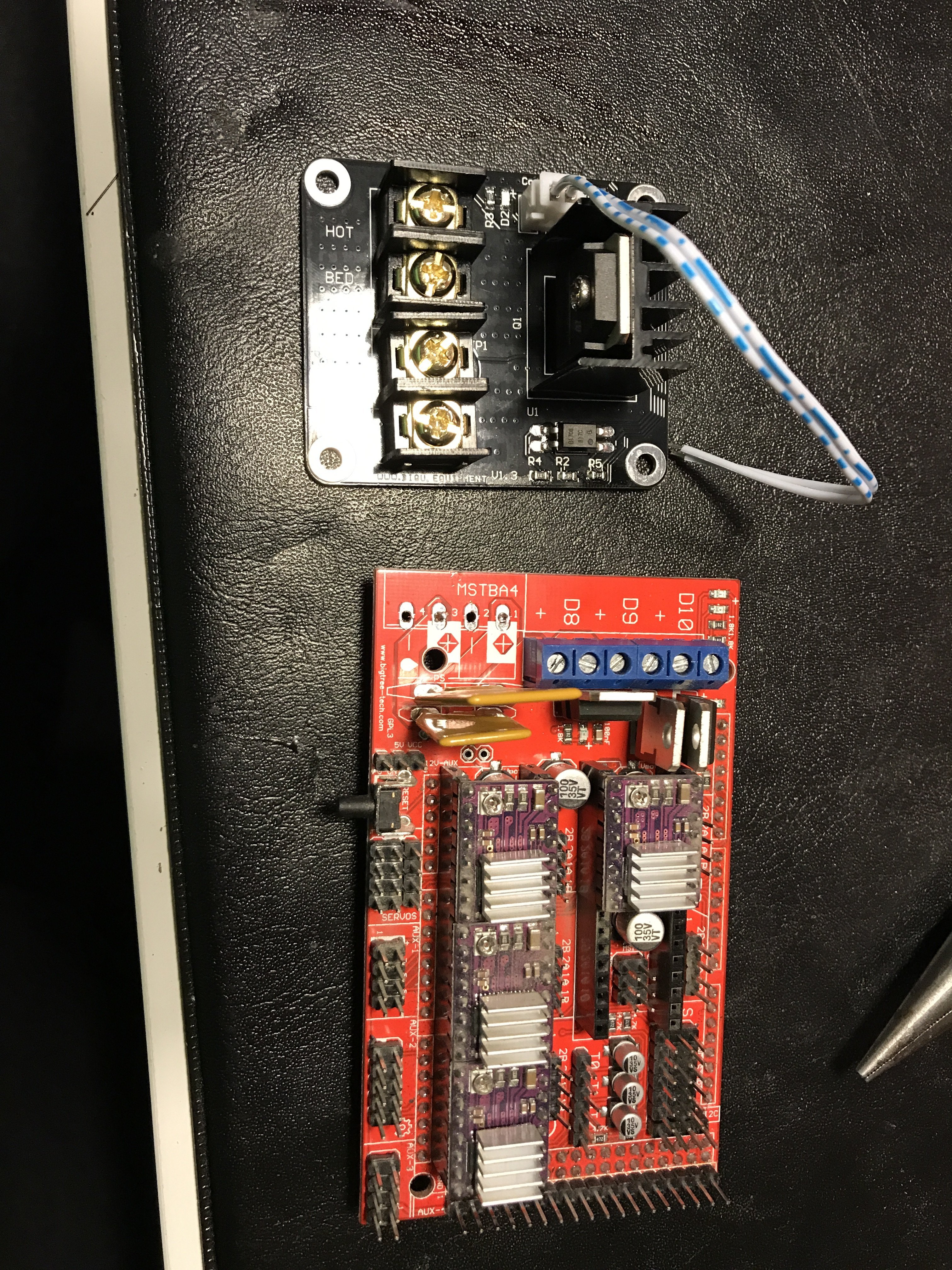

Small update all motion parts are on place tommorow i will start wire it up and probably start power suply 12v 30A aluminium heated bed 300x300 (this will be tricky becose they send me only plate without led sensor so i need to reuse some parts from my old printer and re solder them in place.) on top of Alu plate will be build surface under filc to isolate wood from heat.
[attachment file=44770]
[attachment file=44814]

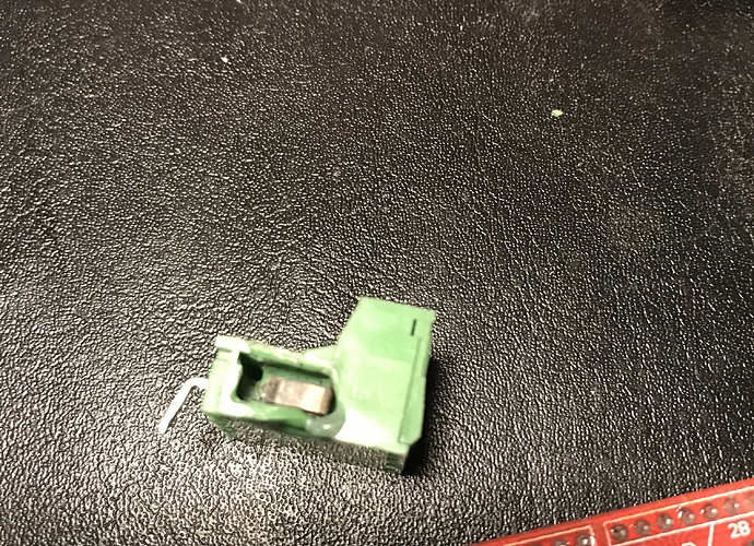

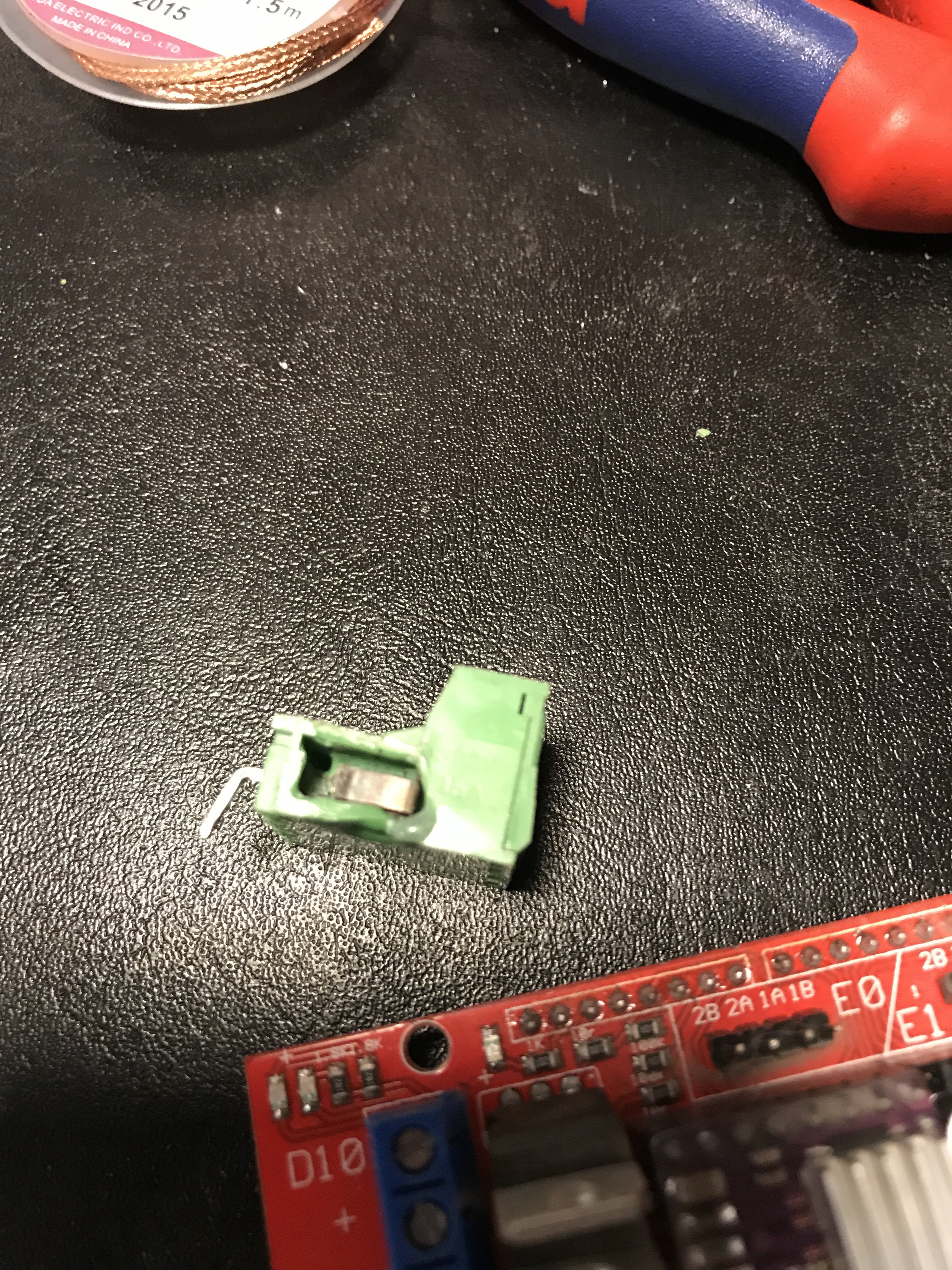

Small update im slowly finishing wiring staff im waiting with gluing build surface becose proximity sensor is 2mm and build surface is quite thick. I take apart my old printer and this is what i see
[attachment file=44815]
New printer will have this
[attachment file=44816]
im just having Hope that i can start it today.

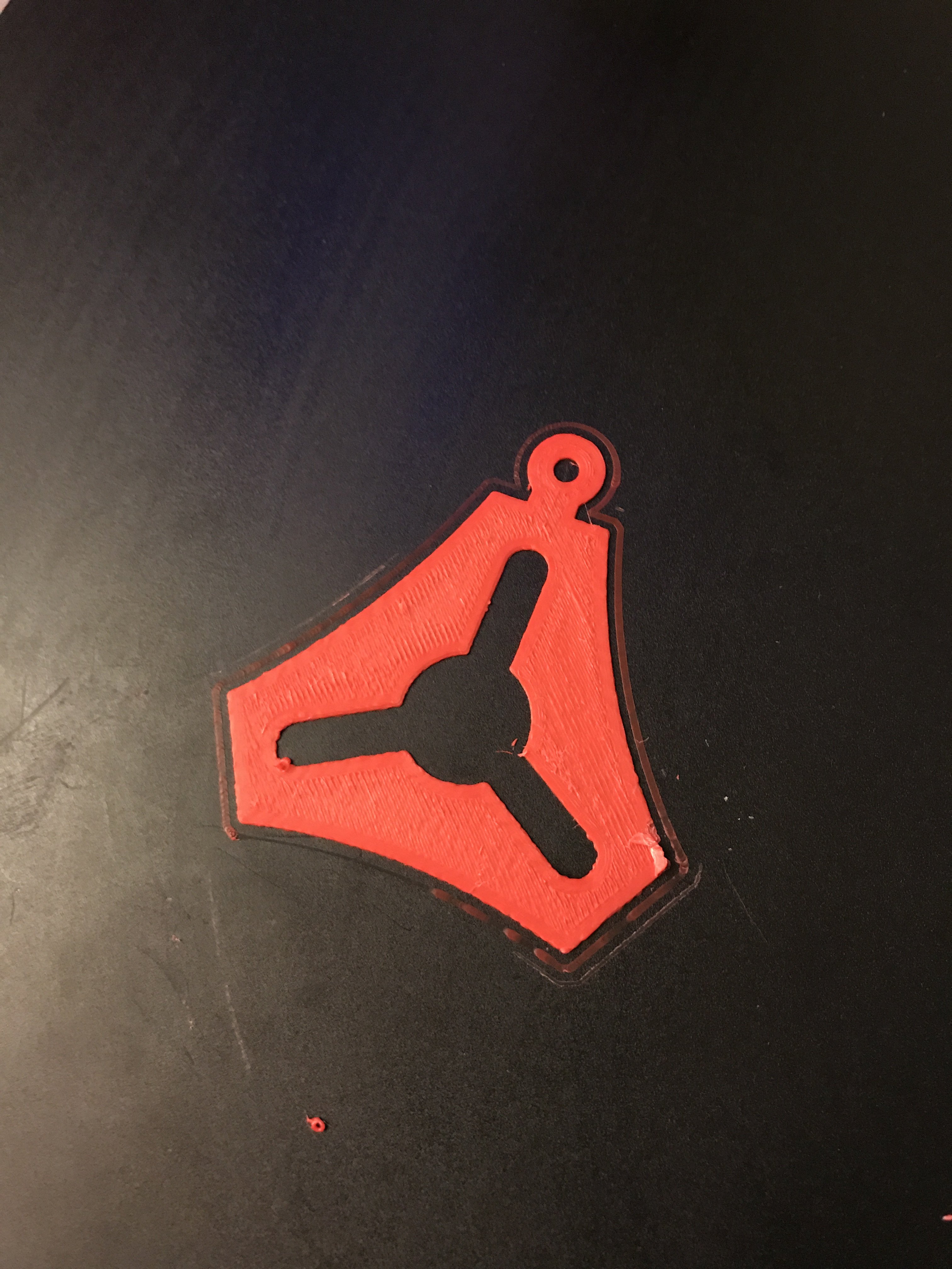

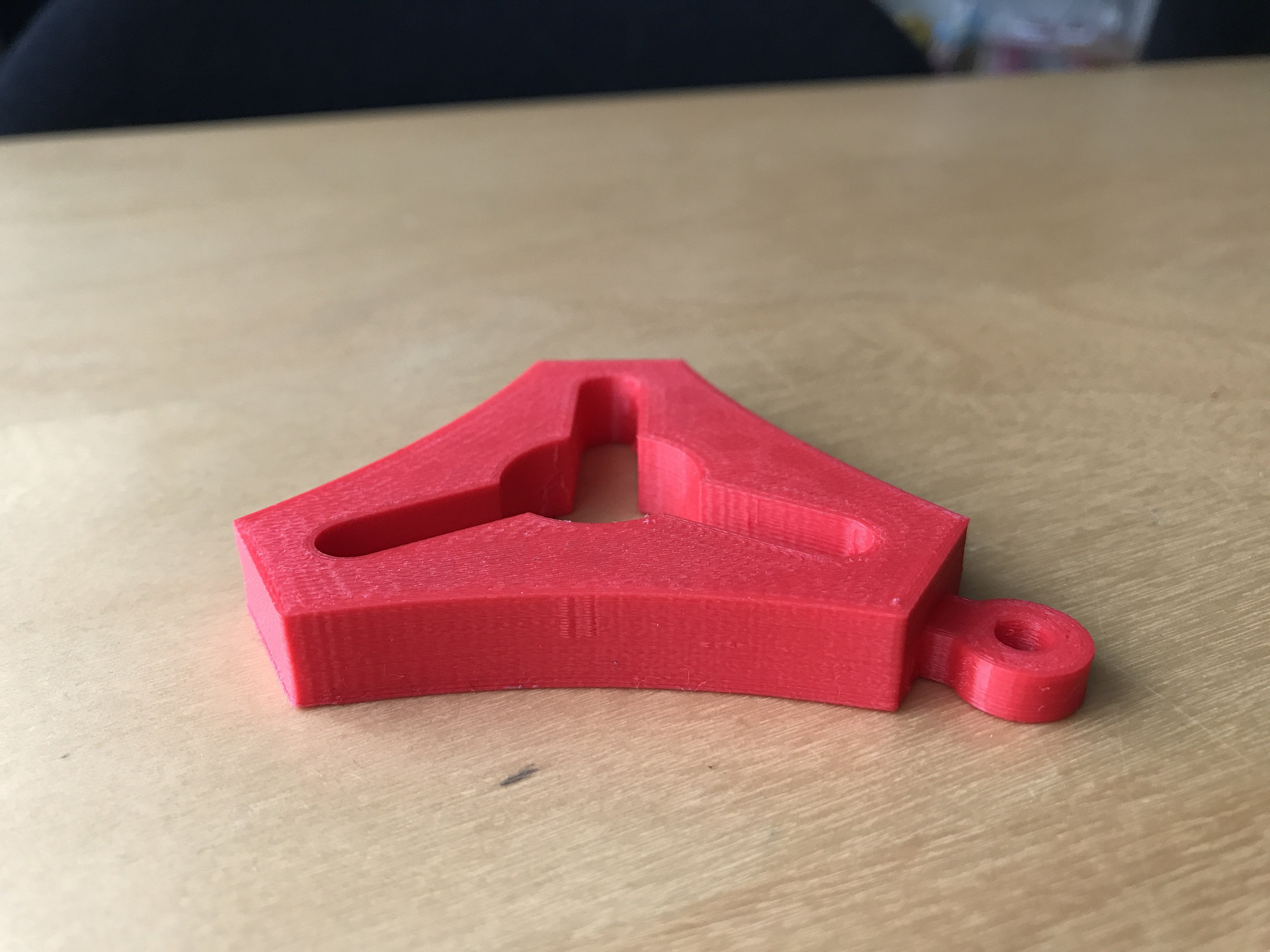

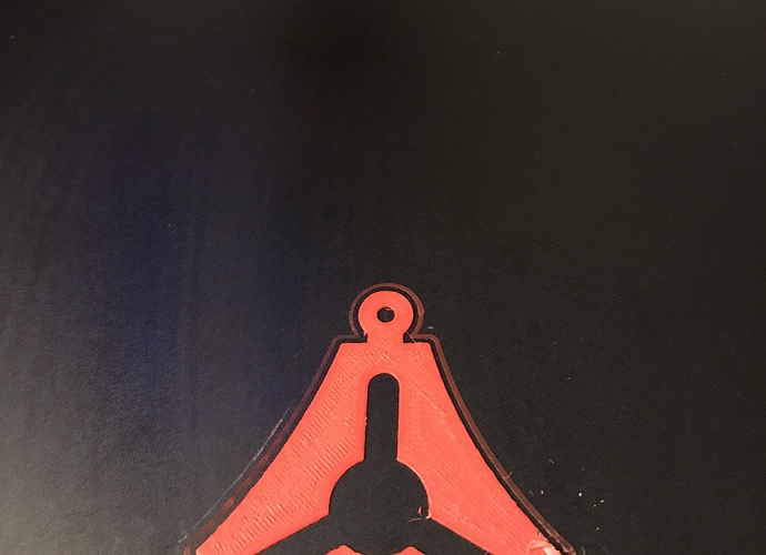

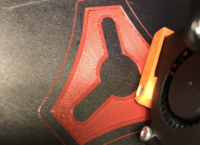

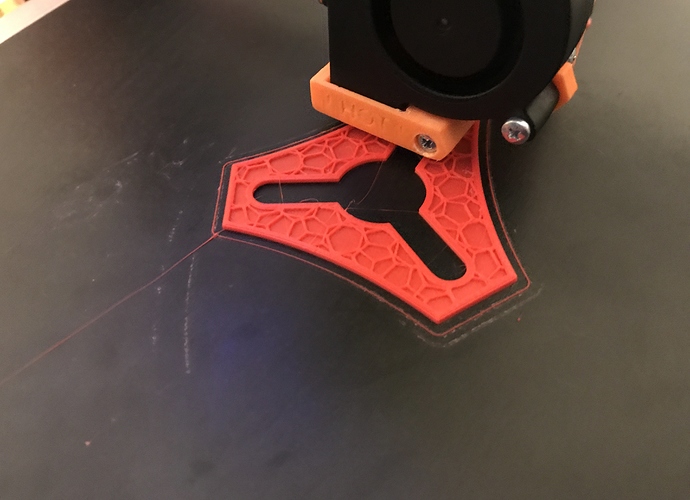

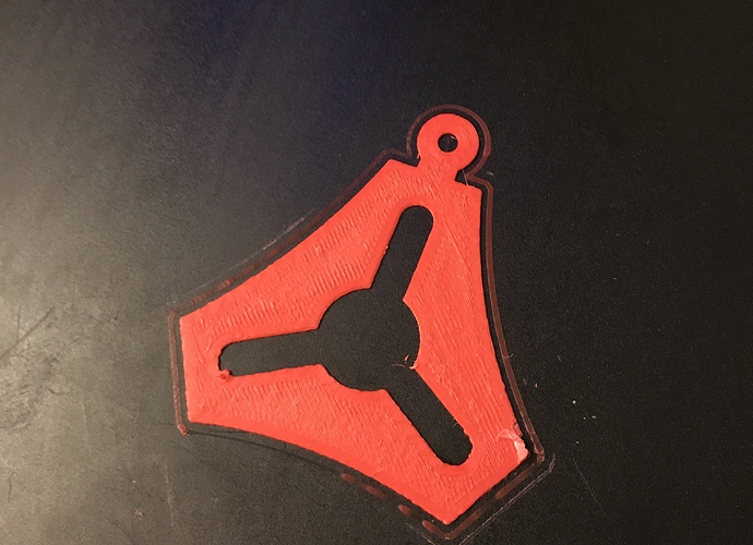

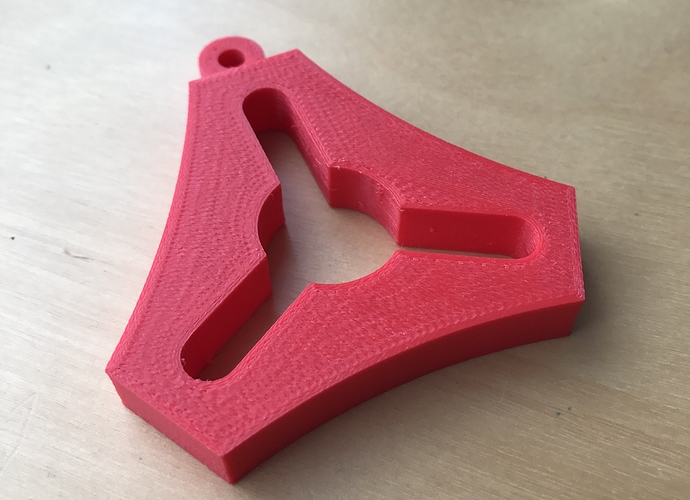

What you guys Think extrusion multiplayer or first layer hight
[attachment file=44878]
You should not have to touch extrusion multiplier unless you have bad filament. I bet first layer height.

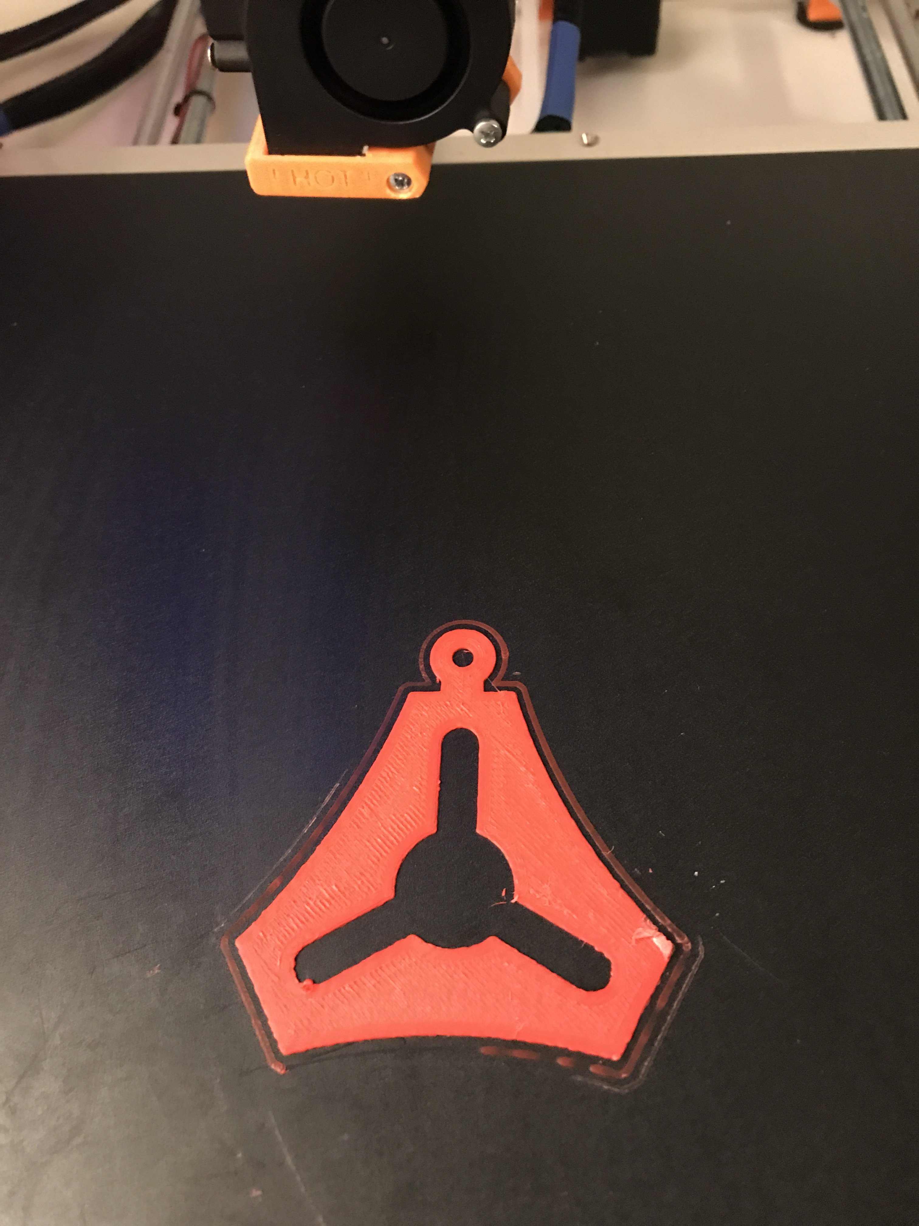

Ok Its better but still i need to Tune it
[attachment file=44888][attachment file=44889]
Its look like i have some over extrusion
Congrats! A print!
Yeah you were just too high on the first one, the bead just wasn’t squished enough. Maybe a bit too far the other way on the second.
Thanks guys I’m getting there just need to nail this down. What I seen yesterday that its look like M851 for z is not working when I’m using M29 so probably I need to make change in firmware sensor is just working perfectly I have even stroke on bed but I just need to go lower so I think I will just change probe offset and it should fix problem my settings for now

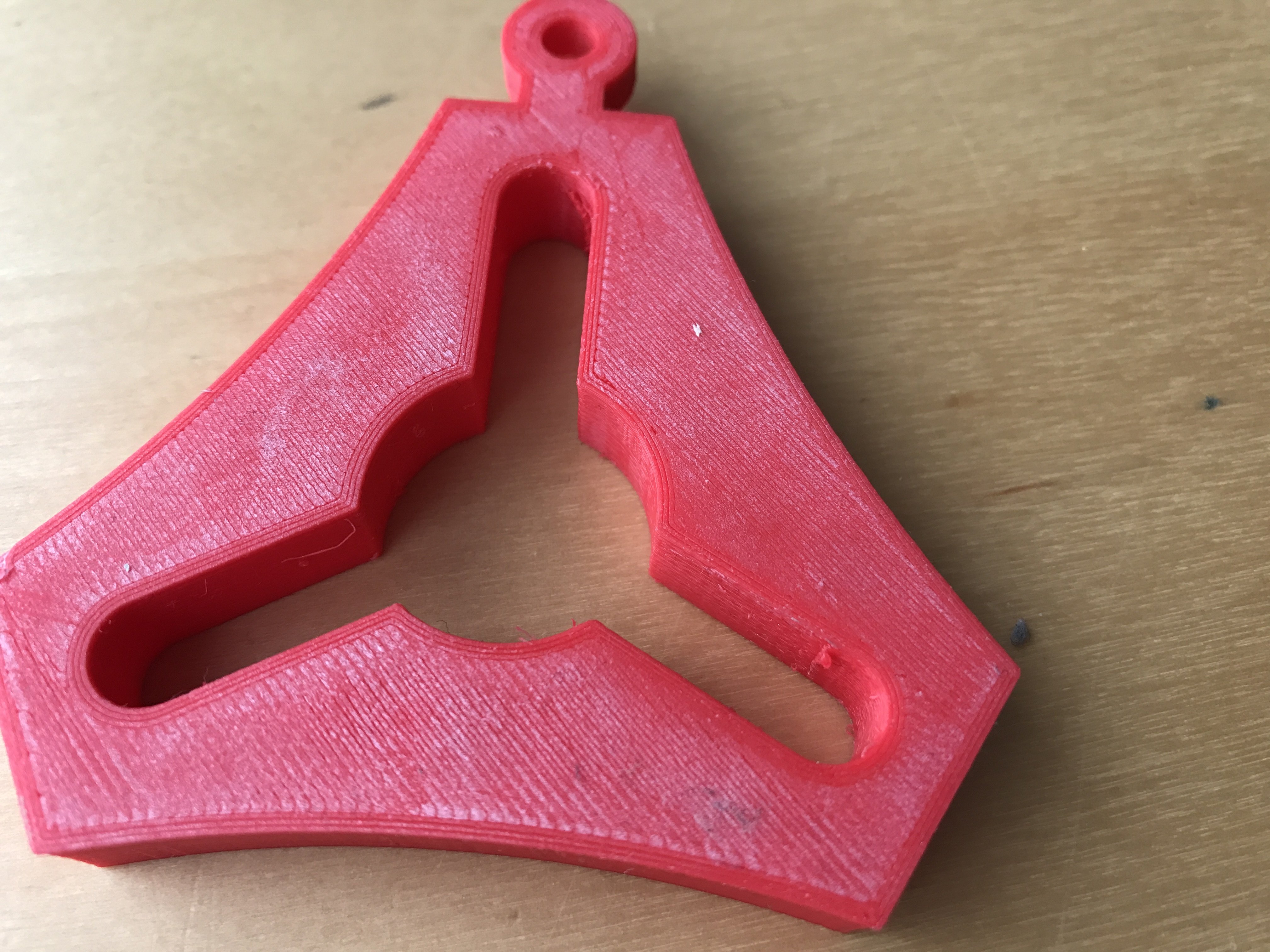

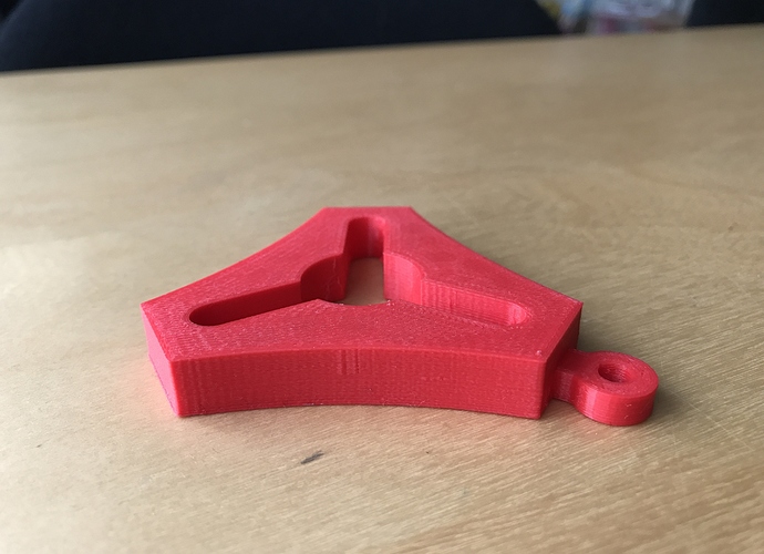

Nozzle 0,4
multiplayer 1
extrusion width? Manual 0,40 (it was 0,48) probably I need to change it to 0,45 when I lower novel
Nail it

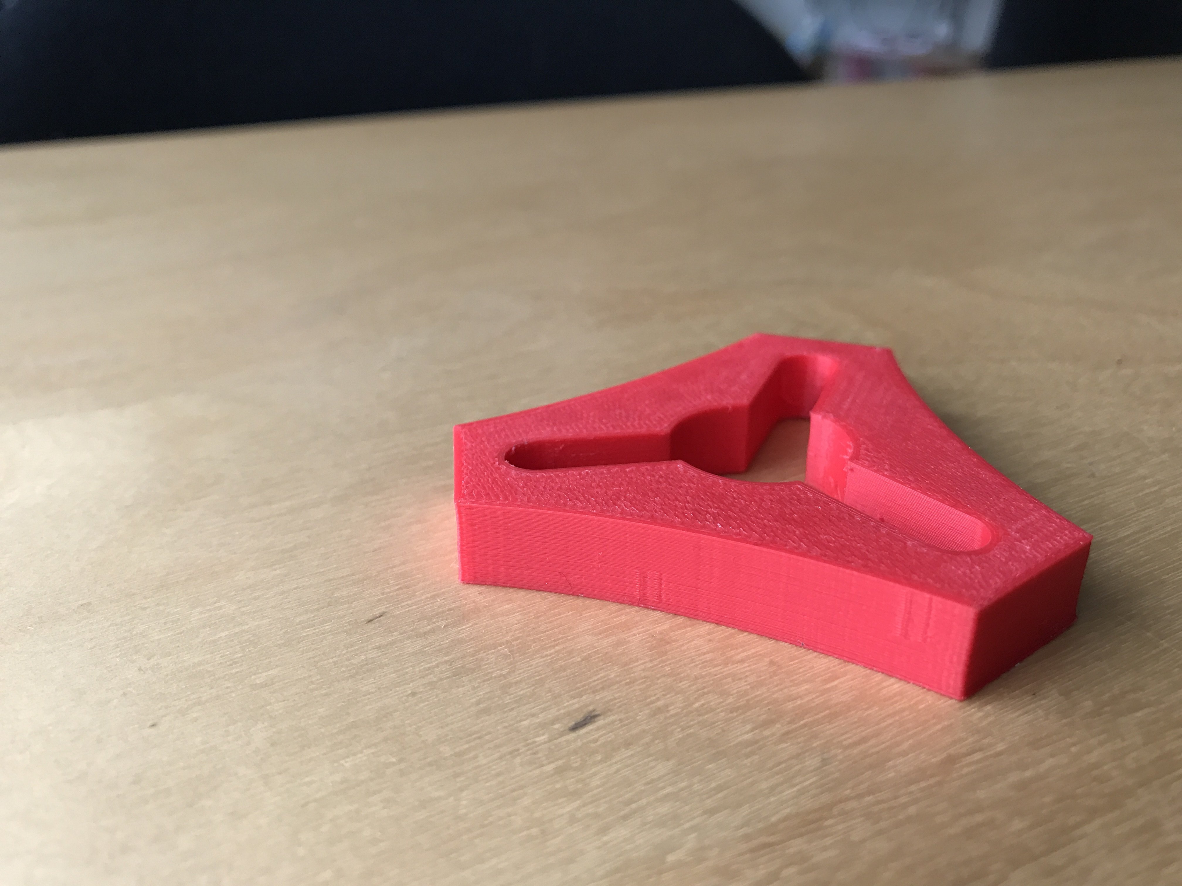

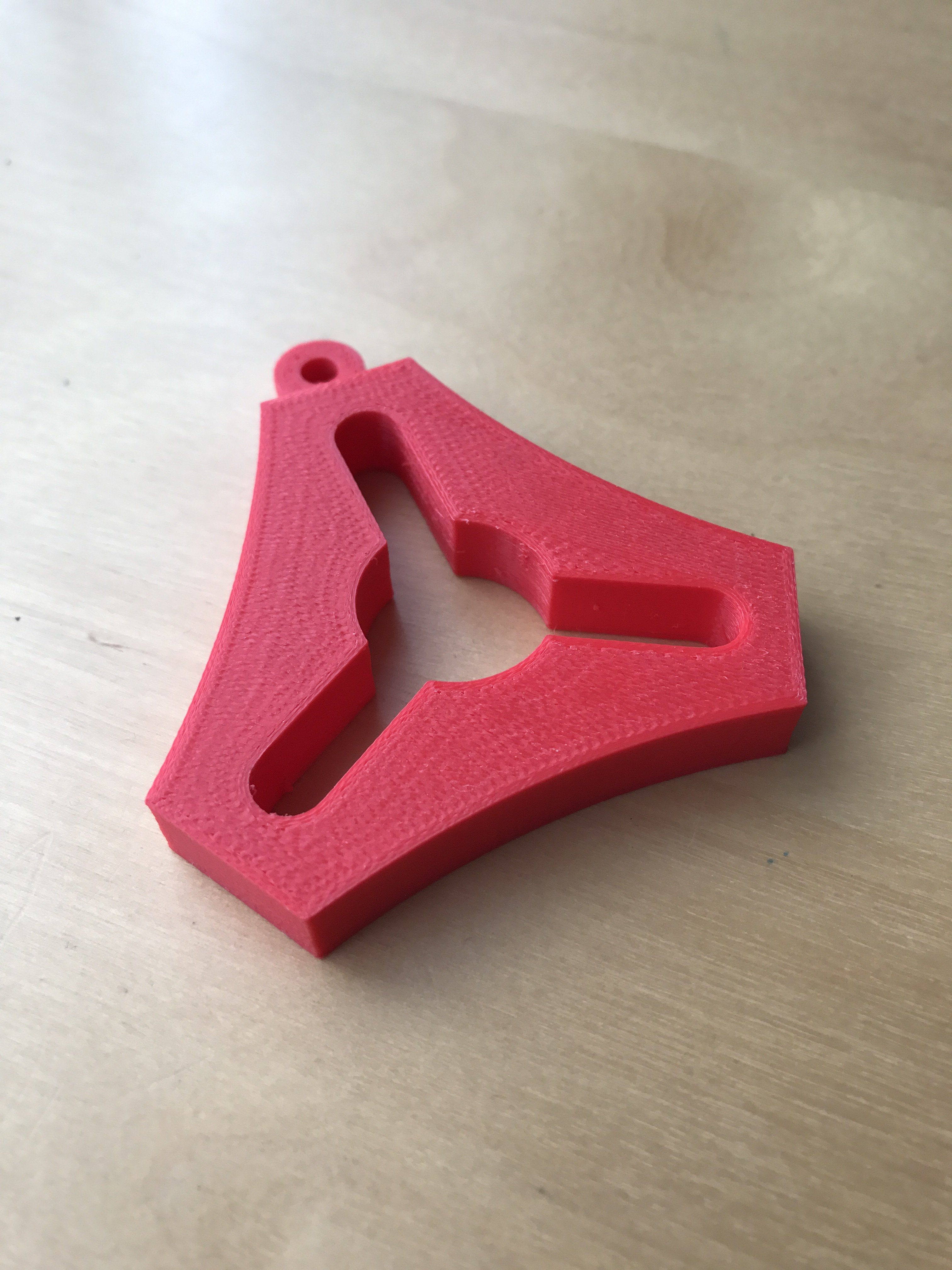

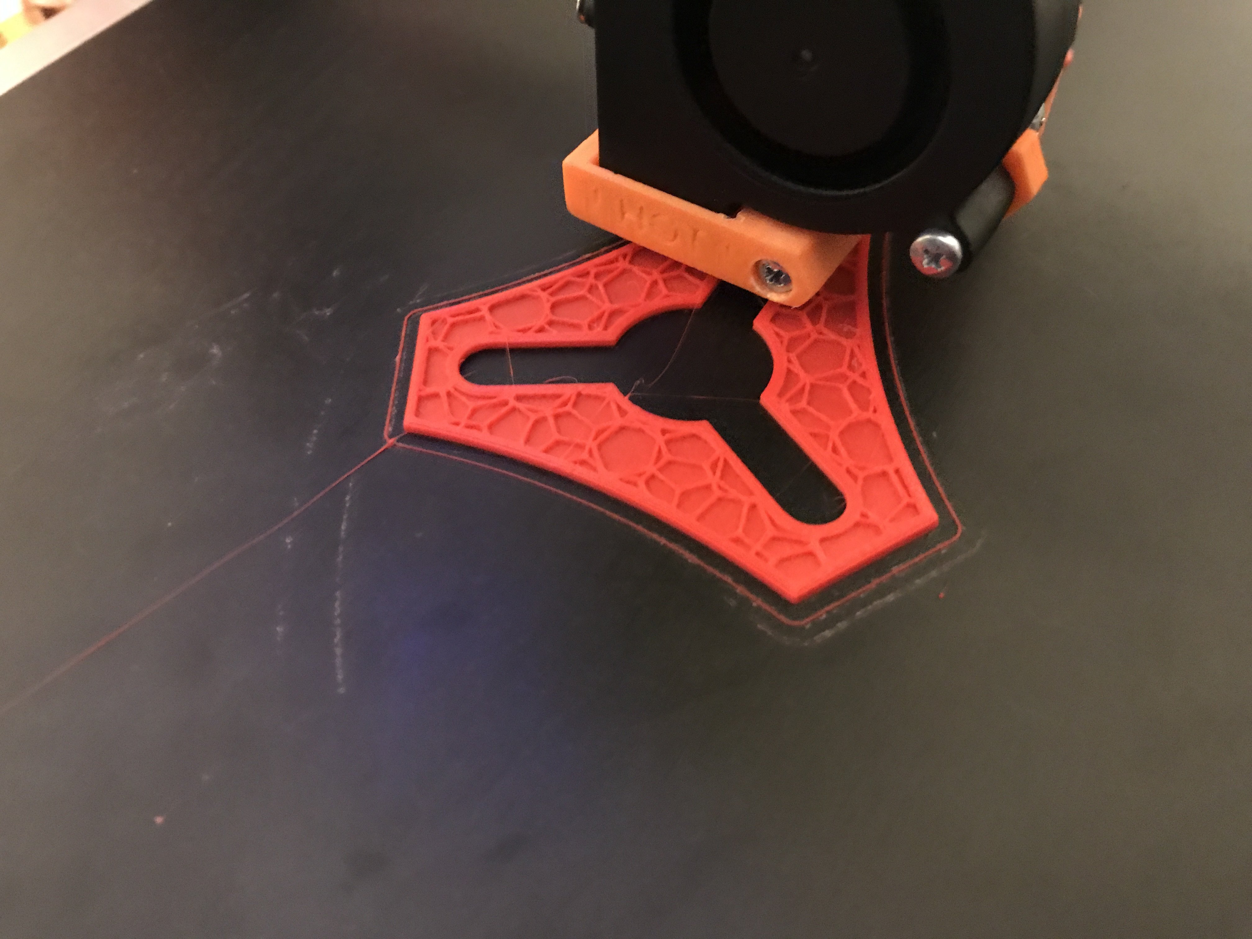

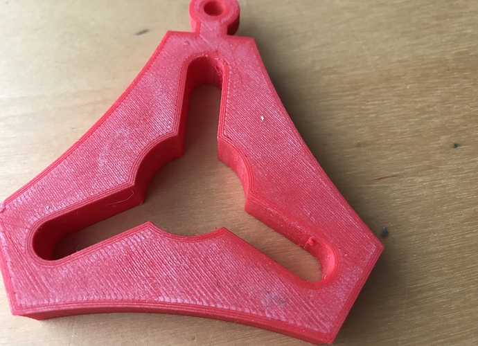

[attachment file=44957]
Ok result of print
[attachment file=44969]
[attachment file=44970]
[attachment file=44971]
[attachment file=44972]
