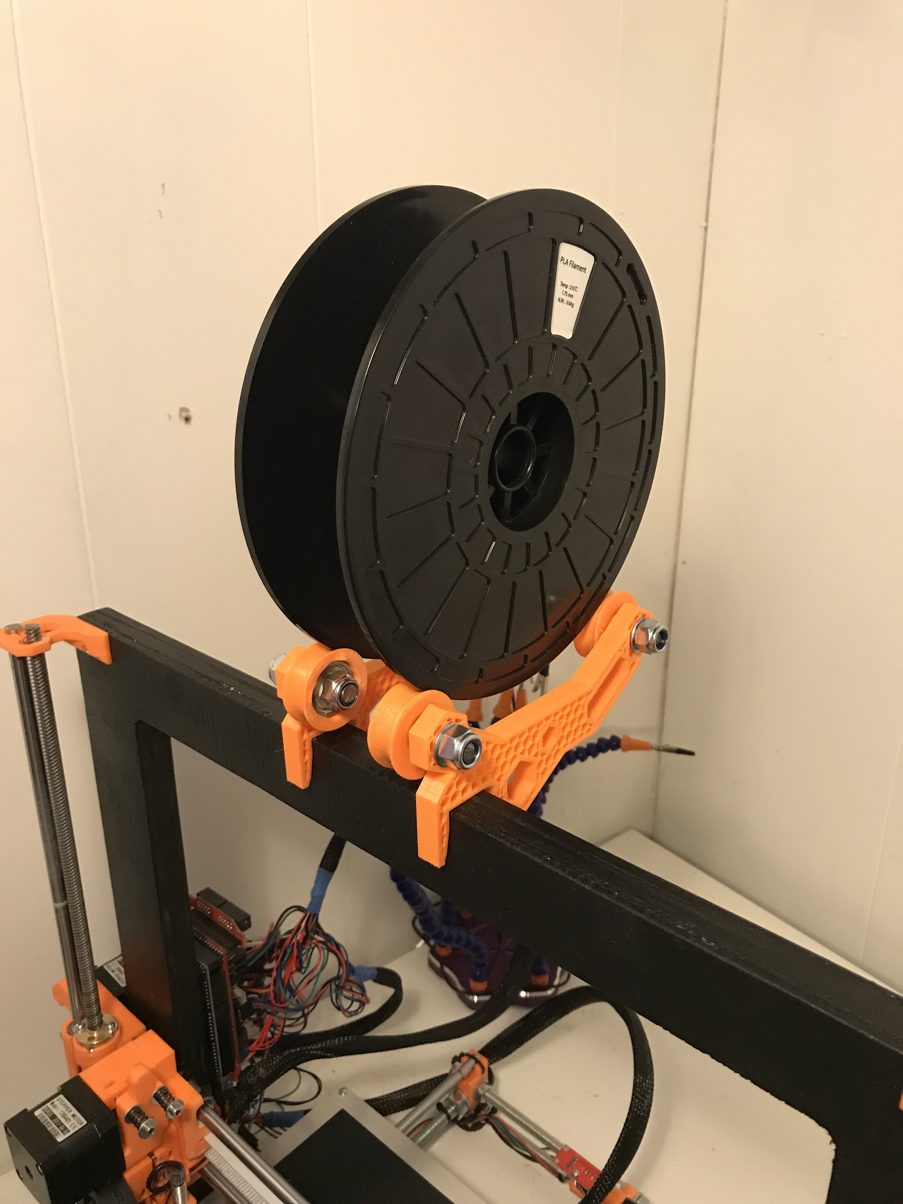

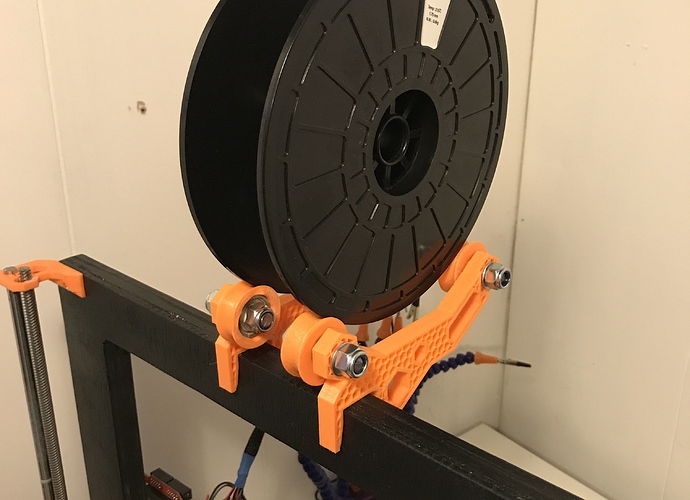

  • I print some modify spool holder to fit my frame

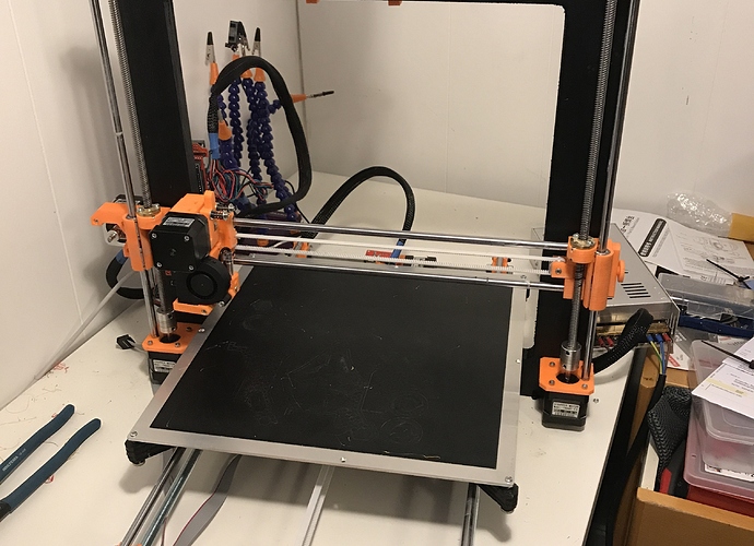

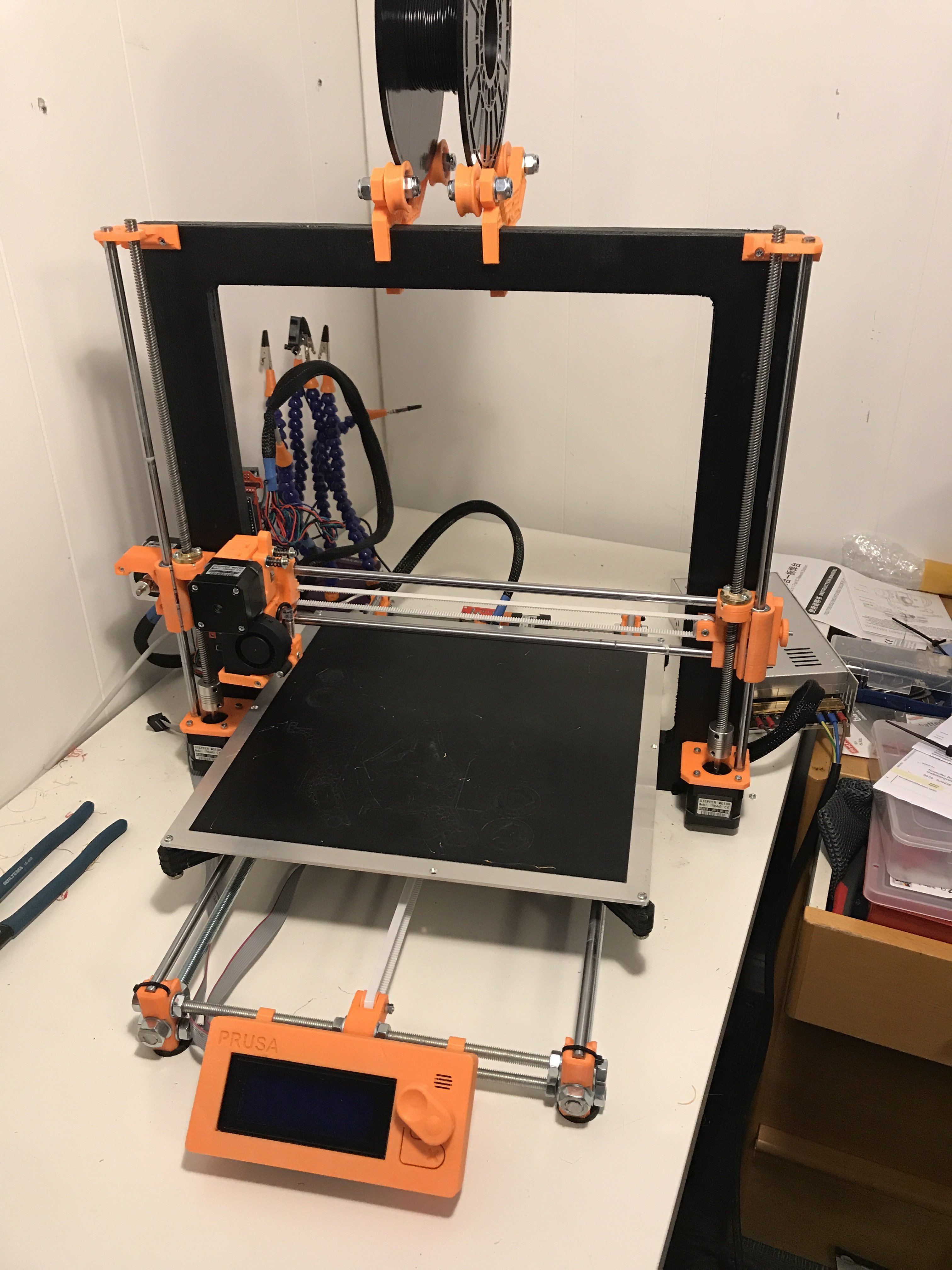

  • And I add screen on the front
[attachment file=45119]
As for now I think that’s all until I get my Abs spool then I will modify extruded to get filament sensor and probably I will also make so when printer is finish power will go off when evrything will cool(especially hotels)

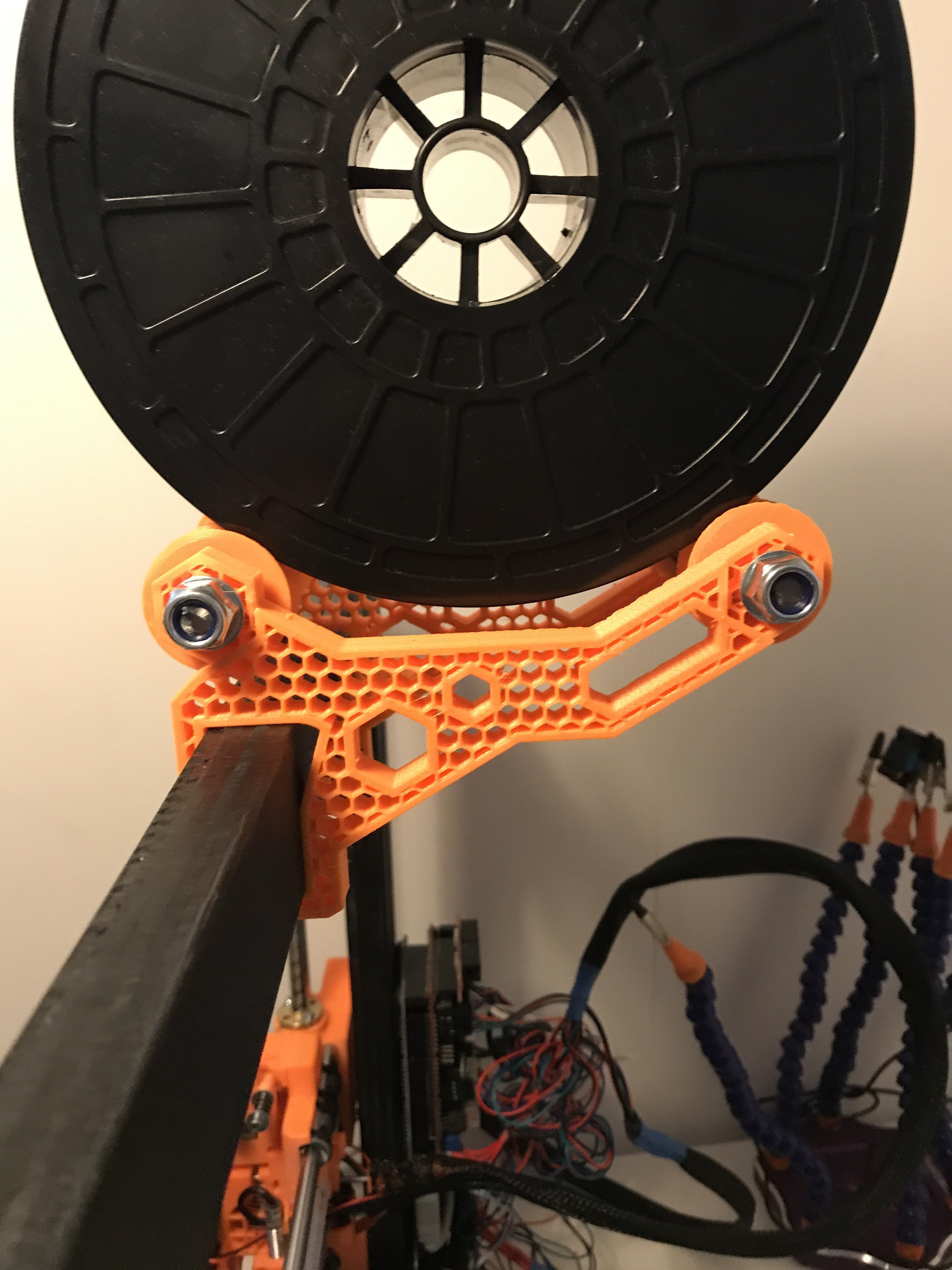

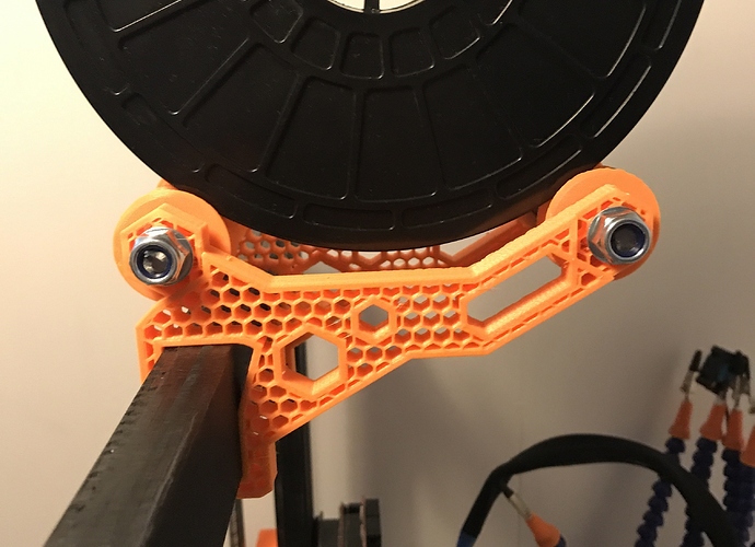

That is an odd infill pattern.
If I got remember that is fast honeycomb from simplyfy3d spool holder have full honeycomb printed without top and bottom
