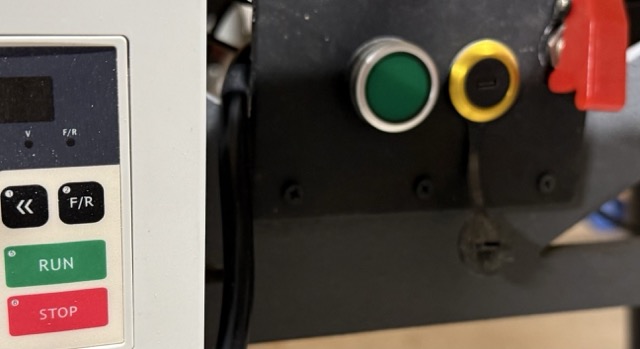

I just added an access point in the garage, and admittedly I haven’t tried it since then. But I just engineered a permanent USB-C to microUSB cable into my table and added an (automotive) jack to the side. It’s not plugged into the computer for most things, but when I need it I just plug into the side of the table. (I’m on Mac so USB-C made the most sense.)

For the original posters benefit if you want to have a USB cable permanently connecting to your jackpot from a PC there’s something you need to be aware of.
You have to power up the jackpot BEFORE connecting it into your computer or use a data only USB cable.

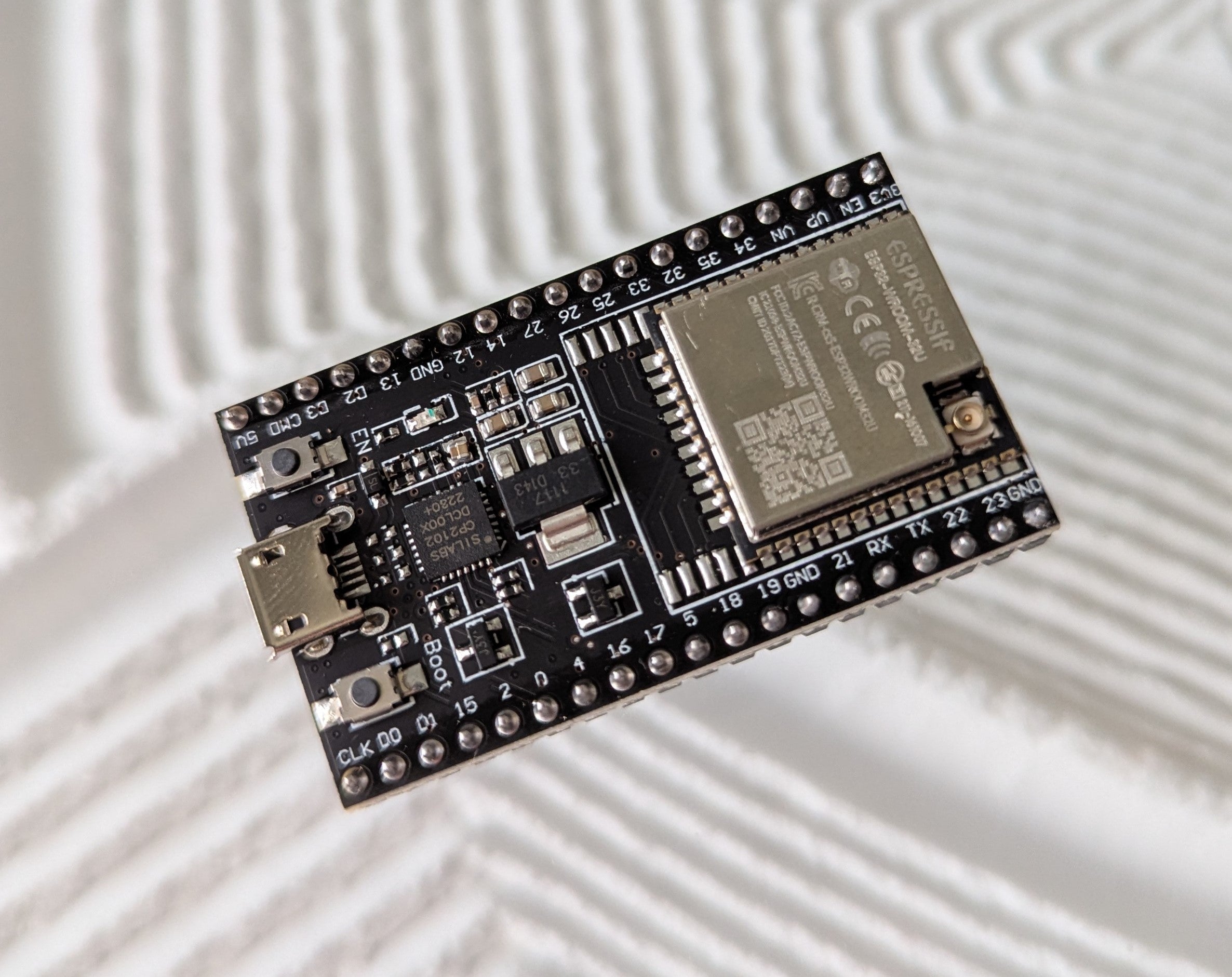

Note that you can get ESP32 boards with an external antenna connection (note that these are small and quite dellicate) which should help with connection strength.
This is one on the V1 store without the antenna that you will also need to source.
Those connectors are called ‘IPX’ and you can get fly leads to convert them to SMA which is your standard WiFi antennas. With that you can have a good antenna mounted on the outside of your control box
But I’d emphasise as well how extremely delicate IPX connectors are.

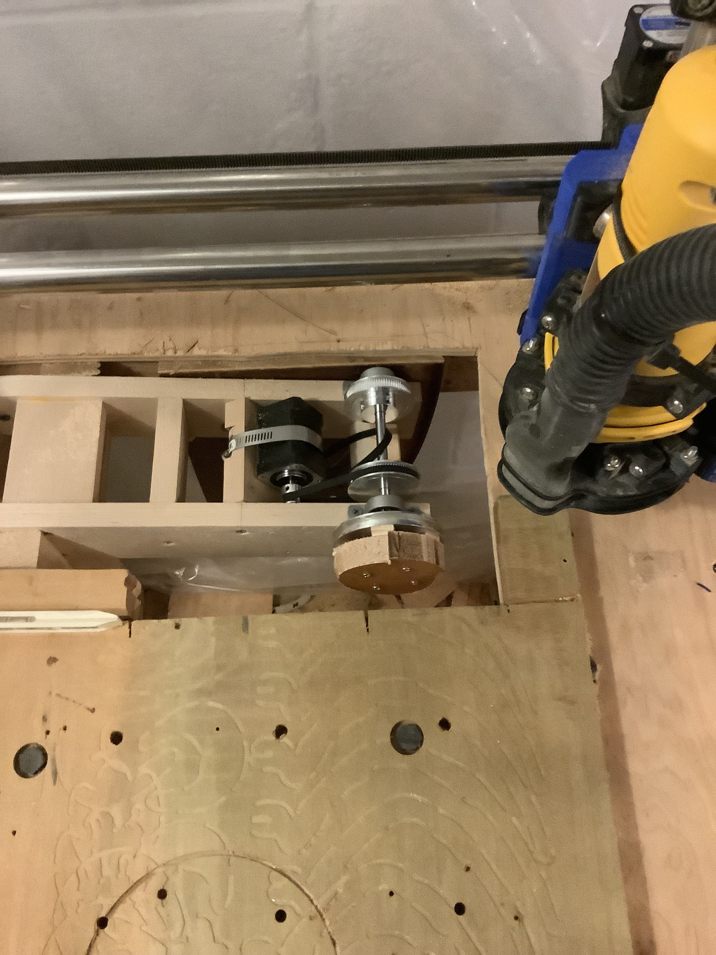

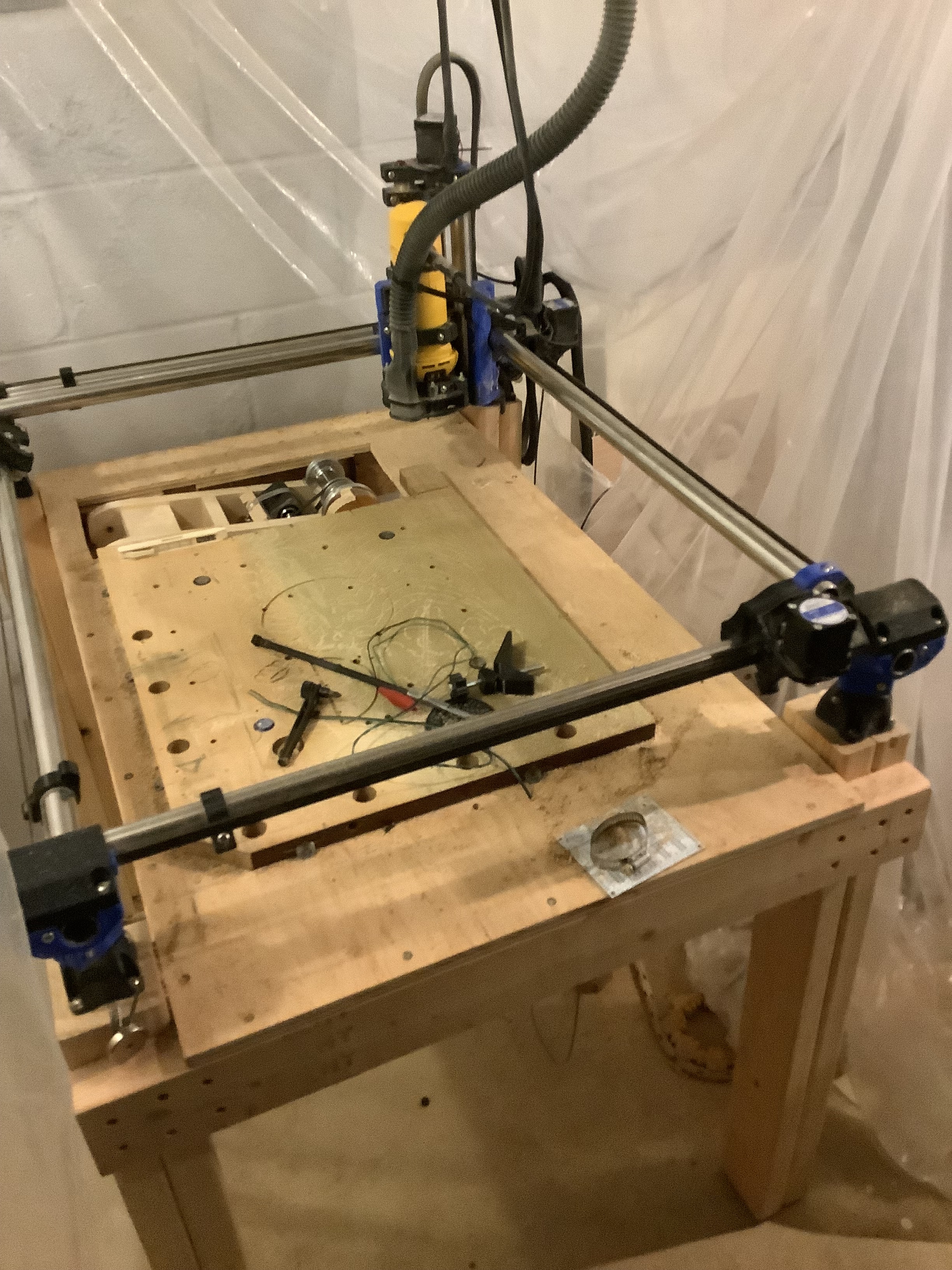

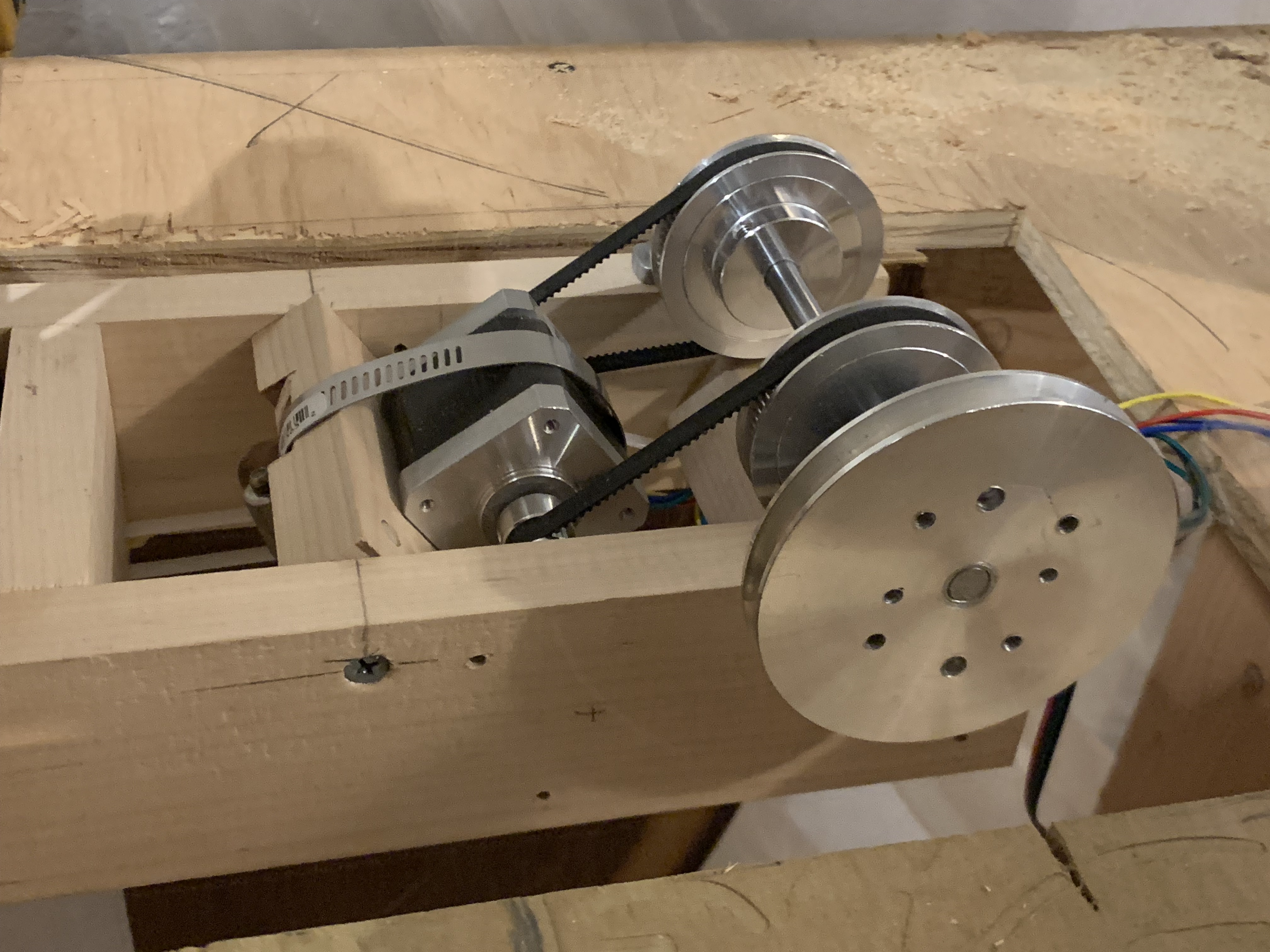

I have set up my primo mpcnc with a rotary axis. I use the last driver on the Jackpot board for a simple belt driven “plate”. I don’t use a chuck.
I can jog all 4 axes at any time, but I don’t have software that is truly 4 axis. I use V-carve pro for rotary work I position my X at the axis of rotation and then the V-carve rotary job moves A,Y,Z.
It’s set up to make edge design on small pucks that bolt onto the rotating plate. I first cut blanks with a flat XY job. Then I mount my “ hockey puck” onto the plate for rotation cuts of the edge shape and engraving This works well for hardwood.
If I want to work in a larger size range I can pivot the whole rotary drive lower. At some point I would probably have issues with the stepper not holding against the greater leverage with a larger radius but I haven’t tried that.
This would all be clearer with a few pictures. I’ll add some tomorrow.
The last one shows the double end shaft motor I tried originally. It was electrically defective so I used a single shaft motor and it seems fine.
Happy to share config files etc.
