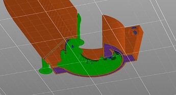

Printing - I’d definitely use a brim, I don’t like the thought of all those supports, but I’ve had a lot of luck with organics. If it doesn’t break away cleanly enough, I’ll insert a removable “plug” which should do the trick. The top of the indent for the bottom tool mount might get a bit ragged as I haven’t filleted it! Will do better.

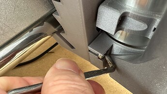

The left hand screw hole is now a slot. Fit the screw, slide the base on and tighten the other one. I don’t think a little ratchet phillips will fit in the space - but a cut down hex key should. I’m trying to avoid @vicious1 Ryan’s “hole through the whole shooting match” approach as I don’t have a snap on cover yet.

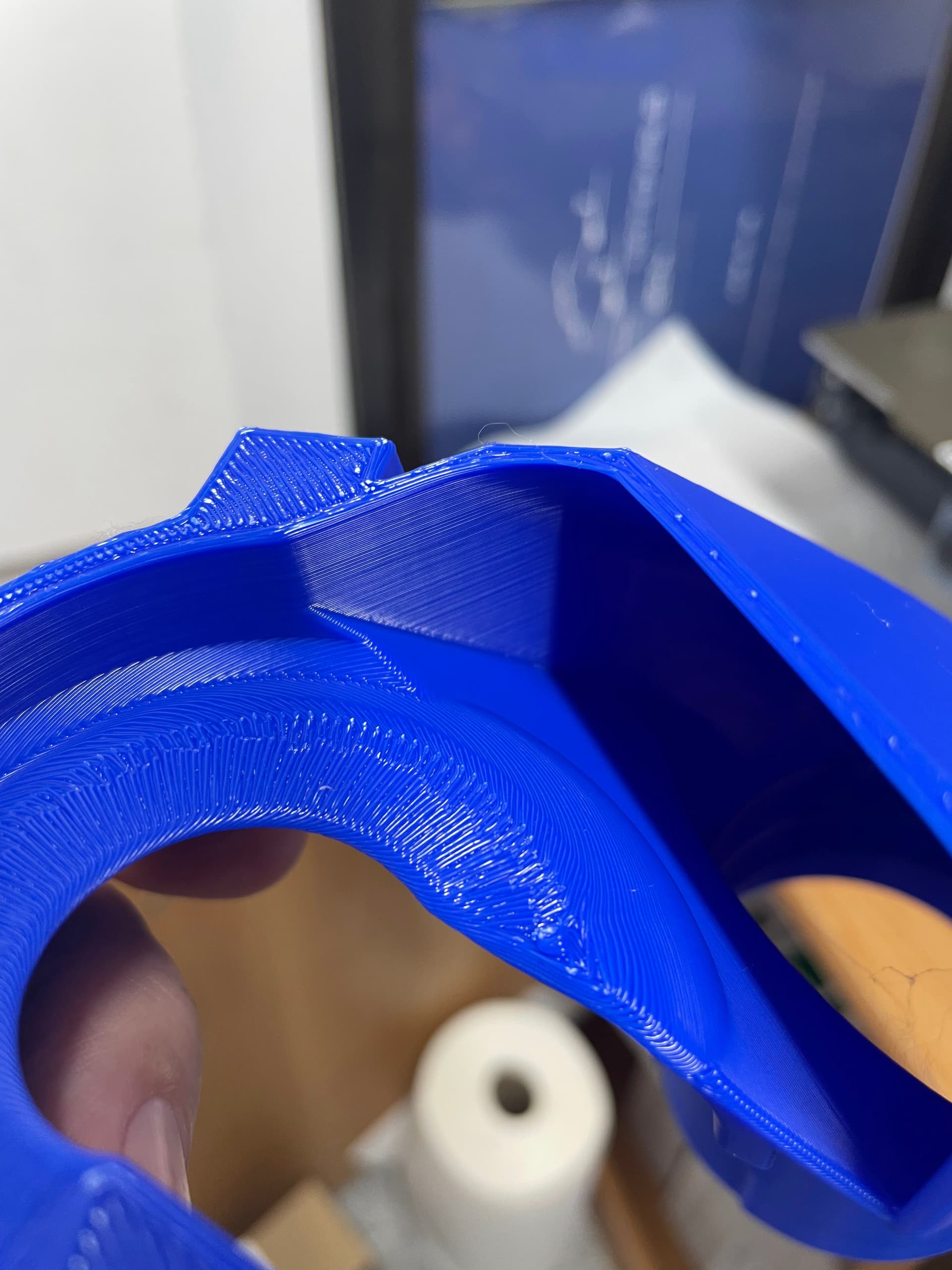

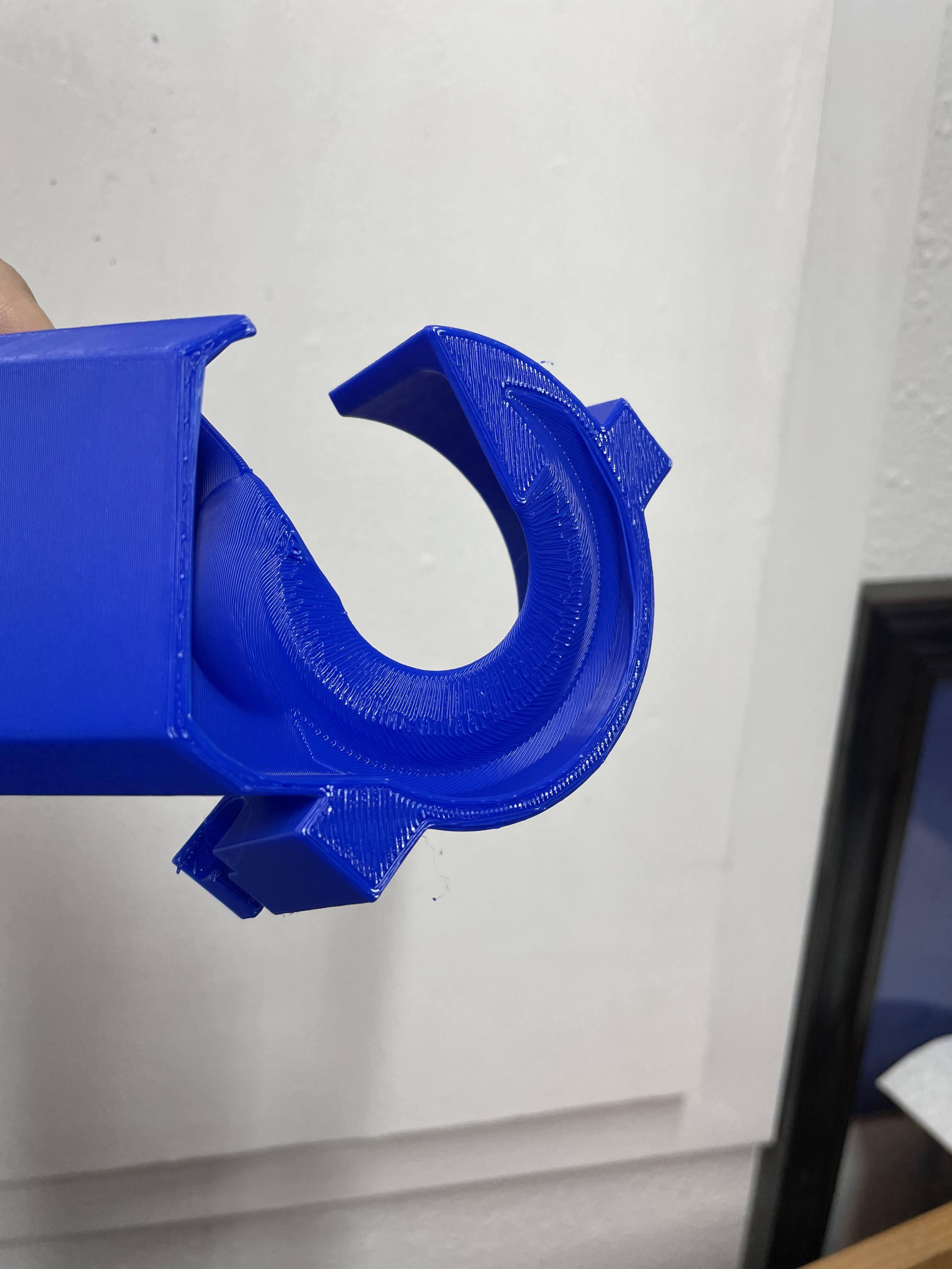

Here are the pictures of the cuff:

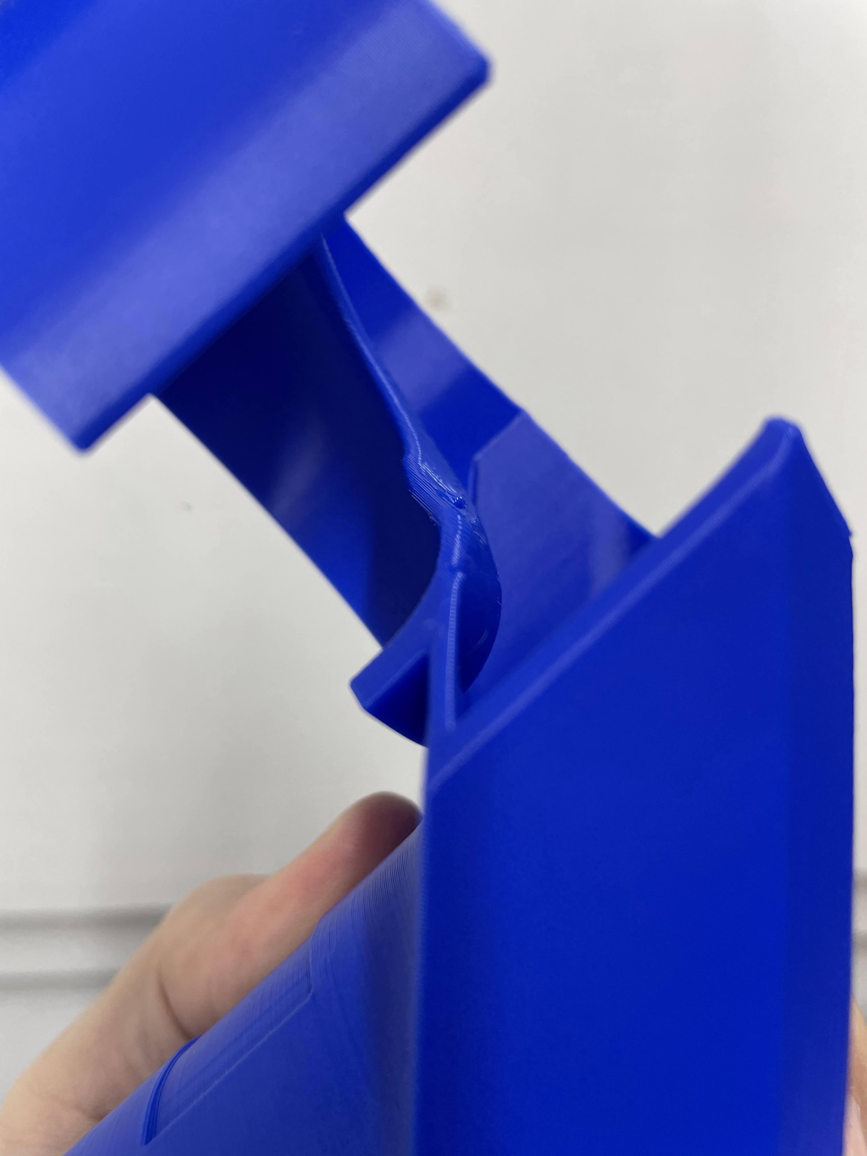

This one shows a bit of a kink in the transition.

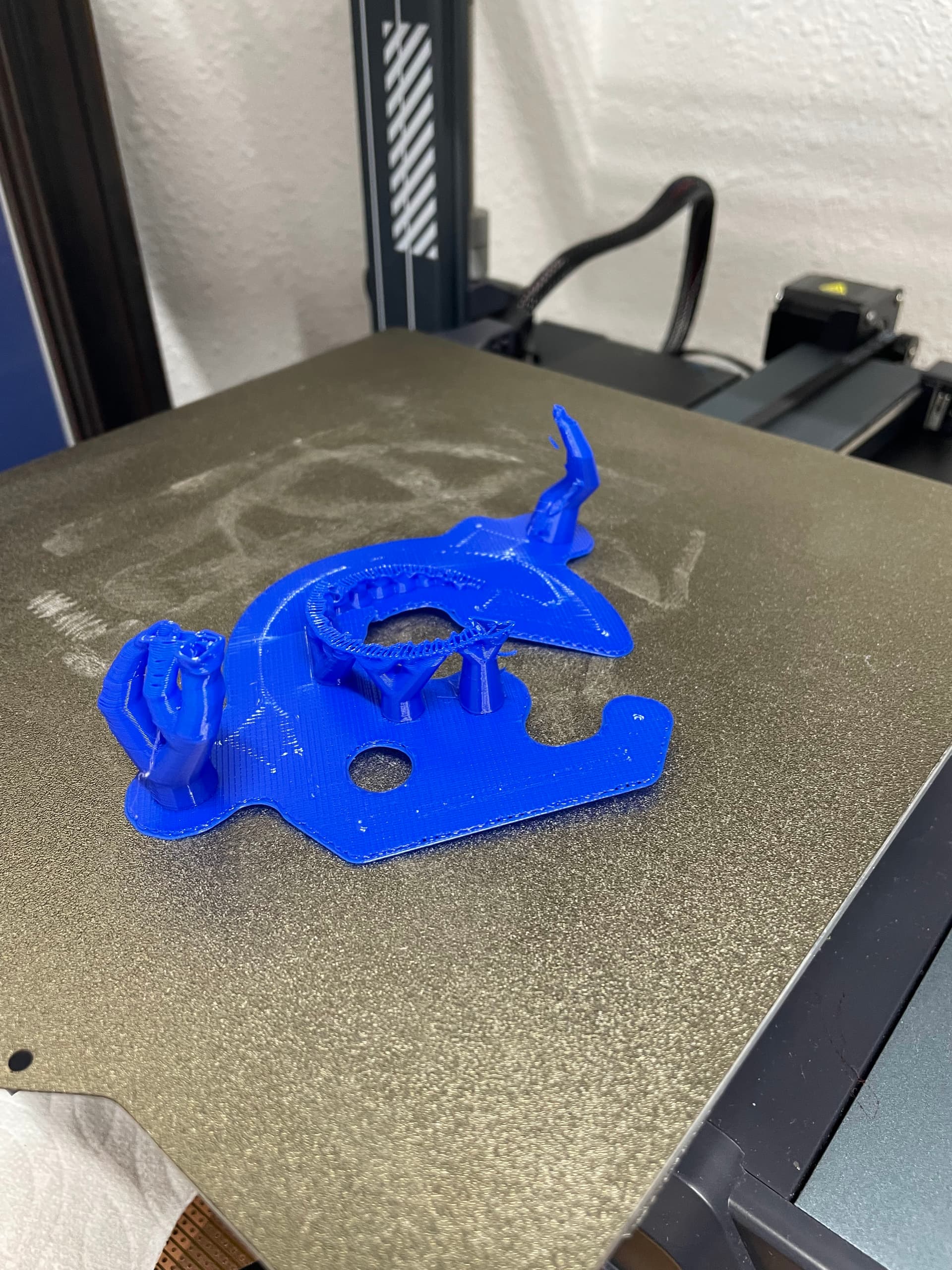

I printed on a raft with tree supports (Cura 5.4). Here is the raft and support structure. It came off pretty cleanly.

Holy dooley!!
Thanks so much for that, the ink isn’t even dry on the drawing yet!!
The kink is a little odd - but won’t affect anything for the moment. Now the test! It looks as though it might work - but it might need tape over the gap… I’m a bit nervous, and it’s bed time! :open_mouth:

I printed off your design, and although the hose size is the same as mine, the thread is the wrong way round. Left hand instead of right hand. Don’t know if this is a US/UK thing.

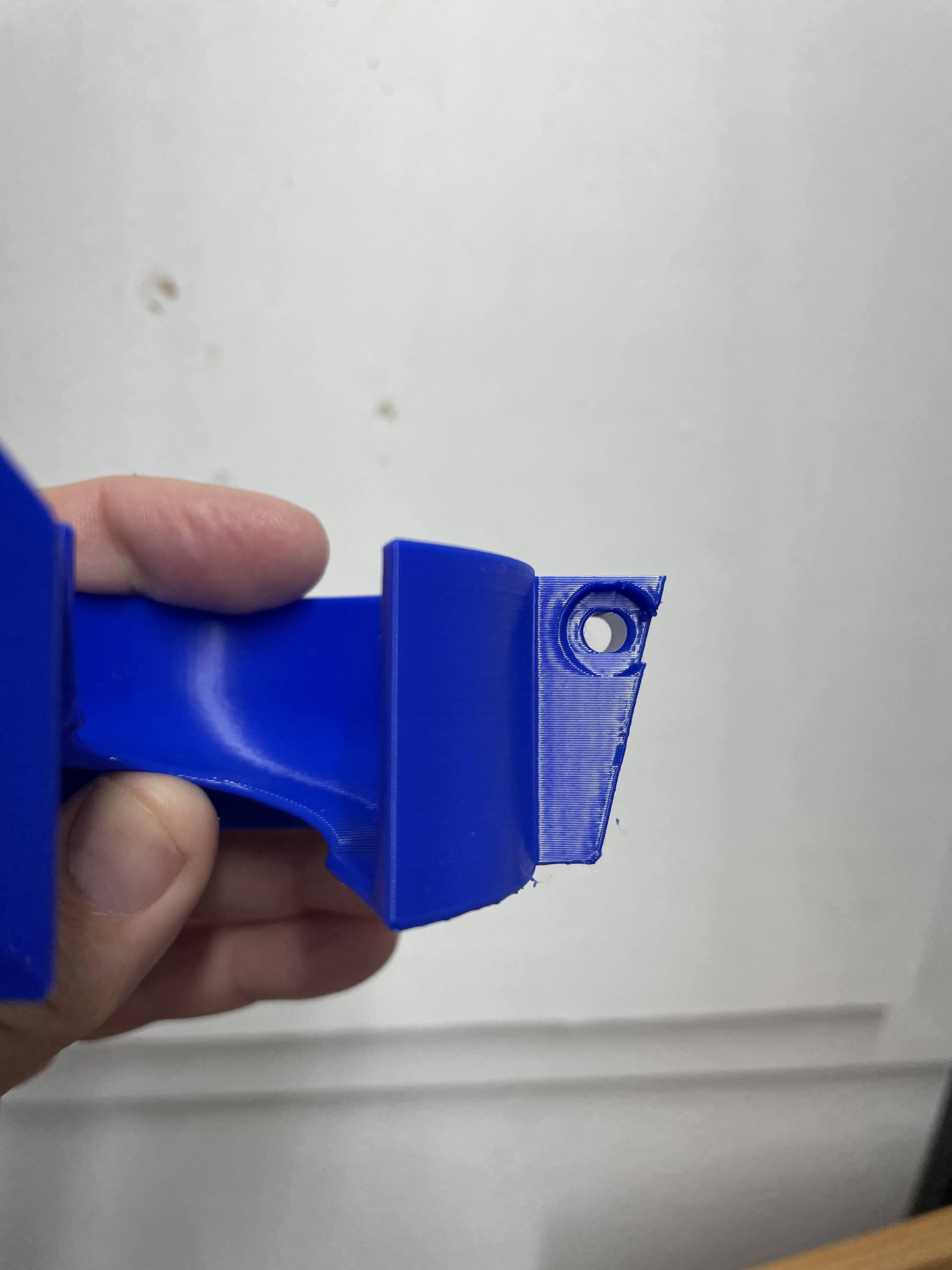

If nothing else it looks great. It really works well with @Ryan 's parts if I do say so myself. There’s no need for the zipties on the tool mounts, but I will add the top one and a bit of geometry to tidy that up.
I did not make the inner diameter small enough to act as a stop, so will fix that in the next iteration - some additional thickativity won’t hurt when I get on with my cunning skirt plan.
Of course we don’t know how it cools the Makita or picks up dust, but it’s a great ornament for now. :rofl: :rofl:
The screw worked out better than I feared it might. I had used a little epoxy to retain the nut for this purpose (not enough as I broke it free, but not to worry). Then I realised my bendy screw driver was not a Phillips but it did the job admirably - I’d got the screw into almost its final position first and it only took half a turn to snug it up.
The spanner is not a problem on the collet either - a little more awkward, and can only be turned half to quarter of a turn but it works well enough so that if the part works as planned it won’t be an imposition.
