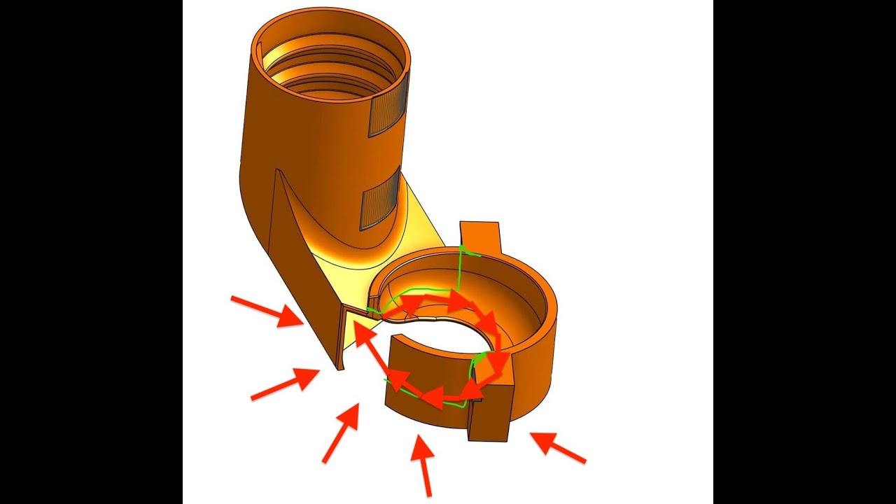

Some more LR3 Makita mount musings
Actually not sure that’s true. :sweat_smile:

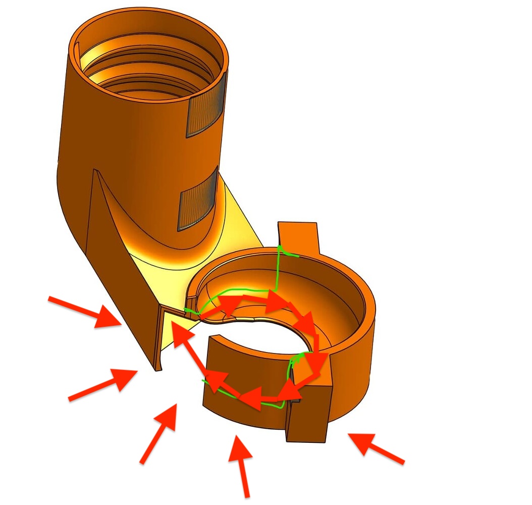

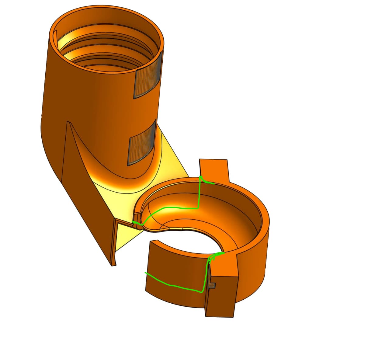

If you cut away these green sections, will it help increase router airflow, and not compromise your design?
The only way to find out is to test (in the absence of the desire to learn to use some CFD analysis tools) is to build one. If anyone wants to take a deep dive please be my guest! (I assume things have moved a long way in the last four years!)
My hope is that the exhaust from the fan will miraculously accelerate and choof into the vac inlet, creating negative pressure and therefore assisting vacuum - rather than working against it.
I’ve always been captivated at how a tiny change on an F1 car can make a massive difference in cooling or downforce, but without any maths ability have no way of making this work - I’m pretty sure even the basic inputs for a CFD simulation are well beyond me. On the other hand, I’ve worked with enough mech engineers in my life to at least understand some of the theory - but I’m not sure that I’m any where near correct here.
If any of the engineering brains here would like to work with me on this I would seriously enjoy that - we could then compare what is happening between various designs perhaps.
I have considered cutting the “top” as shown, but not the bottom - The top is the “stock V1e” (your) design depth - the bottom of the cyclone is slightly deeper than the Makita Router mount when at it’s lowest setting.
If this pans out (IF) I have a concept for a snap-in TPU “door” over that opening which incorporates a skirt around the circular base.
I suspect at the end of the day, we won’t be able to show any difference from the stock fitting - I will do some basic small particle measurements as that’s my main objective - to keep the air cleaner (and have a cooler router for some).
