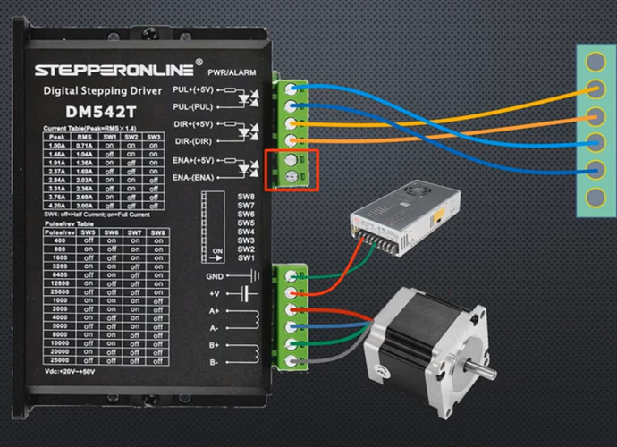

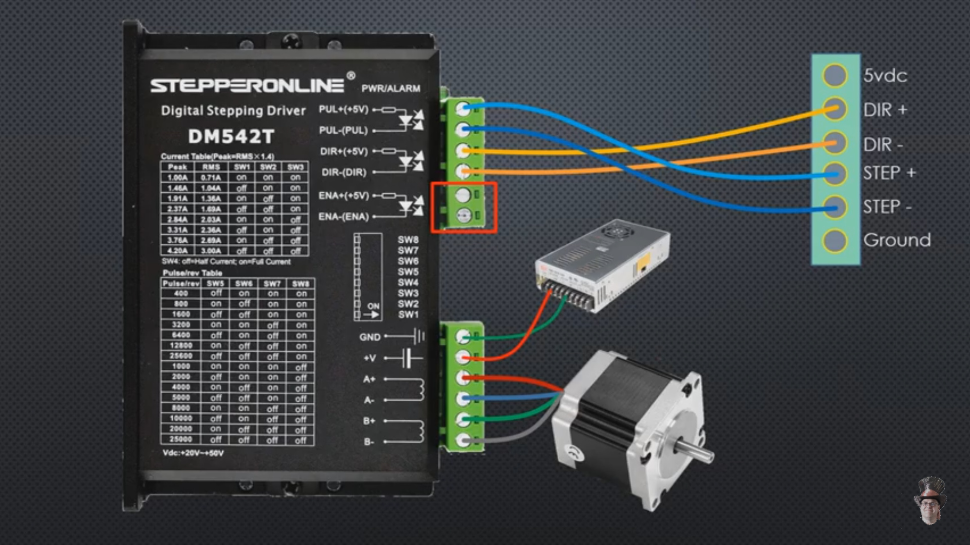

I’ve tried to reverse engineer your wiring connections based on that photo. Assuming your tb6600 headers are in the same orientation as mine it looks like you simply wire Dir- from the mesa directly to Dir- on the driver, Dir+ to Dir+, Pul- to Step-, and finally Pul+ to Step+?
No need for limiting resisters or jumpers anywhere? The enable signal ports are meant to be left empty?
I’ve seen conflicting information flipping through what docs I’ve found online… No need to worry about this common-anode active low active high business?
That’s correct, no need for anything extra on the 7i76.
I left the enable pins empty and the steppers power up as soon as the rest of the electronics are turned on. In the future I’ll probably wire it to a separately controlled pin so I can turn the drivers off. The motors do get quite warm/hot after they’ve been on for some time. And my current setting was set appropriately for my steppers
