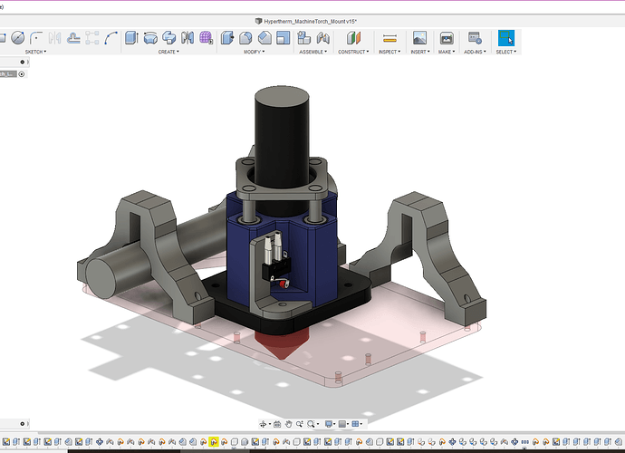

I do not recommend using that torch mount without heavy modification. I initially had my torch mount off the side of the plate and there was a ton of bending and twisting as a result. No amount of reinforcement would prevent it because it is cantilevered off the side. Just recently I designed a new torch mount for my machine torch using the center mounting location. Video of new torch mount: https://photos.app.goo.gl/ioZZzyQRcqQXKUMZ8
It uses 8mm smooth rod with LM8UU bearings (8) pressed in. On one of the 8mm rods that sticks above, I have a spring to help return the torch back down. I may need to add a second spring, but 4 would have been too stiff I think.
I’m still testing the design out and it seems to be working very well. Thingiverse (WIP) link: https://www.thingiverse.com/thing:3635521
If you have a hand torch, you’d have to modify the center carriage, but 100% mount the torch from the center of the 611 plate, not the end.
I’m only using a floating Z, but am interested in wiring up the ohmic sensing with a float switch backup. I mostly cut 16ga sheets, so there can be a lot of flex which messes up the initial height sensing (IHS). Yes, water can interfere with the ohmic sensing, but my air is usually always flowing after the first cut and displaces the water right below where it’s going to pierce next so I don’t think it will be a big problem.
[attachment file=“100727”]
I was editing my previous post when you replied. Already ahead of you on moving that mount to the center of the plate :wink:
Your new torch mount looks good. I’ll look forward to the upload.
[edit] interesting design! it’s got me thinking. Could you get away with 3 bearings/rods instead of 4? In an equilateral triangle pattern and oriented such that one side is open to allow mounting a hand torch…
Yes, probably. Two rods were good on the previous direction in the X direction, but provided no support in the Y direction. I initially tried 3 evenly spaced at 60 degrees, but it interfered with the 4 bolt pattern for the bottom of the baseplate. I’m sure you could make a new carriage for a hand torch. I only have the machine torch for my machine so I can’t try anything else.
I mentioned it in the Thingiverse post but it is a work in progress. I printed it once and then sanded a few things to fit and drilled out the holes in the base plate a little bit to accept the 8mm rod. I’ll go back eventually and fix these and reupload, just be aware for now.

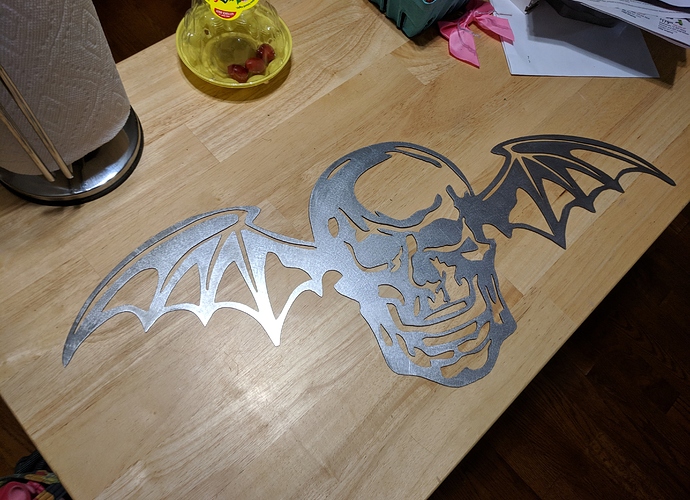

It only took me a few failed cuts due to warpage with my initial GRBL setup to switch to something with a THC.
[attachment file=100810]
This is a file that I attempted to cut with my old system and it was too complex and warped too much on small areas that the torch would stop cutting through. I cut this the other night (16ga, cold rolled steel; roughly 24" wide) and it was absolutely flawless. Virtually zero cut angularity an no warpage (thanks to water table) and it was cut at 250 ipm! Dross on the backside was minimal and easily taken care of with a needle scaler.
That looks awesome! Still using the nema 17’s @ 24v with TB6600?
(trying to gauge what kind of speeds I’ll be able to get)
That’s correct. I can jog around at 300 ipm, too much more and it will skip steps. However that’s more than enough. I think they are 84 Oz-in nema 17s.
