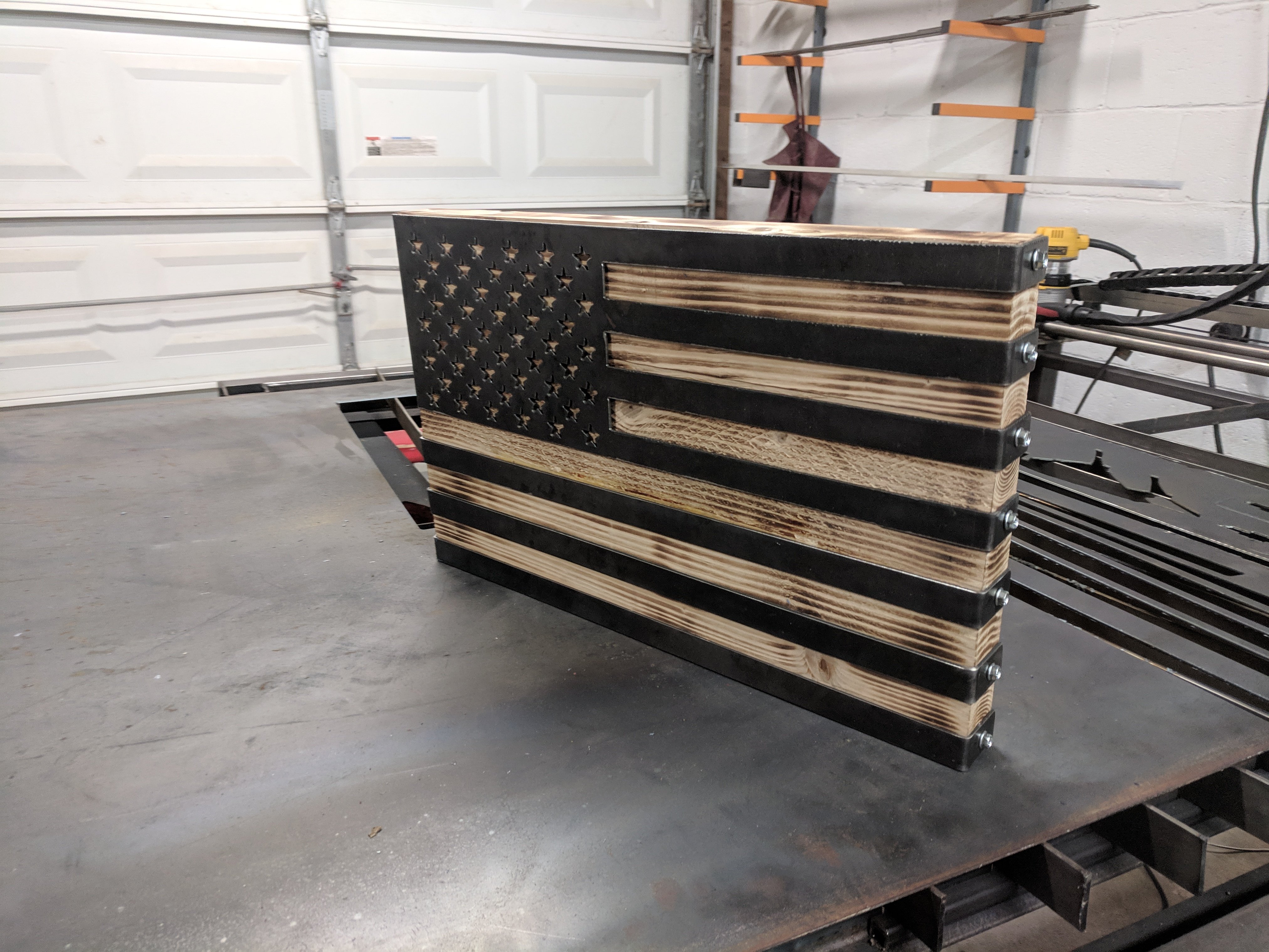

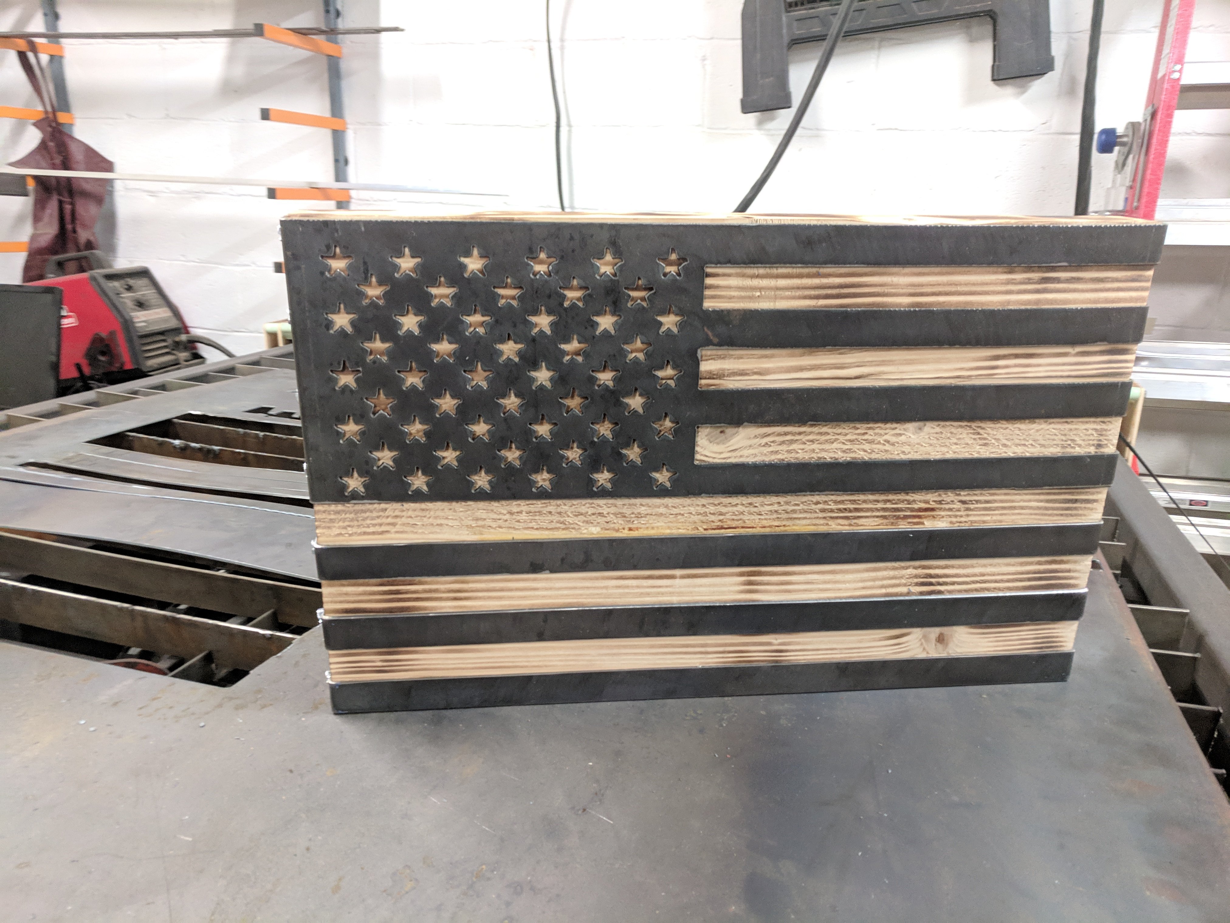

First real project: 14ga steel and burned wood flag, roughly 22"x14"
Learned a lot about piercing (59 pierces on the main piece) and poor quality consumables that don’t last long at all. Bending the steel took quite a while. My FIL helped me bend the wide portion with a hydraulic press and bending die, but I bent the lower strips by myself (my own press is on the way!)
I also am working on a shinier version where I stripped the mill scale in muriatic acid (HCl) and grinded it with a flap disc. Should be finished with that one this week.
I started this build over the summer with intentions of making a few things in support of a craft fair which is this Saturday, so I’d say my planning is quite superb.
Source for the flag dxf, and lots of other plasma projects: http://www.langmuirsystems.com/fireshare/rustic-usa-flag
