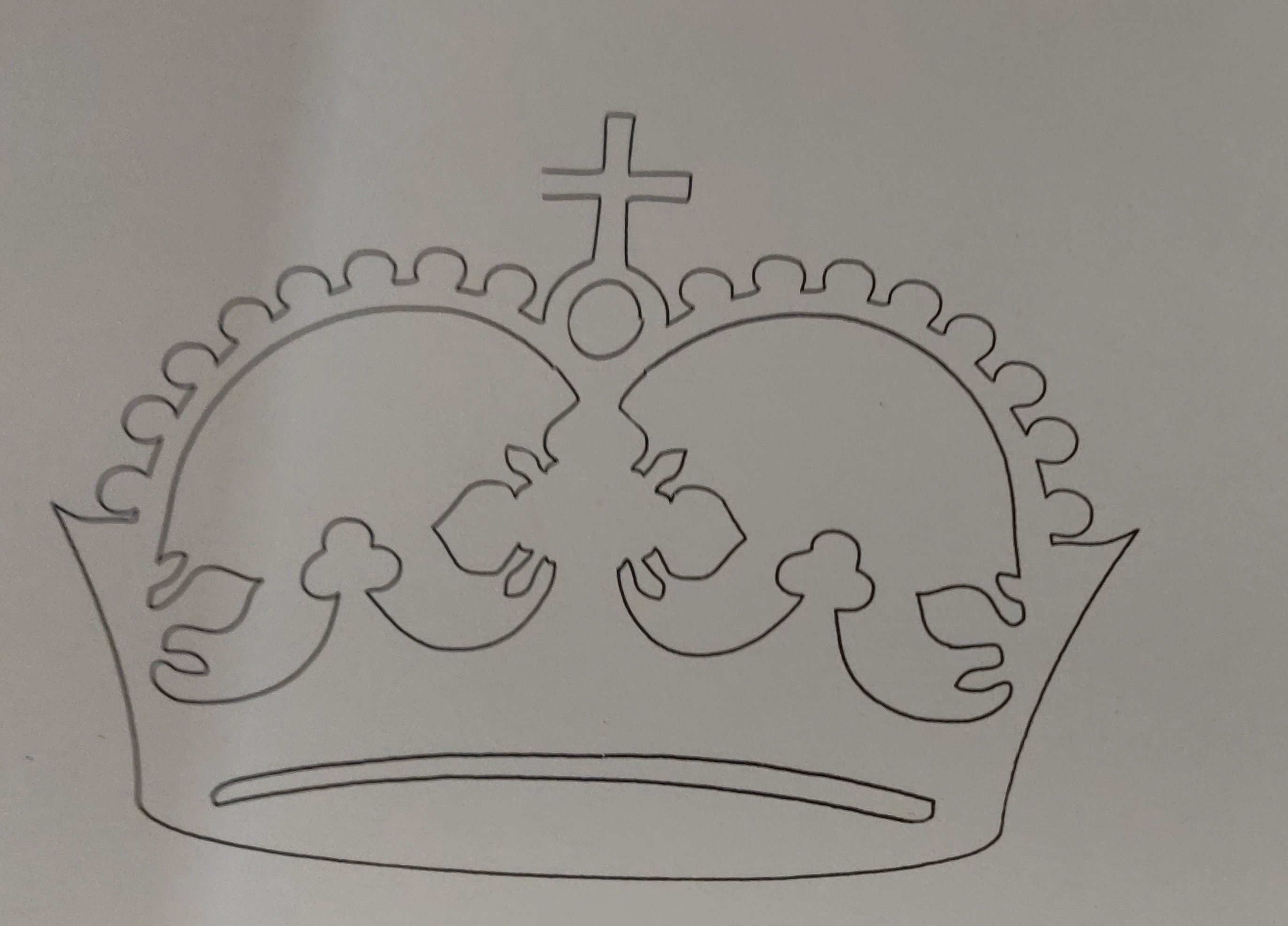

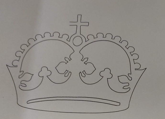

Will, I got it to print in the most convoluted way possible. I connected Repetier without 12V power then used my variable bench power supply to carefully step up the voltage to see if I could get both Repetier and RAMPS working at the same time. Around 8V and everything was still working. I then used Repetier to load the crown file on the SD card and then chose “Print from SD” from Marlin, even though it couldn’t see the SD when Repetier wasn’t connected.
And, umm. It actually printed. There’s a little bit of distortion at the start, but I’m guessing that’s just the pen settling, since everything else is fine. Power draw was very constant at almost exactly 3A. So now I just have to figure out why everything gets so upset when the voltage gets too high.
